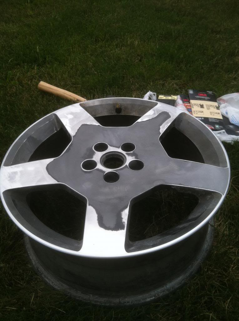

Well so I started the unthinkable and decided to try polishing my old ss/sc rims. The clear on them started going years ago and so they looked like crap. I decided to start with 80 grit due to this so. I'll keep updating as I go but this is start to about 1/2 done with first step. Still need to do the inside and some corner spots. To this point took about hour and a half to 2 hours with a electric hand sander.

Starting with 80 grit? holy hell you're going to have one of of a time sanding them scratchs out.

yea i figured i would but i cant imagine how long it would take with 400 or something when it took this long to remove with just 80. any way to speed up the removal phase without getting into lots of chemicals?

Why are you sanding!? Just get a $30 can of paint stripper.

Best thing to remove paint. Klean-Strip QAR343 Aircraft Paint Remover
Buy 2 quarts of it to be safe and buy some foam brushes or other brushes. Well worth it and it saves some serious time!

Because in a noob I guess haha. I'll remember that for the others. So use that strip paint then sand?

Ya strip the paint with the stripper. If there's any imperfections or machining marks, sand them out.

Ok I ordered some. Then just start sanding at a 400 and go up to 1500 or so? Then polish?

Ya. Depending if there is machining marks or not you could just start at 1000 grit and work your way up to 200-2500. That's your choice really.

So basically I sanded for no reason? I just strip sand with High grit then polish with metal polishing compound and I'm good? Want that mirror chrome like finish

Haha. Yep. Just as long as I said there isn't a ton of machining marks.

Yes lol.. It's messy stuff but you will thank me when you see how much easier it is.

You do really but it all depends on what condition of the rims to decide what grit to start with. If they aren't at all bad you can start at a fine grit like 1000 or so and work up. It they have marks or you wanna get rid of the machining wrinkles you gotta start lower.

Lower the grit, deeper the cut. It also is harder to get out. Just means more work in the long but with a lower grit you get more imperfections out and in the end it will be super smooth just as long as its done right.
Once you get to a higher grit, rinse it off and then just use a polishing pad or ball and polish them up! Get your shine on!
