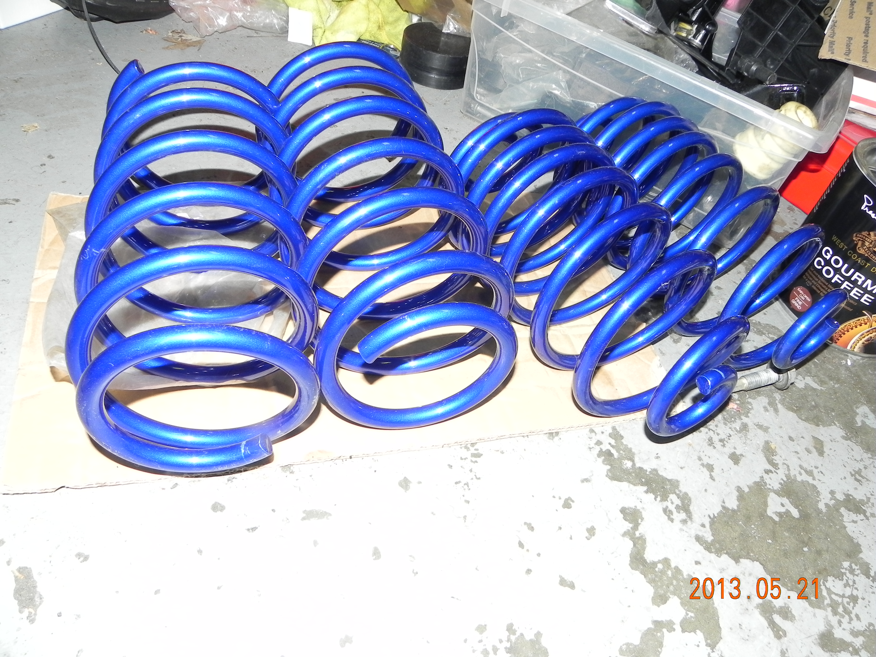

The only difference is the coils at the end of the rear springs. When you remove the stock springs they are tight on the mounts/isolators. The V2 end coil is alot larger and the springs drop right in. This is the version I have and was kinda surprised how loose they were when installed, but with the vehicle weight on them it's no big deal. The V3 end coil, from what I've heard, is much tighter like the stock springs. Other than that there is literally no difference. Just the springs, rear sway bar, and good tires will make a noticeable difference.

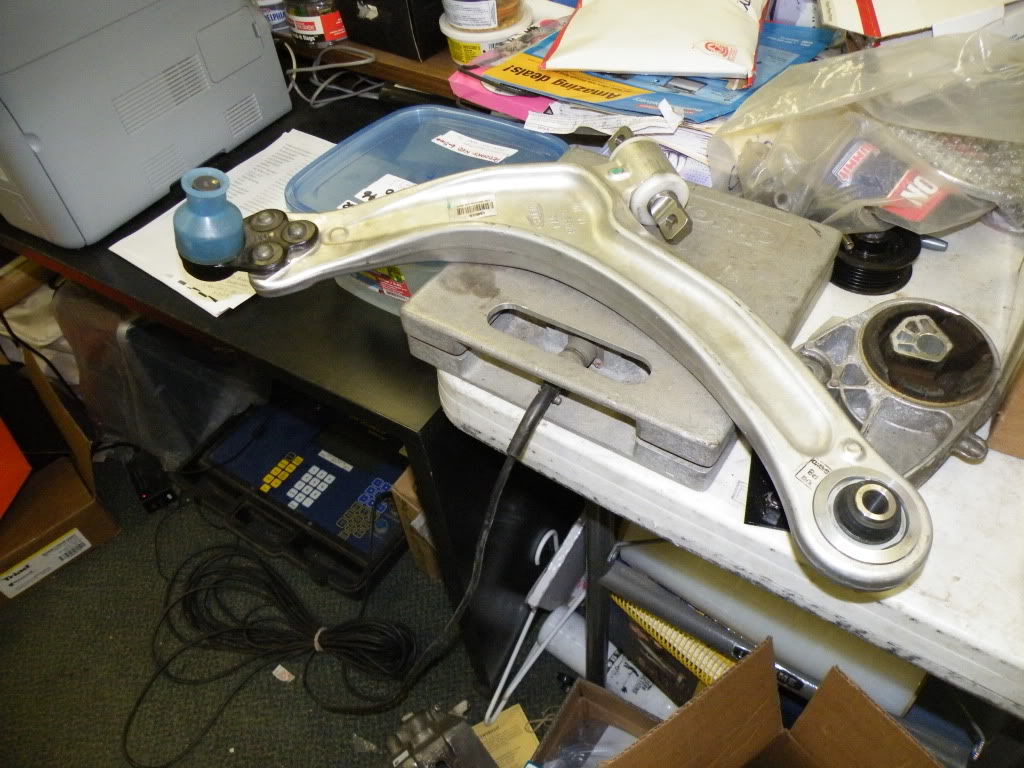

glad you asked. lifetime warranty. fixes everything even the common cold.
CAB you need is in foreground of picture.

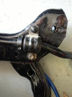

then there are sway bar clamps to stop the bar from moving out of place

YYZ springs v.1
