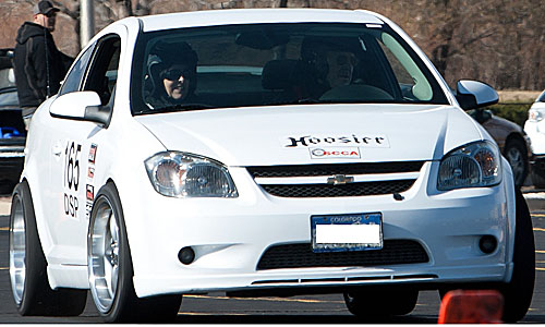

I'm a bit cheaper, I use 4 custom wheel adapters, 25mm thick, hub-centric on both sides, with a 5X110 pattern on the hub and a 5X114.3 (5x4.5") pattern on the wheel side. I run AMR Torque Thrust M 10" wide wheels with a +45mm offset. The wheel/tires clear on the inside by about 3/8". I use camber plates to the camber tire-strut clearance stays constant. I did have to make judicious use of a small hammer to bend ther inner wheel wells up a bit.
I've added a photo with 285s on the car.
