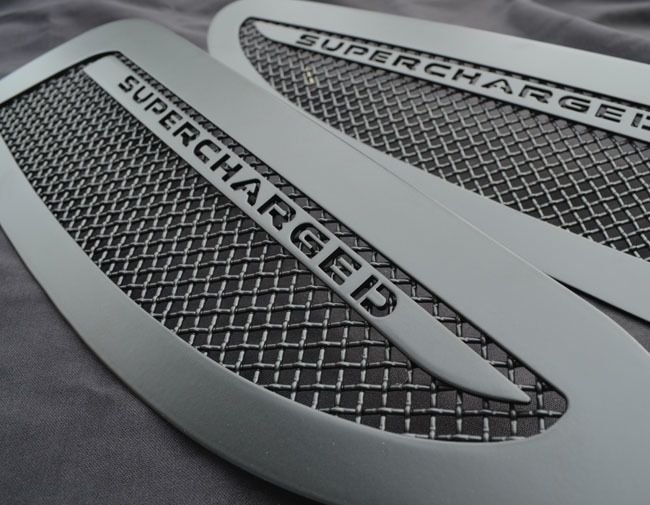

Originally Posted by Snail_SS
Adrian you have some pics of the louvers?
Here's a picture of the setup I'm doing on one of Powell's customer's Cobalt. Love that carbon hood <3

Originally Posted by HGT
I'm guessing something like these... Although they are about as rare as they get these days.
#10225885 - Left Side Louver - $40.99
#10230097 - Left Side Drip Pan - $8.06
#10225886 - Right Side Louver - $40.99
#10230098 - Right Side Drip Pan - $8.06
This is them exactly. Mine are even white (unpainted)

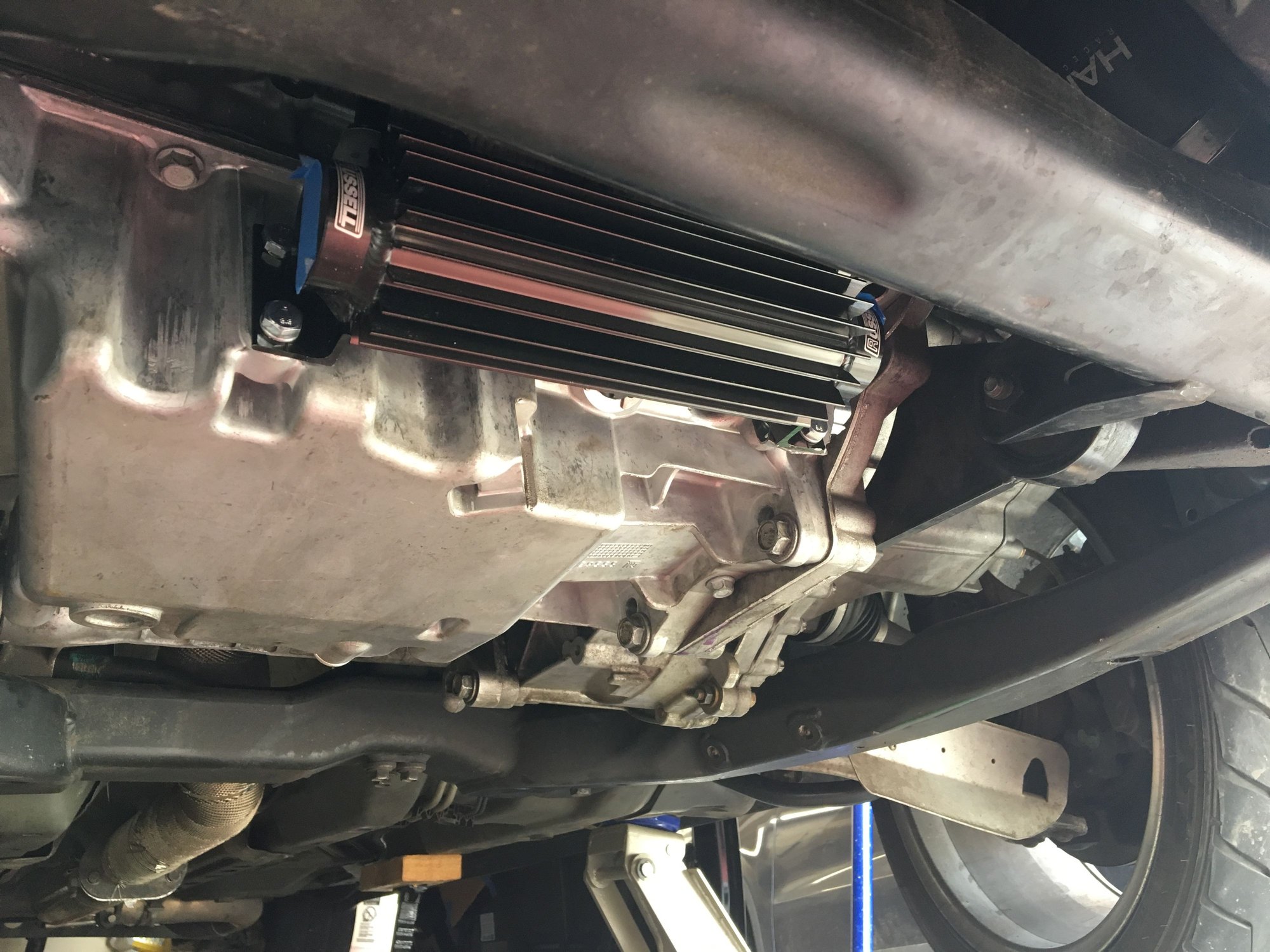

A little update. Believe it or not I've been having trouble getting paint to stick to the plastic vents so no finished pictures of the vented hood just yet. Seriously I've painted them several times and it comes out all blotchy and horrible. Getting kinda tired of repeatedly painting and then sanding it all off again lol. Not sure why this is happening.
So to make a change, today I worked on making the brackets for the installation of the transmission cooler and the pump that will be running the system. I mounted the cooler in front of the oil pan for maximum air movement and the pump, which is humongous, in the only place it would fit, behind the engine. The bracket only has the two t-bolt claps on them in the picture. This is where the pump will be mounted. I was able to bolt both brackets into existing bolt holes in the engine/oil pan which was a bonus. I'll update when I get the rest of the system routed and installed.
Old Mar 24, 2018 | 06:59 PM

I'm a total noob when it comes to paint. I used a primer and the a gloss black. Both spray cans. Normally works fine on my taillight stuff. But I guess this is a softer plastic. I even tried adhesion promotor but that didn't make much difference. I guess I'll just ask a local Cobalt owner that is a magician with paint to do them for me. One look at the paint job he did on his own car and you'll understand why

My setup was spec'd by Powell's himself.
Only thing is he puts the pump on the sub frame. I just don't like drilling holes. Especially in the sub frame
