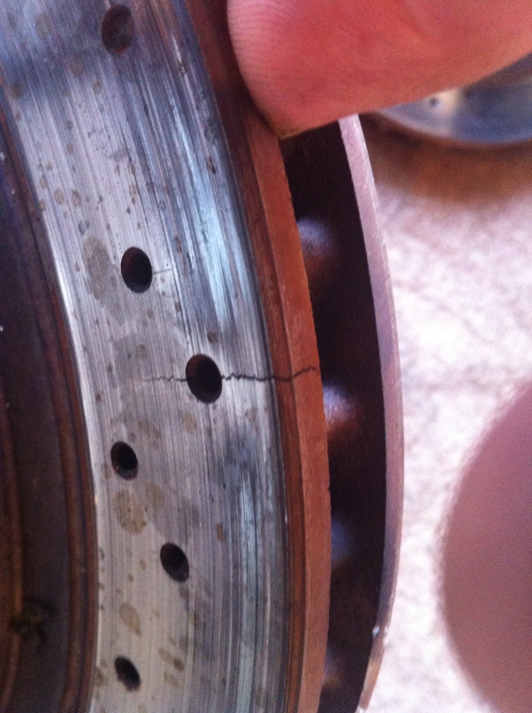

Old Sep 17, 2012 | 06:29 PM
Mark Aubele's Avatar
Joined: 03-23-10
Posts: 1,140
From: Pittsburgh, PA
This is what happens to a cross-drilled rotor after ~4 hard laps on track on a rear rotor (car came with them, thought they would be OK on the rear), on a car that is by no means underbraked (C5 Z06)...
Slotted aren't much better. Leave the drilled and slotted for the "stanced" crowd.
Old Sep 17, 2012 | 06:54 PM
Omiotek's Avatar
Joined: 07-04-10
Posts: 3,262
Likes: 66
From: Carol Stream, IL
theres nothing wrong with proper slots.... i run slotted colemans.... best rotors available for this car.
Old Sep 18, 2012 | 12:21 AM
Joined: 03-23-10
Posts: 1,140
They are pointless.
