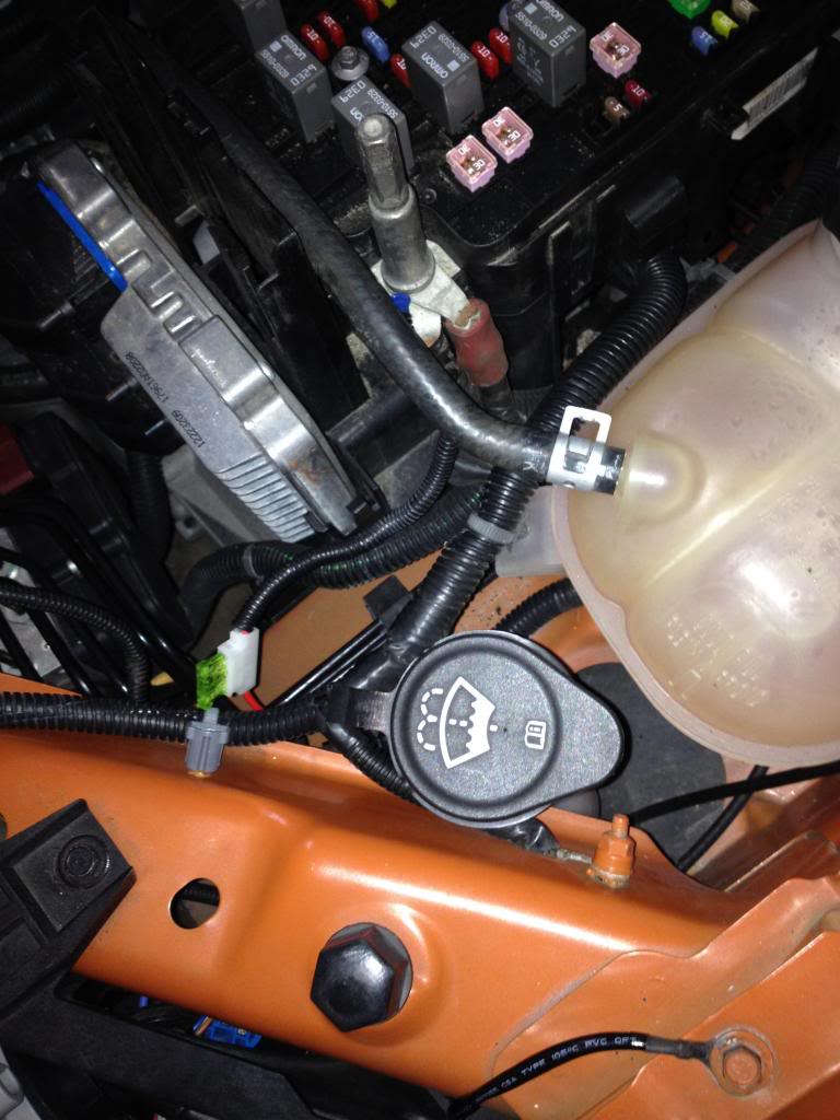

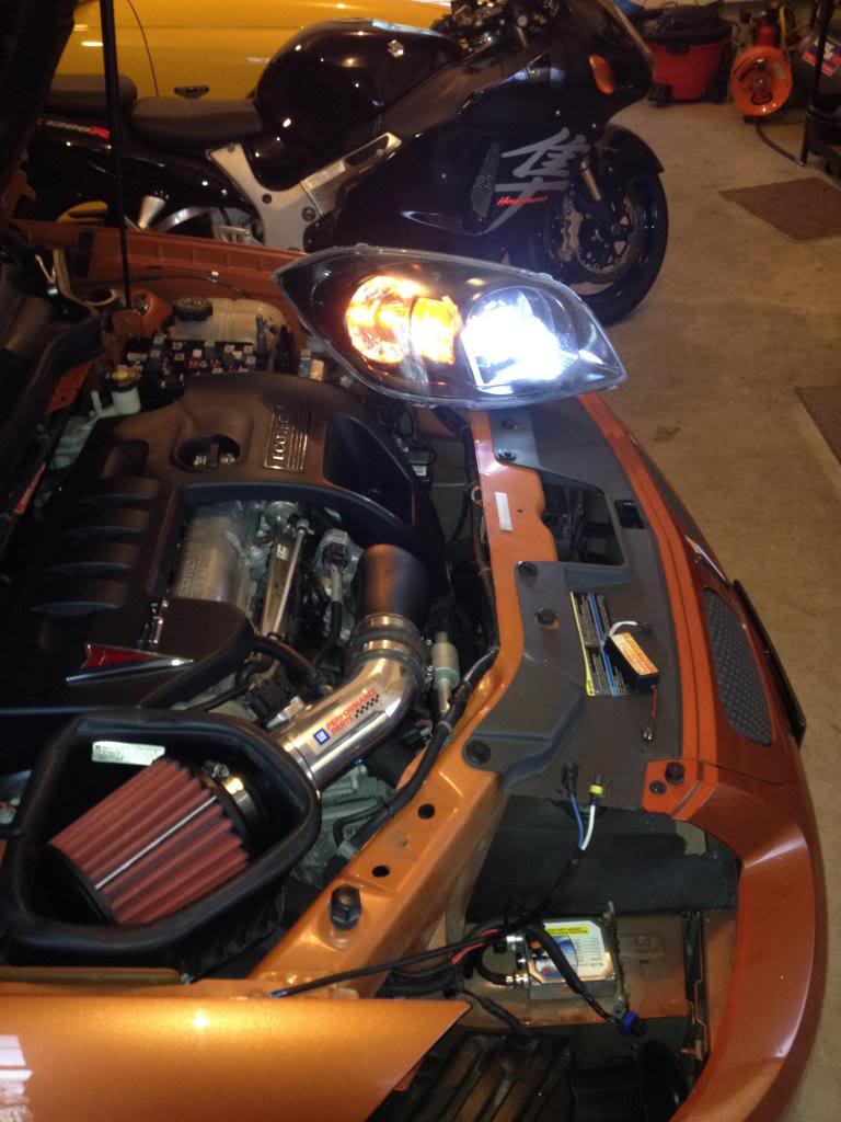

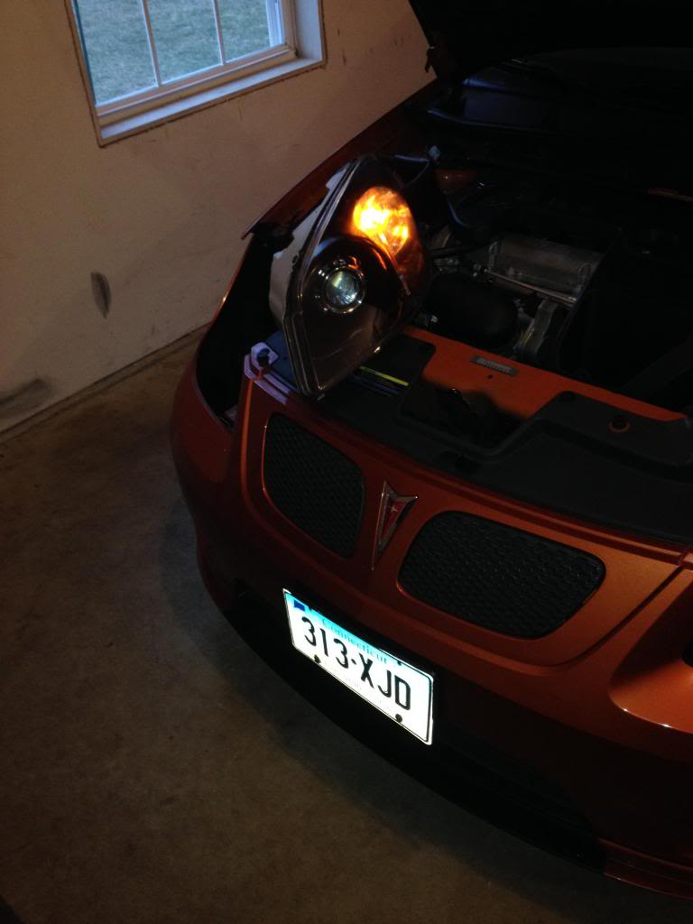

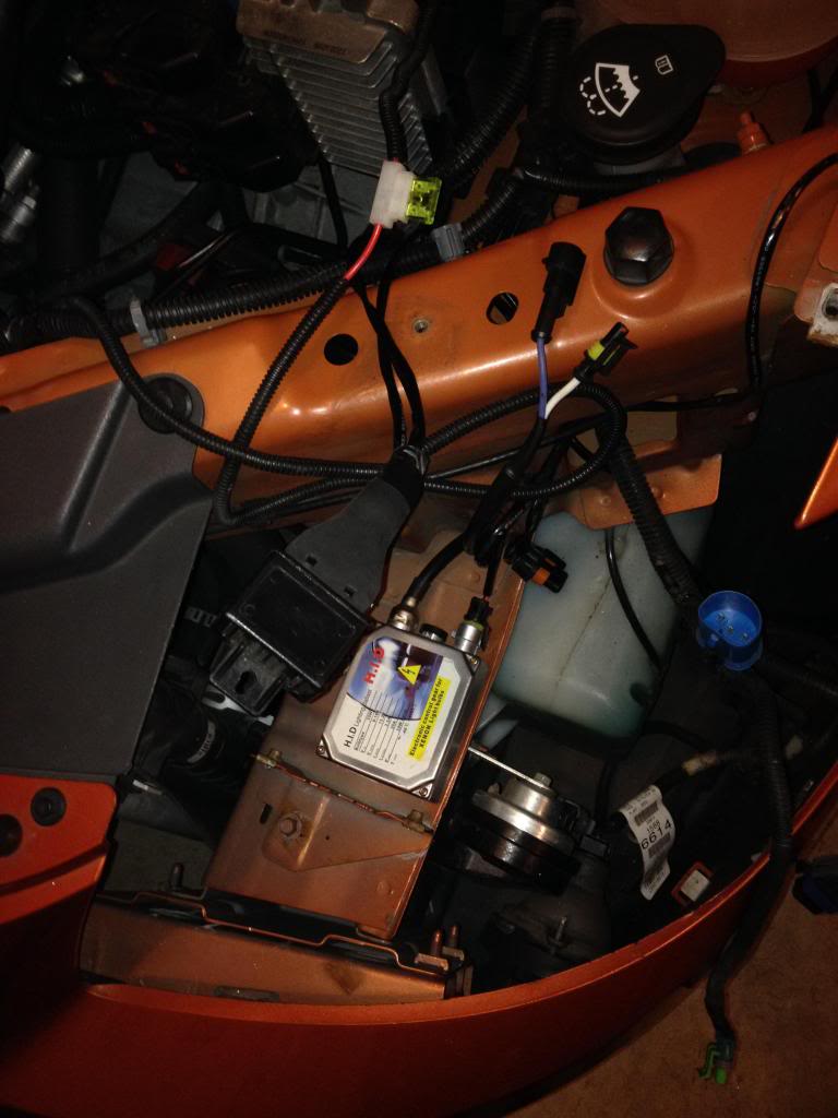

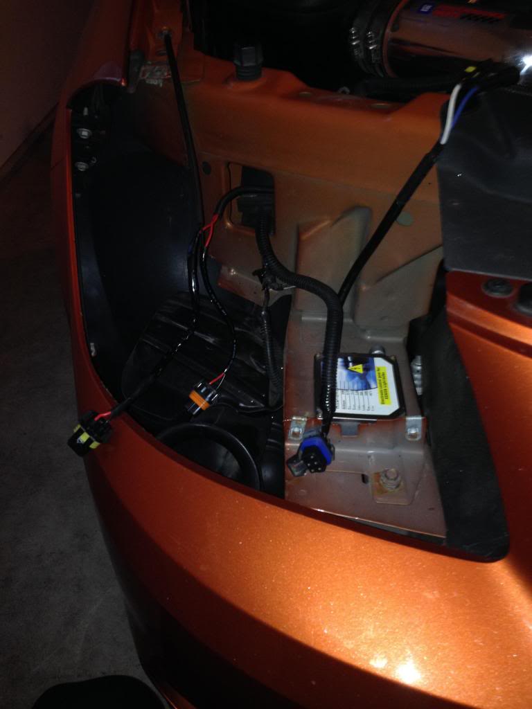

I took the drivers side head light and ballast and put it on the pass side and it did not light up.
I took the pass side headlight and ballast and put it on the drivers side and it turned on. I put the high beams on and i can here the clicking sound from under the hood and the light gets brighter.
Both eye loops are good one i replaced because it was broken.
I took pics im uploading them now.
Old Nov 29, 2013 | 04:58 PM
  #42
Bass_Waves's Avatar
iTrader: (24)
Posts: 3,147
From: NJ 07060

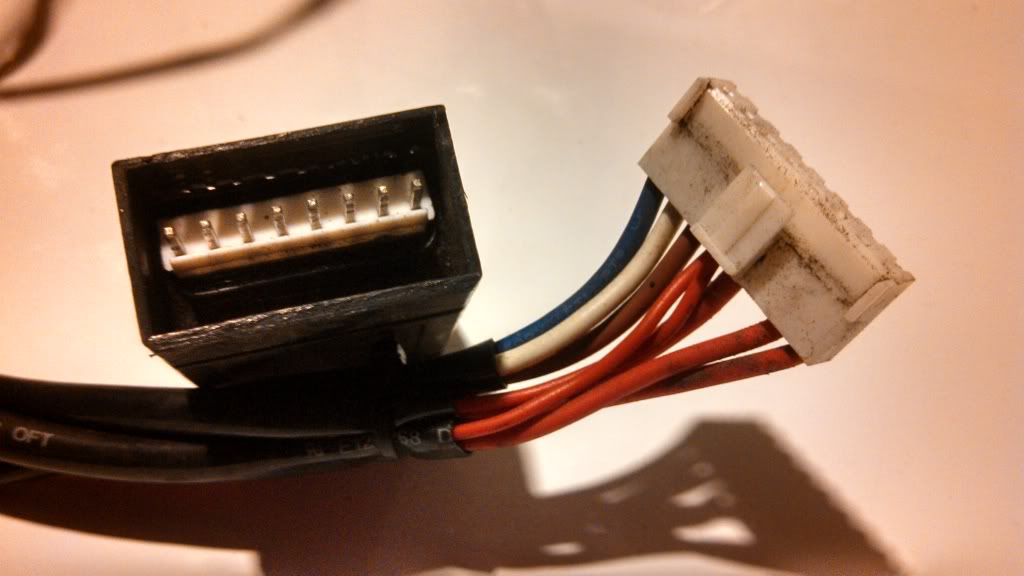

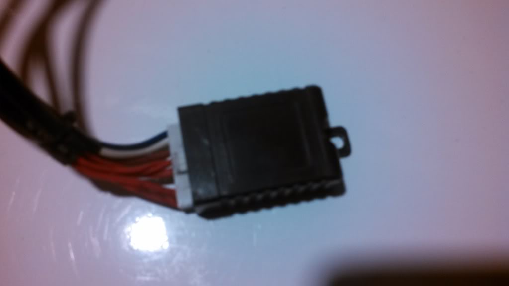

ok so the shutter worked on both lights? if so you need a new relay. dont be afraid. thats a cheap replacement honestly. ive dont way to many retros and solving issues on em is cake. i can take a picture to show you what you need. its unlikely for the harness wiring to go bad. unless you tore the insulator and broke the wiring. a ohm out test is to be performed to confirm wiring failure. but thats just not normal lol. my toughts point to relay. brb in a few with pictures of both ebay and morimoto.

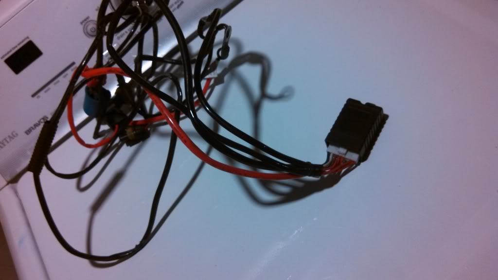

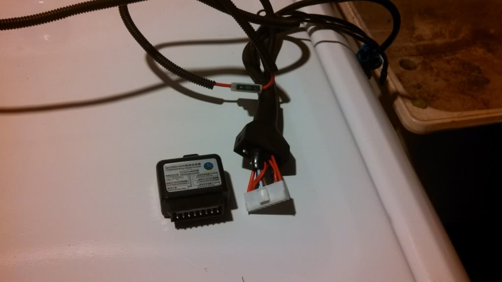

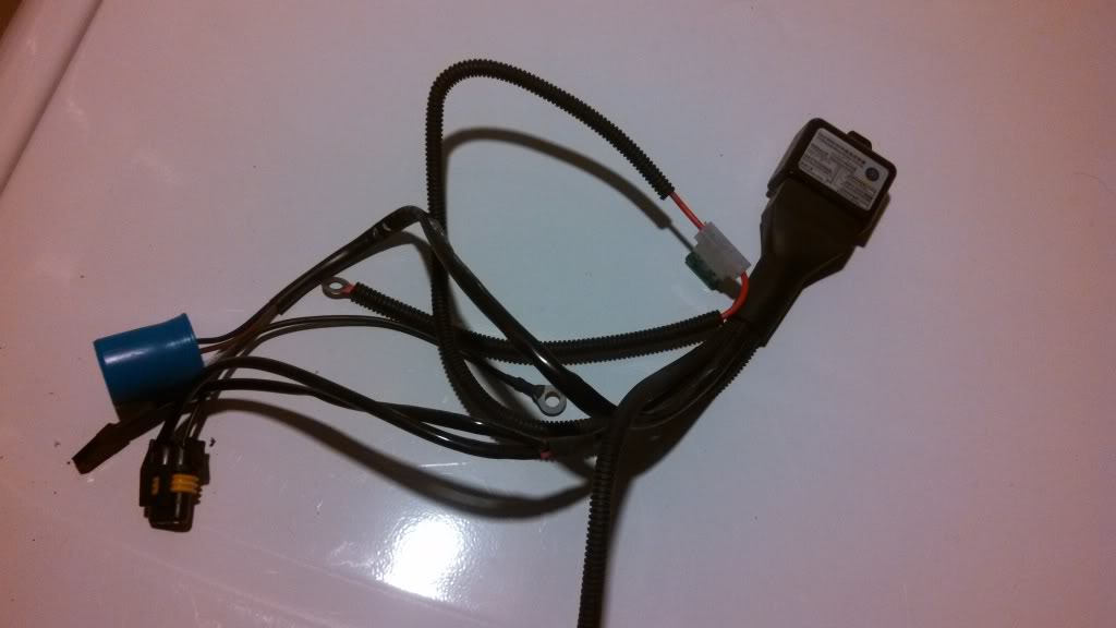

Old Nov 29, 2013 | 05:14 PM
  #43
G5GT2007's Avatar
Joined: 04-05-06
Posts: 3,516
From: CT

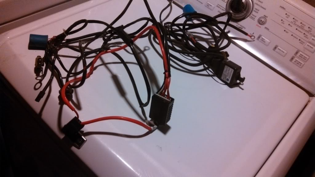

drivers headlight on pass side
pass headlight on drivers side
is that black thing the harness?
Old Nov 29, 2013 | 05:18 PM
  #44
Bass_Waves's Avatar
iTrader: (24)
Posts: 3,147
From: NJ 07060
i got pictures for u. thats the ebay harness. ebay ballast. ebay all. ebay mini h1.
give me a second . i will load up pictrures with details.
Old Nov 29, 2013 | 05:20 PM
  #45
G5GT2007's Avatar
Joined: 04-05-06
Posts: 3,516
From: CT
Well where can i get a good one where i wont run into this issue
Old Nov 29, 2013 | 05:22 PM
  #46
Bass_Waves's Avatar
iTrader: (24)
Posts: 3,147
From: NJ 07060

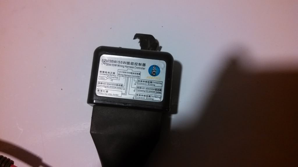

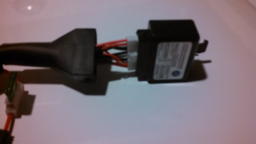

OK I got both harnesses for you to see.
Morimoto bottom. Outdates a lil.
EBay on top.
Size:  44.6 KB eBay harness
Size:  36.5 KB more eBay relay pics
cover down. As you can see there is a clop holding it in. The relay is serviceable. It Costs about 7$ per relay and 7$ a harness. Stupid I know.
Relay off.
Moving along
Morimoto harness. Had this for 3 years now. 0 issues
Size:  24.0 KB morimoto relay.
And finally Name:  IMG_20131129_170945_526_zpscc7710e2.jpg
Size:  54.9 KB quality relay right there.
