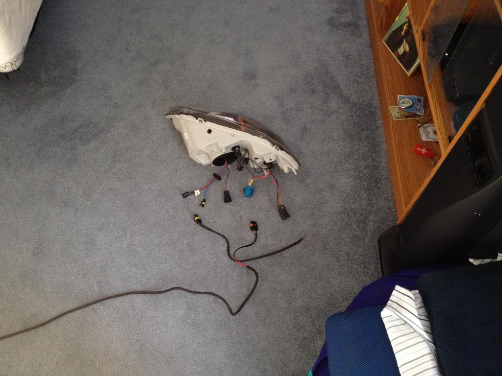

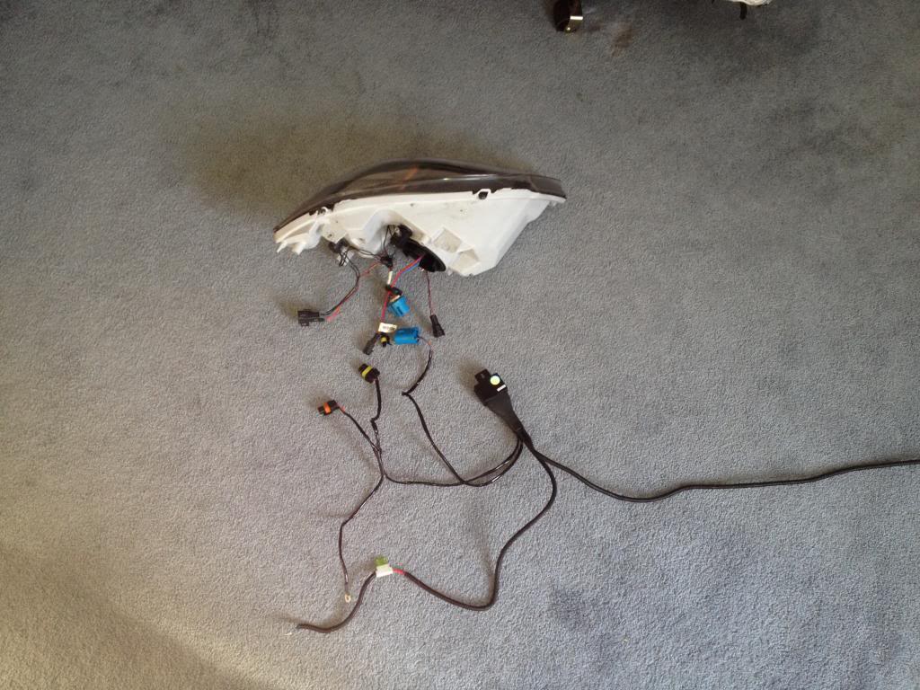

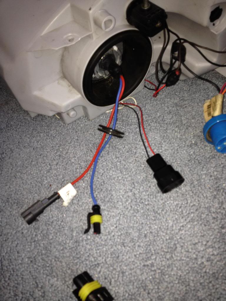

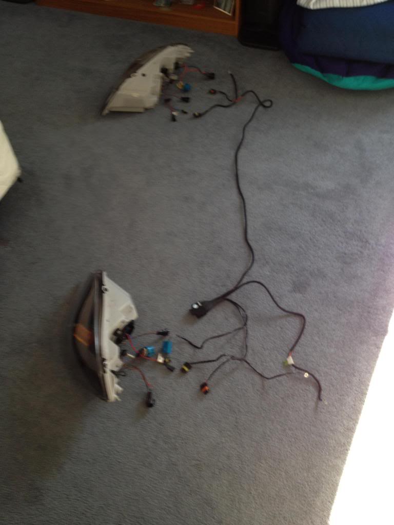

Originally Posted by G5GT2007
you already have an HID kit. just need a way to get power to the high beam solenoid that controls the shutters. the morimoto comes with 9006 plugs. which are for morimoto projectors. you have an ebay harness kit and possibly projector. so to run the morimoto harness you will need the high beam shutter adapters. to connect the harness to the projector shutter. its not simple to ppl but after u look at what u have and dont have. it becomes clear. take a good look at your connections. take a look at the small tiny plug coming from the projector. you have the reg hid bulb wires. and a tiny black connector. connects to the harness you have easily.
Old Nov 29, 2013 | 07:00 PM
  #52
G5GT2007's Avatar
Joined: 04-05-06
Posts: 3,516
From: CT
Okay tomorrow im pulling everything off the car and ill lay it out with the bulbs and show you what i have so you can point it out. Me seeing what yours talking about will help.
Old Nov 29, 2013 | 07:06 PM
  #53
Bass_Waves's Avatar
iTrader: (24)
Posts: 3,147
From: NJ 07060
yeah no problem. just send me a pm to get my attention to come into the thread. im on here today cuz of black friday sales. and this thread popped up so i kinda decided to help you out and point you in the correct direction. ive done way to many retros. got out faster than getting in because retro market was supplied by ur vendor. lol.
Old Nov 29, 2013 | 07:08 PM
  #54
G5GT2007's Avatar
Joined: 04-05-06
Posts: 3,516
From: CT
haha thanks man will do,
Old Nov 30, 2013 | 03:26 PM
  #55
Bass_Waves's Avatar
iTrader: (24)
Posts: 3,147
From: NJ 07060
ok ur lucky. plug was changed over to a 9006 style. just order the morimoto harness and thats it . i see the spliced up section on the ebay harness. so your on 9006 plugs. same as the projector solenoid. tiny wire to a big plug lmao.
Old Nov 30, 2013 | 03:31 PM
  #56
G5GT2007's Avatar
Joined: 04-05-06
Posts: 3,516
From: CT
perfect thanks a lot man so i can just order the reg harness in the link you showed me and forget having to order the additional wires. What are good ballasts to get im going to replace those as well.
