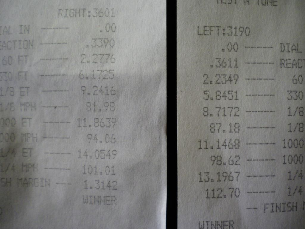

[IMG][/IMG]
The time on left is 100% stock..slipped clutch at 3k launch, nls every gear, stayed in 3rd thru the quartermile.
time on right, a few lil mods 28psi up front 45psi in back. 3k launch shifted normal to 6k in every gear.

Wow, great times there, especially the 100% stock times. I have to try the lower tire psi up front next time as well as run higher psi in the rears. I was launching higher than 3k which had me wheel hopping and my 60 ft times show it. So I have some work to do. Thanks for the reply & suggestions.

Practice makes perfect!
