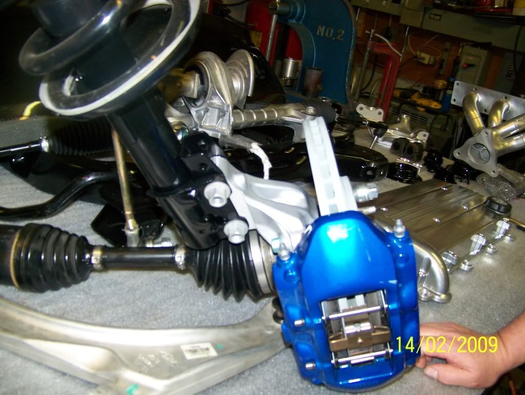

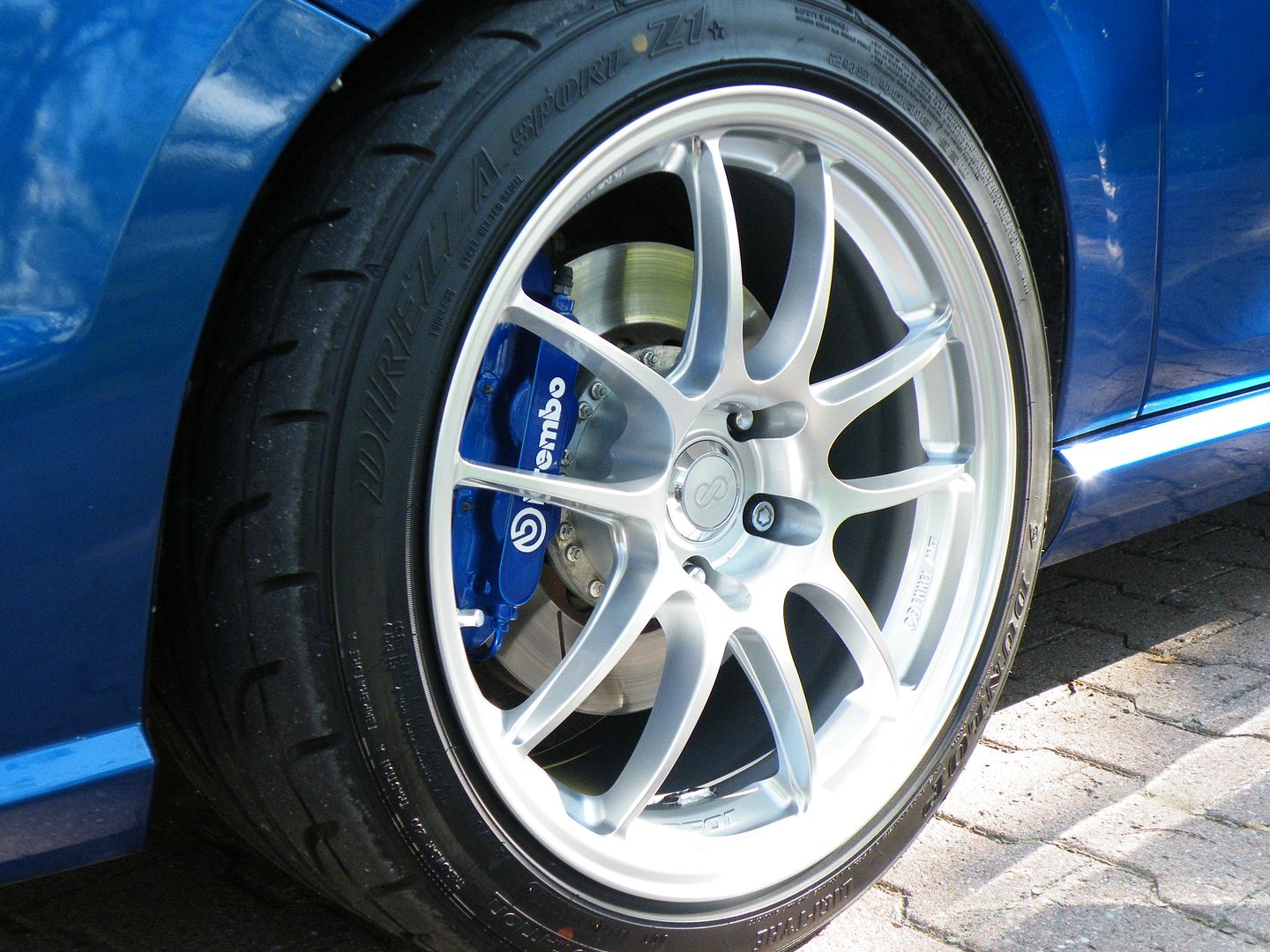

lnf hubs wont fit in an lsj knuckle.
u need pontiac grand am wheelbearings which have the correct reluctor tooth count to run your abs, plus machining same to fit your rotors/wheels/pcd and center bore, along with the LNF knuckle and the axle. then it will work.
or plug in the entire LNF knuckle, bearing and axle and ignore abs not working. Not recommended.
good luck. we mod this for folks, its custom and its not cheap, works great. I run this stuff on my RL, with a 300m special axle shaft ( lighter than LNF and stronger)
Grand am wheel bearing is already 5 x 114.3 but it has 10 holes, and the second set is 5 x 110. The 5 x 114.3 is actually 4.5 inch pcd, same as Mustang etc, so lots of wheels fit. These Pf01 are 9.5 inch wide 18's, not available in 5 x 110.
So it can work on an LSJ ... with some time effort and $ . Good luck with your project.
