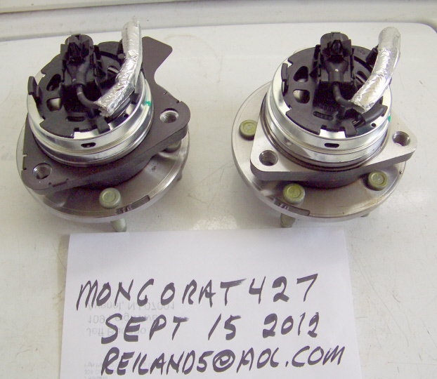

LNF New OEM front hubs $100 each Allmost half price
