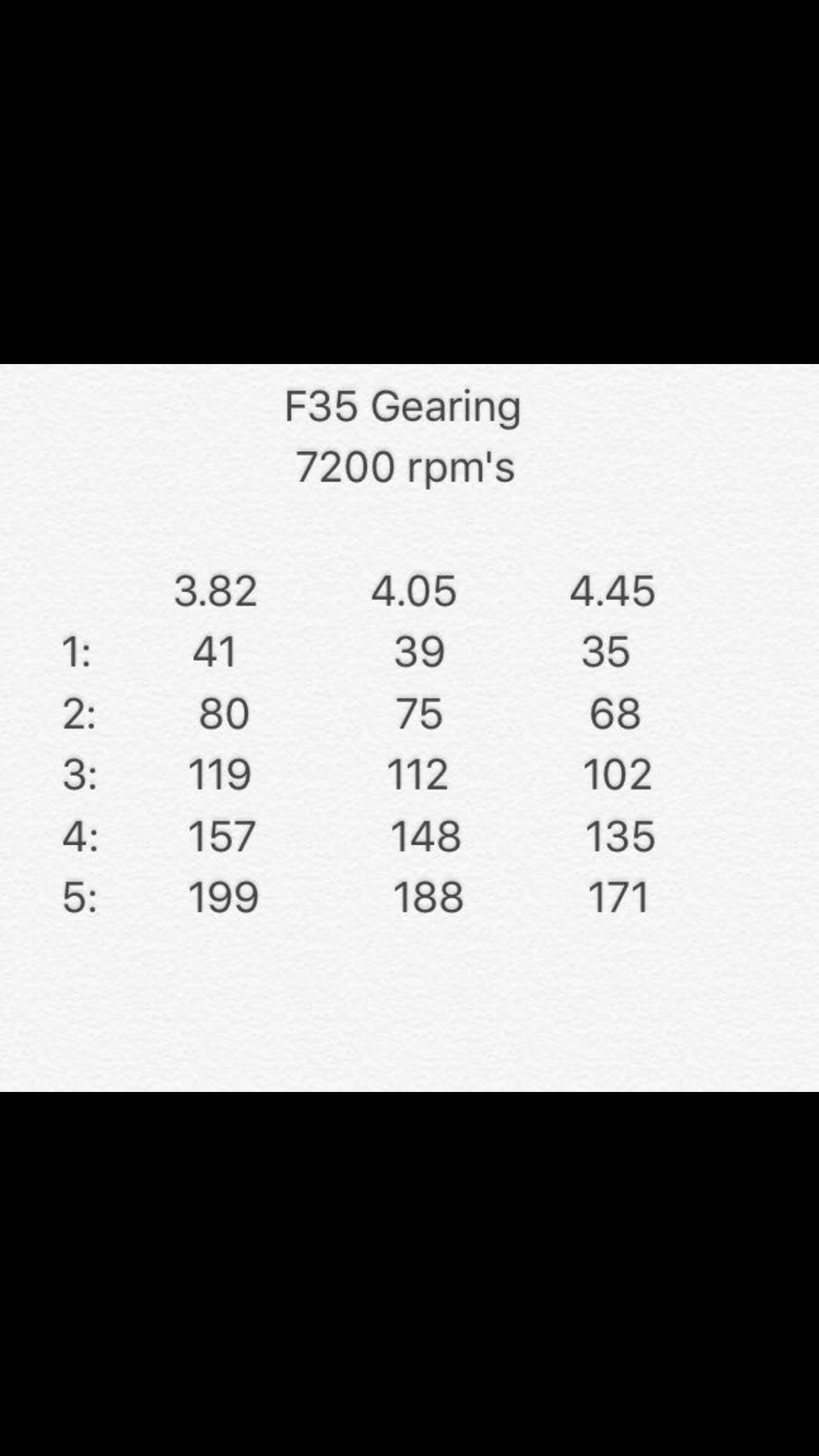

Nope, they are the only ones making it. Powell does good work and he is in Canada already so you don't have to pay the high exchange rate. 4.45 gears are short, I have one now. Here is a table for you to get an idea.
