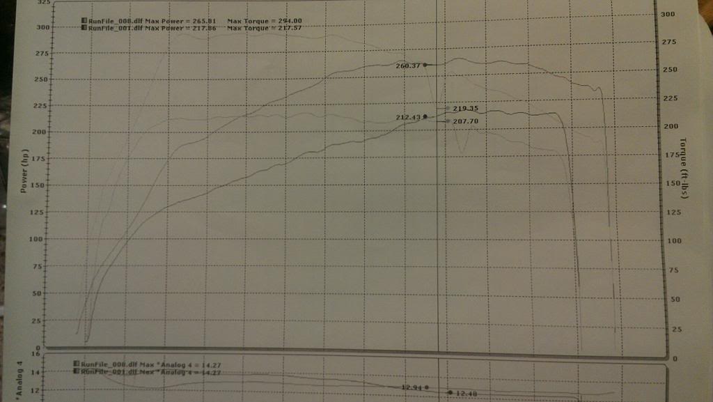

Got my 09 Cobalt tuned at Excessive Autosports in Sioux Falls today, Conservative tune on 91 octane. Very happy with how it runs. Mods are k&n sri, catless dp, zzp intercooler and charge piping. 265whp and 294tq

How much boost?

Well I'd definitely agree with the conservative part, GMS1 should make more than that.

I wouldn't be happy with that

Highlighted part explains it all, probably their first time working with a cobalt, wouldn't trust many with the job, ZZP, PWerks and a few tuners on here.

I'd sell my car if that's what it made tuned.

20psi, very conservative. Made 217 on their dyno stock

So you were 20whp under average in stock form. That's not near as bad. You can step up the boost to 22 or 23 and not have issues.

It picked up 40whp and 85ft lbs of torque. I assume its how the dyno reads. I don't get caught up in the numbers too much, as long as it drives well and is reliable. And I will run the quarter mile with this setup and see how it does

I think others are still correct. With a good tune you should be getting 60whp and 100ftlbs above stock. Especially with intake and downpipe.
But go to the 1/4 and compare the difference. You may surprise us.

I agree that its low, what should a 265whp lnf trap in the quarter, on a not so great track?

Looks like the dyno reads low, I think thats a pretty good tune. Looks like you made ~48 whp gain and ~76 wtrq.
Thats alittle more than GMS1.... so I dont know why everyone is saying GMS1 makes more...
Nice tune for 91 octane. How much boost did they set it to? 20 psi - 22 psi? I bet it pulls so much harder than it did lol. Probably feels like night and day now

This is kind of nice to know. They tuned my twinscew ss/sc and got 350/302 out of it. Pretty stout if this is in fact a stingy dyno.
