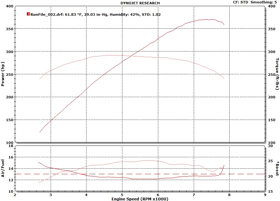

My dyno from early May at boost for boobies car show and dyno day at Modern Automotive Performance in Minneapolis. Losing boost up top somewhere, and still have to address that issue. This was right after I swapped to the 2.6, hadnt touched the tune since the 2.7, but after the dyno I only made slight changes, mostly to how the timing table ramped with the added boost moving the load farther down the timing table. The sniffer was back from the exhaust a bit so AFR wasnt as lean as it seems, although it was slightly leaner than I would have liked, and I wish I would have had time to adjust it before the dyno, but it was snowing the day before Ill get all the kinks worked out and hopefully dyno again at the next event in October.
Mods are TVS, 2.6", 3" intake, Vibrant header, ZZP 3" dp with kooks stainless resonator, Hahn 3" catback, Euthanasia ported head with ZZP 82# springs and retainers and ZZP S2 cams, 98# injectors, OTTP RSFS, E85, and dual pass endplate.
Heres the graph. Its 370whp/292tq

you're on e85 right? the only cooling mod you have is a dual pass?

Yep nothing but E85 for the past 4 years! I forgot to put that lol added it now. And yeah dual pass is all thats left on the car for cooling.

11.0-11.3 afr lean boy. left power on the table.
:P
those are some good numbers ... buy y so lean lol
:P
Shush you!! You know shes fattened back up to that now. I did watch my wideband while the dyno'd it though and it was 11.6 mid range for a quick second but mostly 11.8 then tapering up to about 12.3 up top. Meh if only I had more time. Story of my life lol
very nice man! congrats!
Thanks man!
See above. Was not that lean. The car actually pushed the stand the sniffer was on back about 6-8 inches when they went wot lol
Terrible numbers.....
You troll
stock bottom end?
Nice numbers! This is where I would like to end up when im finished.
Thanks! Yep stock bottom end on that corn syrup. 67k miles currently.

When you were still on the 80's you made 360 at 7k or so right? I know that spike makes you beat me on the hp list :P Does your boost keep climbing to redline? Im finally boost leak testing my car tonight and possibly swapping bypass actuators if need be. My belt is so tight so I dont think that is causing my issues.

boost goes all the way to 8k, when the ETC cooperates...
Old Jul 17, 2013 | 02:35 PM
JapEatr's Avatar
South Central *********
Joined: 05-14-05
Posts: 6,148
Likes: 48
this was on a 2.7 with ATI super damper, cutting out at 7.4k
im now on a 2.6" pulley with ATI damper, reving to 8k

I definitely need to fix my issues now! Its 97* out today but I think im going to say screw it and work on a hot car and swap bypass actuators. May be worth it lol cause as you can see my boost starts falling after 6k. And aint nobody got time fo that. Good to see our numbers reflect each other pretty closely though.
Thats just out of hand! what are your iats?
Hot enough but cool enough I dont pay attention too them much, I more so watch EGT's. I had a phenolic spacer but took it off chasing a vacuum leak. Ill put that back on when I swap manifolds this winter. I also had a cobra H/E but took it off chasing a IC system issue. Ended up being...............REVERSED IC PUMP WIRES! I felt like an idiot, thought it was only 04's that had that issue. So yeah, my cars whole life, all my track times and all have been with a basically dead in the water IC system.
