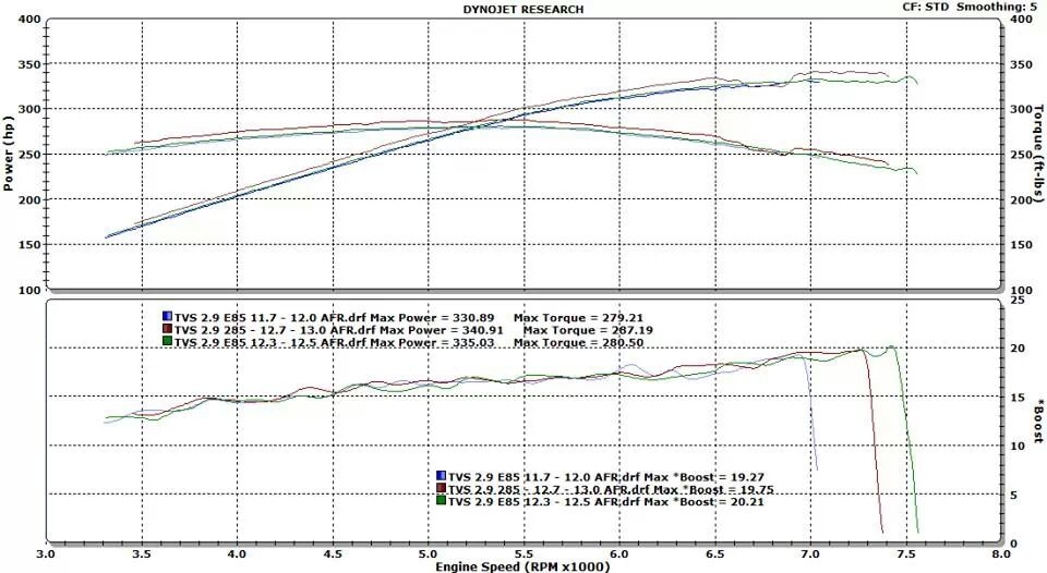

Took a vacation out to Cali last week. While we were there met up with 100% meth to do some try out some tuning on the rollers. Also got a chance to dyno my Trifecta tune the same day.
In the end both tunes made the same hp. We were both shocked to find out so.
Trifecta made 340whp/283wtrq
100% Meth hpt made 341whp/287wtrq
Got to play with different afr's and found our car made more power running leaner af 12.5-12.9 wot afr.
Was able to raise the rpm higher and get to 75k and bring the idc down to 105% on the 80's where the TVS makes power. I need to upgrade the fuel system more.
All in all happy with results for being simple bolt ons and stock long block. Mods are:
TVS, 2.9, 80's, E85, Dw300, modded K&N, Cti header, 3" catless Dp, 2.25 Megan catback, Griffin, Gm dual pass, Opt b, intake phenolic spacer

Great numbers but man, you guys are pretty nuts to push an injector to 105% idc. lol

Rev'd to 75k? That's impressive...

That catback is holding you back, pulley down, injector up

Did you end up leaving the car @ 12.5-12.9 wot afr?

Something's definitely not right if you're seeing 108% idc on a simple gms2 setup. Either the config you're using isn't setup correctly or something's seriously not right somewhere.
Either way, anything past a 95% idc you run the severe risk of running the injector static. The basic rule of thumb is to try to keep idc's under 85%.

LOL yeah I know man it's higher then I like but I like revving high as you can see its where the TVS made its peak power. As the car sits. I'm maxed out and need more fuel.

Haha I know going to 75k isn't super impressive, but The more we revved the TVS, the more power it made. My end goal is to get to 8-85k with the required mods for it. Thanks man.

I'm not entirely sure the cat back is. Maybe the resonator or muffler might. Mr. B posted a nice exhaust link that showed cfm flow versus piping size. I've seen a couple peeps make a little more then me on a 2.25. But its not staying on forever. Once I port the head and do cams I will get a bigger catback. I have big goals for the car. looking for that 450+whp mark. Injectors are coming next year, I'm getting a BRFS next to get more from the 80's and I'll play with pulley sizes for keeping the blower efficient.

Thank you sir. Currently I'm still on the Trifecta tune and yes in Tucson its around mid 12's afr here at wot. We had drivabilty issues trying to switch to the Hpt tune that Steven couldn't figure out. car kept bucking bad and o2 sensors stopped reading. Gonna try and figure it out and switch to HPT later
