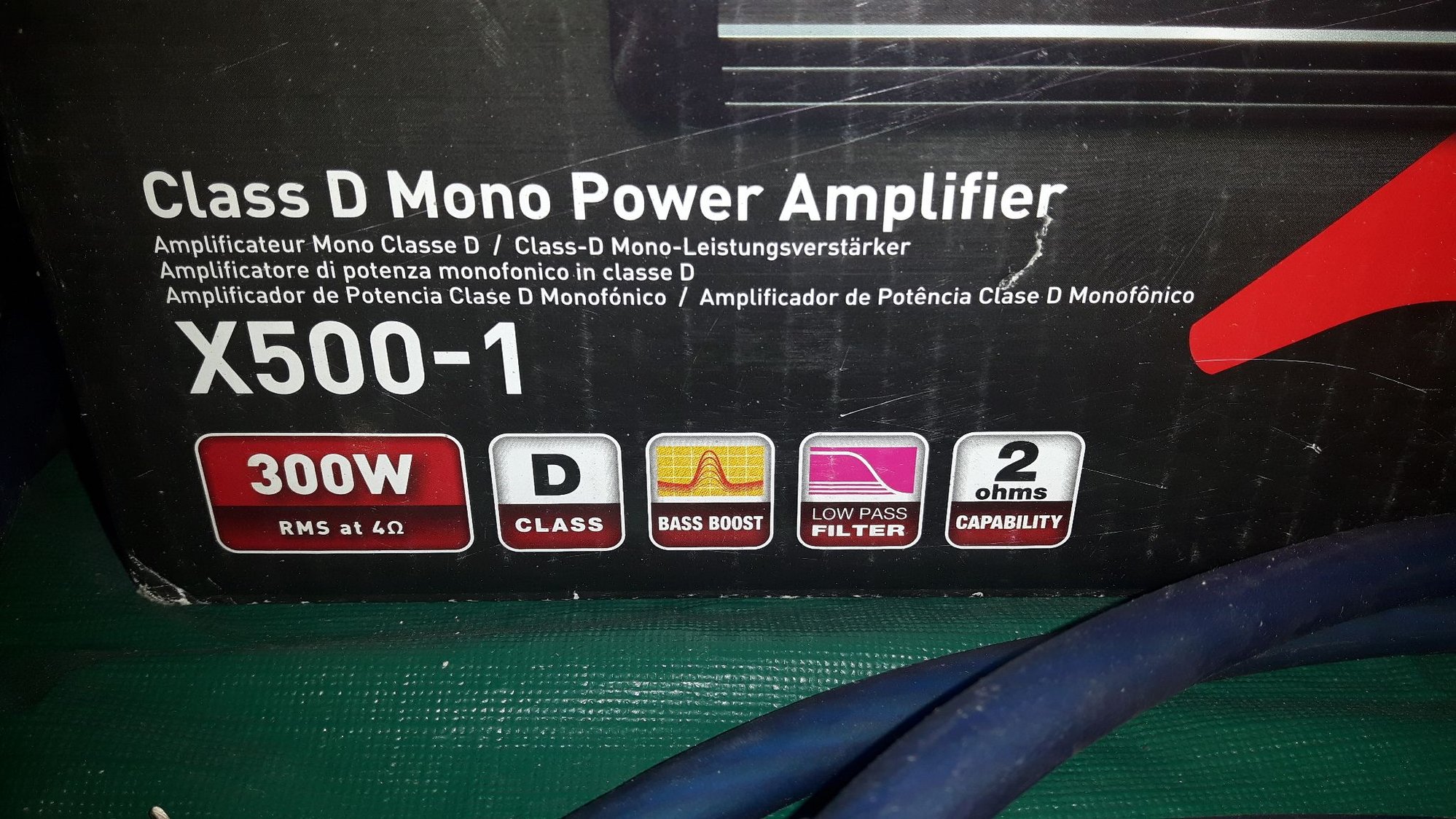

Wondering if these two will work together. Is there another way I could wire these to achieve lower ohms? Or would I be better off just hooking up one sub for now and save up some money to buy another Kenwood X500-1. I paid almost 700$ for this amp back in 2012 or 2013 so i really dont want to patt with it since it was suh a bg expense...
All help greatly appreciated! This is a good fourm, good to see people still use it.
525 watt peak. DCV 4ohm sub.
Kenwood x500-1. 300W RMS @ 4ohms. 500W RMS @ 2ohms. 1000W max power.
Subs wired @ 8ohms....

If the subs are 4 ohm dvc, you can get 2ohms out of 1 sub or 1 ohm from both, but you can't do 2 ohms for both. The diagram you have is for 2 2ohms dvc subs not 2 4 ohm dvc subs.

it doesn't say but would my amp be capable of handling a 1 ohm load? Would it pound better to have one sub. I was almost thinking about doing something like this: Would be easy to do with some time. Could you use a router on MDF?
