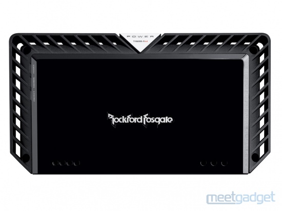

NEW EQUIPMENT I decided to use
Rockford Fosgate T1500-1bdcp
Rockford Fosgate T600-4bdcp

Great Choice for amps! What subs are you going to use?

Well since I wasnt even planning to get new amps to keep the cost down. That worked well didnt it

Looks great man cant wait to see the finished product. Im hoping to do my install sometime next year. Im considering adding another T1 and getting a real amp
