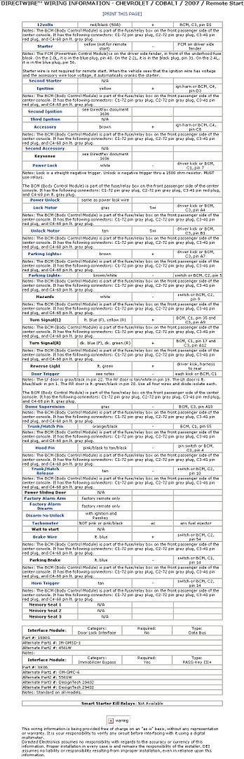

I installed the alarm along with power locks, but I need to know what wires can I tap into for the parking lights to flash when I arm and disarm the alarm and the wires for the door triggers. Thanks in advance

Is this any help?

I'd assume so but I don't know for sure. I got that from my buddy who owns a stereo shop.
I do know that Chevy has used brown for parking lights for decades.

Originally Posted by Blur.fx
Is this any help?
Yep, that helps alot thanks man
