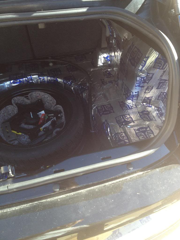

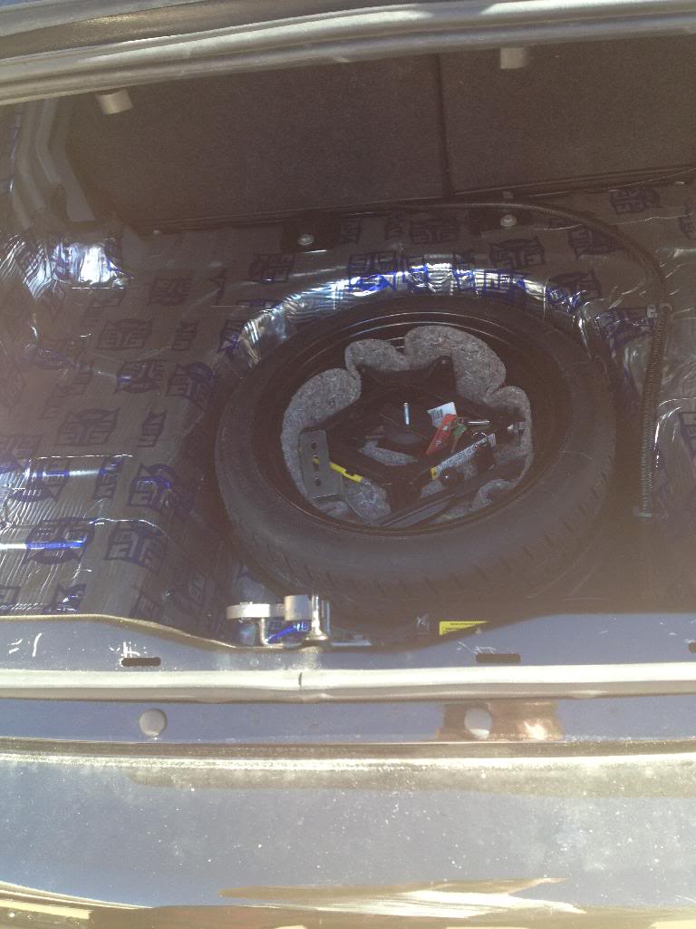

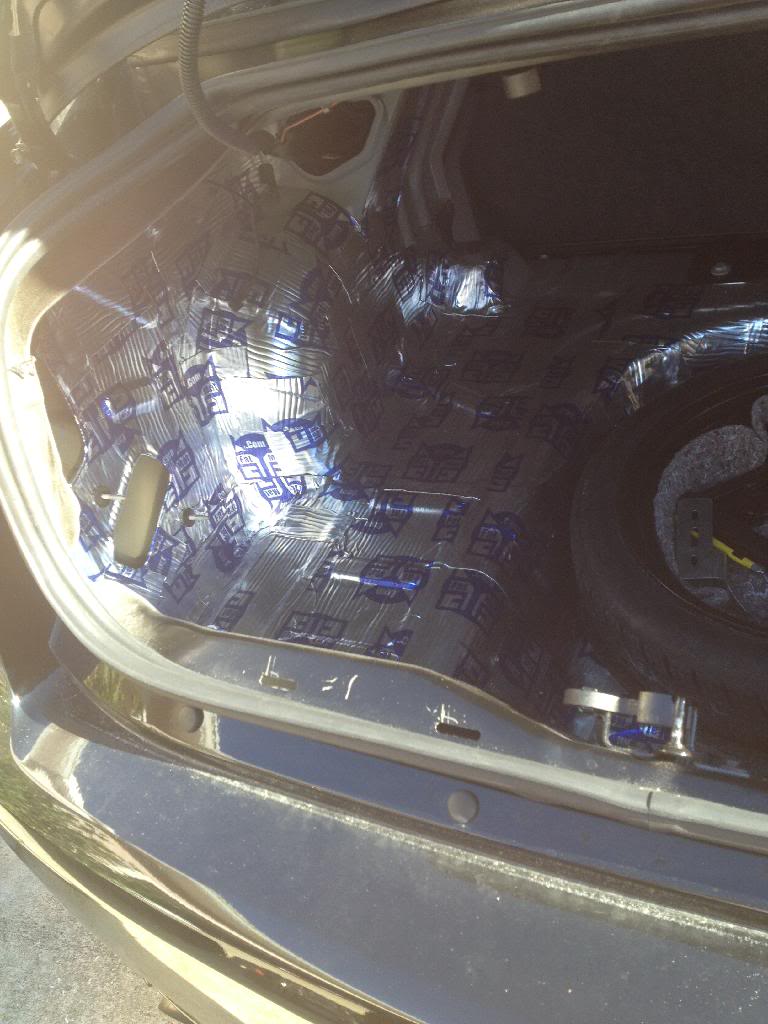

This is what I ended up doing. I layed two layers behind the sub and on the floor on the exhaust side. What a difference in exhaust drone inside the cabin as well as fullness of the bass. I recommend this to anyone looking to quiet down their car.
I am going to pull the back seat and do underneath it next as well as the door skins.
