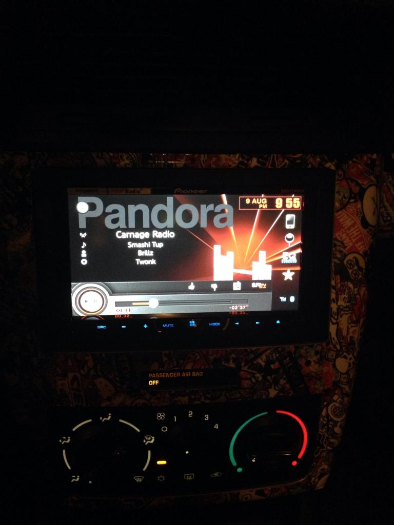

Yea I cut out the plastic and took out the metal bar.
Just need to figure out the radio problem. Not finding any channels. Everything is fuzzy. Expect one. At one time. I could hear channels. But very fuzzy. I can't tell it's my antenna. Since it's off track. But that shouldn't stop it from getting signal
