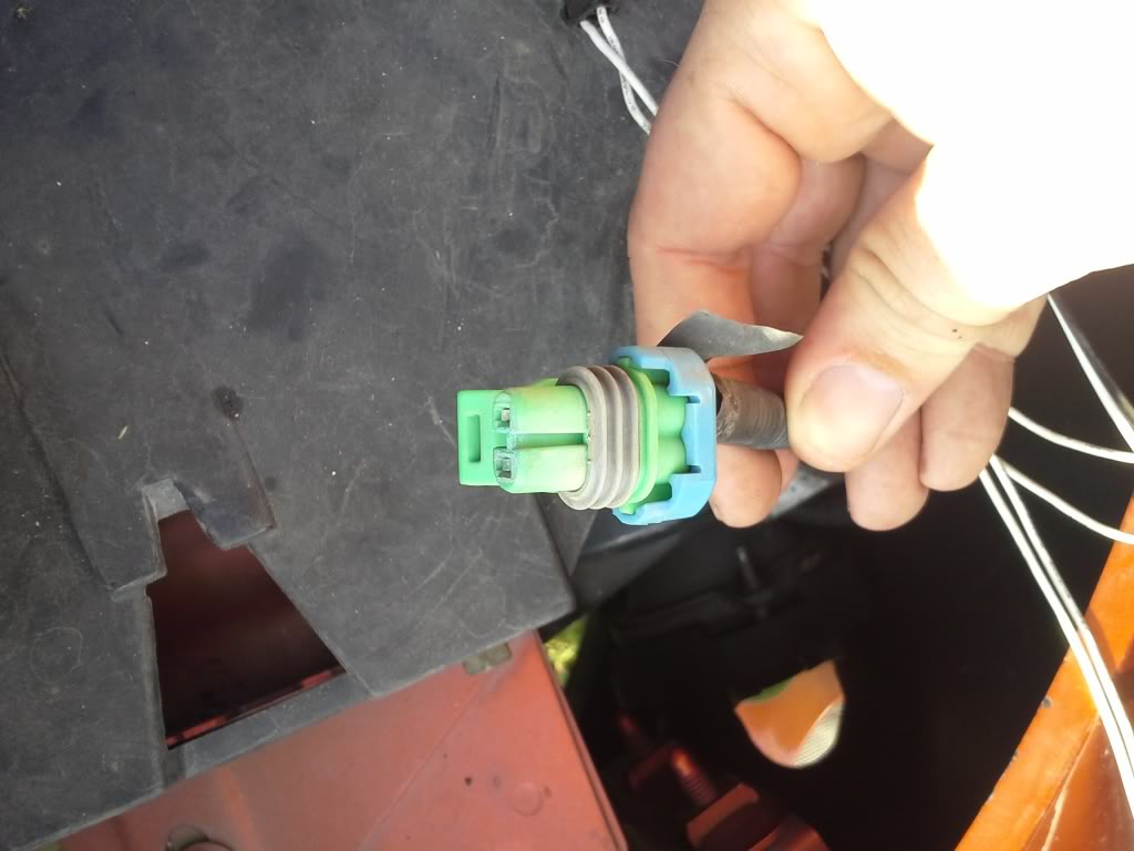

found out why my horn wasnt working. someone unplugged It prior to my purchasing of the car. so plugged it in and it works now. but now im left with this plug wire and I have no idea where it goes. help? its in the same area as the horn.

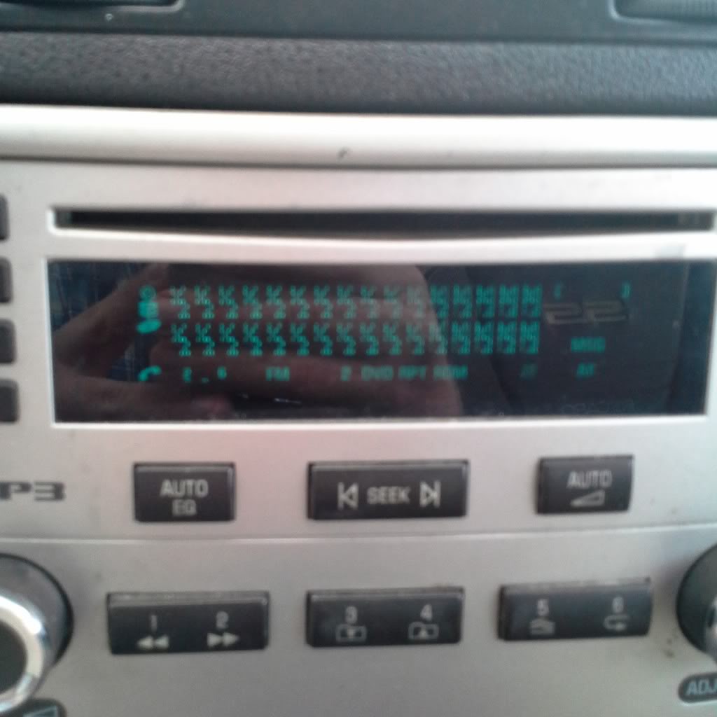

oh and has anyones radio every done this? it still worked fine. but flashed all this weird crap.

The connector looks like it's to your exterior air temperature connector, hooks into the back of the driver's headlamp mount towards the bottom.
Stereo looks not happy. Try disconnecting the battery for 30 minutes and then hooking it back up.

well the stereo isnt stuck like that. just does it from time to time. its odd.
and ill look for that port to the plug again later. thanks guys.

anyway to fix this readout?

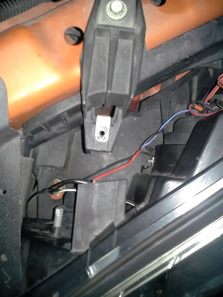

oh and why would anyone cut the headlight bracket?

the readout is reading -22 because the air temp sensor is unplugged.....the sensor should be in the headlight housing on the drivers side. It's probably missing

sunburst the plug wasnt even plugged in. I took out the whole headlight bracket behind the headlight and plugged it back in. this is the first time ive ever had a temp reading lol.
salvage i agree something funny is up with my car, but I had a friend whos a mechanic check all the crumple zones and what not and he doesnt think it was wrecked. if it was it wasnt any kind of major impact or it was hella repaired. lol
Old Aug 3, 2013 | 09:45 PM
Sunburst_SS's Avatar
Joined: 04-08-06
Posts: 2,395
From: Charlotte, NC
so the connector was unplugged and you had no reading......then you plugged it in, and now it reads -22?
Old Aug 3, 2013 | 09:48 PM
06cobaltncng's Avatar
Joined: 06-11-13
Posts: 5,609
From: North Carolina
correct sir. I found it randomly looking into why my horn didnt work. the horn was unplugged and I saw that plug for the temp sensor. looked into what it was and then found the port and plugged it in. started the car and it sat on -22 for a while then said ice warning or w.e. lol havent restarted it since.
Old Aug 3, 2013 | 09:50 PM
Joined: 04-08-06
Posts: 2,395
From: Charlotte, NC
well, it won't update right away......so if you drive it and the temp doesn't change, you will most likely have a bad temp. sensor.
Old Aug 3, 2013 | 09:55 PM
Joined: 06-11-13
Posts: 5,609
ahh ok ill go for a drive shortly. im still trying to figure out why all those were unplugged and why the bracket was cut. and why the side skirting is scrapped like it was lowered lol. so much unknown.
Old Aug 3, 2013 | 11:32 PM
Joined: 06-11-13
Posts: 5,609
it works now! yay

That headlight bracket was clipped, possibly by the manufacturer of the headlamp or the tool that installed it.

would there be any reason why only the drivers side headlight is clipped and not the passengers? lol
