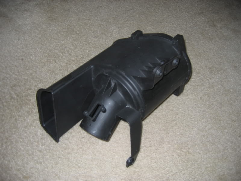

no it has nothing to do with the tb it was down in the bumper where the stock air box is and on top of the oval opening a metal plate was on top of that opening and restricting flow. Name:  newpics030.jpg

So you cut out your maf sensor?
Old Dec 12, 2013 | 10:07 AM
  #38
yellowsupercharged06's Avatar
Joined: 03-15-10
Posts: 5,101
Likes: 29
From: Long Island NY
soo im assuming someone put a metal plate over it to keep water from getting in lmao ... wata moron.
by oval you mean the 4 sided opening all the way to the left of the picture, where the air is sucked in ?
Old Dec 12, 2013 | 10:16 AM
  #39
jdog1990's Avatar
Joined: 12-11-13
Posts: 26
From: ephrata
no I took the metal part off for the air box opening the oval opening. yes yellow but it wasn't attached to the air box it was screwed to the head light mount hovering over the opening and I took it off and now the car works properly

Picture of it?

Picture of it?

Old Dec 12, 2013 | 10:55 AM
  #46
blueLNFftw's Avatar
Posts: 10,359
Likes: 84
idk what the **** that think is lol
Old Dec 12, 2013 | 10:57 AM
  #47
jdog1990's Avatar
Joined: 12-11-13
Posts: 26
From: ephrata
I don't know either no one else has or had that part on top of the oval opening of the airbox?
Old Dec 12, 2013 | 10:58 AM
  #48
blueLNFftw's Avatar
Posts: 10,359
Likes: 84
nope. and based on the craftsmanship, some one made that lol
Old Dec 12, 2013 | 11:00 AM
  #49
That looks like ghetto ass home made I don't want my kid beating the **** out of the car so I'll restrict the intake
Joined: 03-15-10
Posts: 5,101
Likes: 29
haahahaha looks like a mini frying pan lmao ... prbly weighted 5lbs lol
hahaha poor car ... getting horse **** fuel trims and AFR
