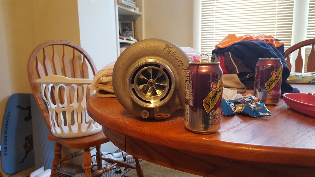

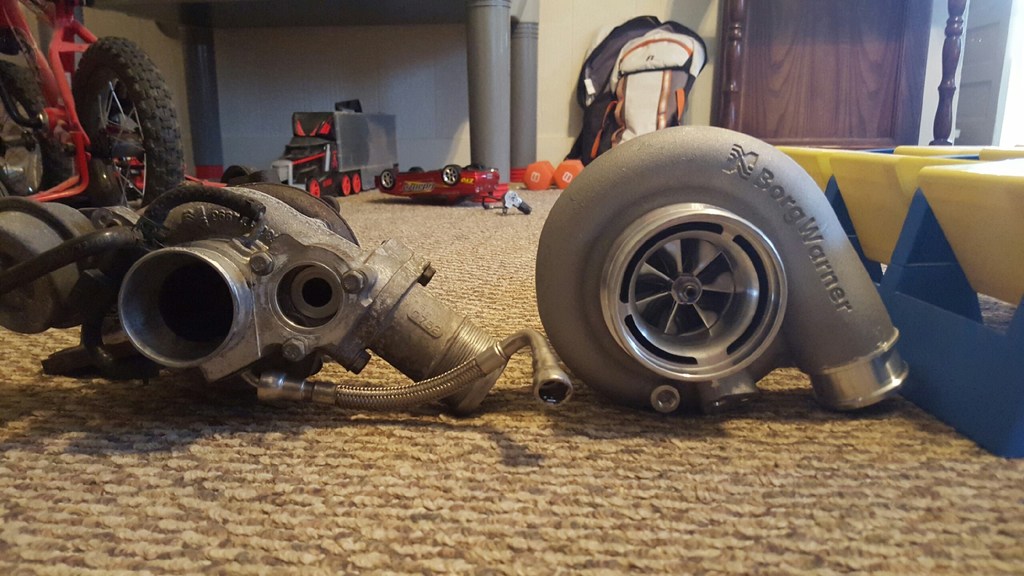

OK guys as some of you know this week I am tuning a 257 .63ar on 100% stock engine running E47. I'm expecting the stock fuel system to be able to keep up on spool but not topend on high boost but we'll see what I can get from it.
So if you haven't heard anything about the 257 here's some info
Compressor Specifications
◾Compressor Type: Forged-Milled Wheel (FMW) Extended Tip
◾Compressor Wheel OD (exducer): 76mm
◾Compressor Wheel Inducer: 57.2mm
◾Max Flow Rate: 64 lb/min
◾Compressor Housing Connections:
◾Inlet: 4.0" Hose Coupler
◾Outlet: 2.0" Hose Coupler
Turbine Specifications
◾Turbine Type: High Efficiency S200SX Inconel Turbine Wheel
◾Turbine Wheel OD: 70mm

Lots more to come after I get the trims dialed in I will post my first impressions but get ready for lot of info and updates as we get the tuning done

That thing is huge lol

Yup! Flows 64lbs
259 62lbs
7163 60lbs
256 56lbs
6758 53lbs
