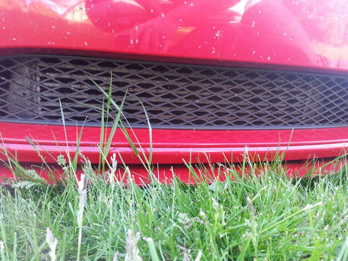

By the way, the Cobalt has had the front mounted intercooler replaced with a larger all aluminum one. This stretches across the entire front grill of the vehicle. The plastic charge pipes have also been replaced with stainless steel charge pipes. I *think* the stainless steel charge pipes have been welded onto the pipes for the front mounted intercooler... So I think these are things that can help with cooling if the turbo is replaced at all? Please forgive me, I'm trying to learn more about under the hood. I really don't know very much about cars, but I'm trying to learn!

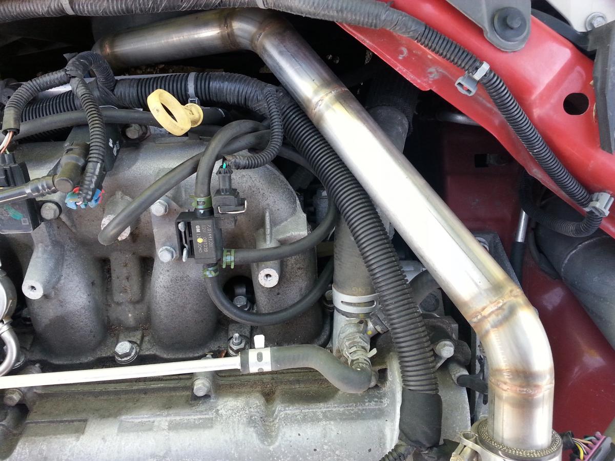

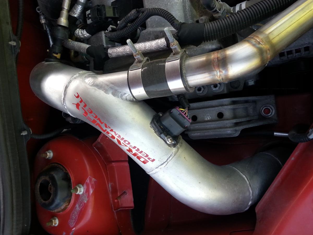

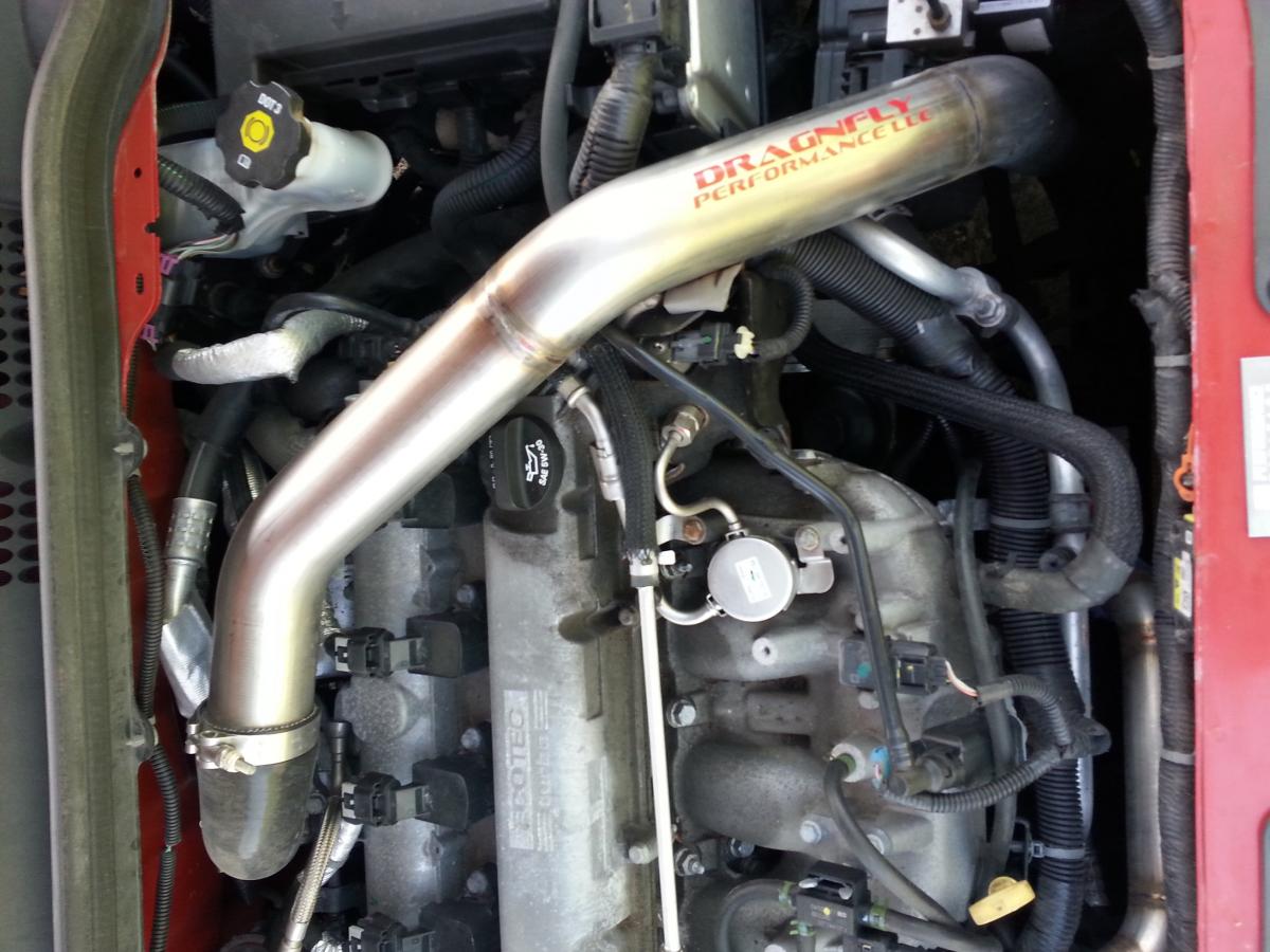

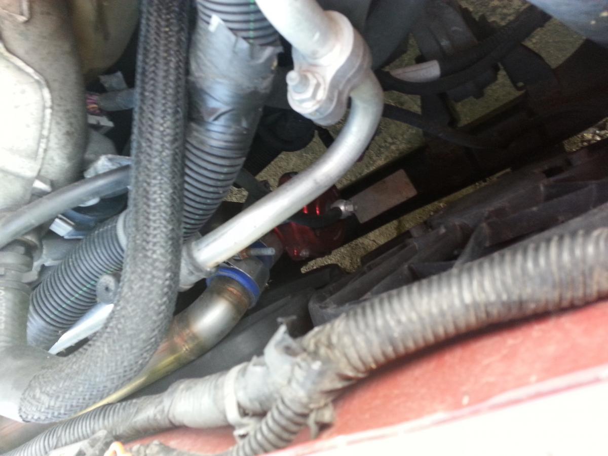

Here are some pictures I took. I hope they are good enough to make some sense out of them.
Old May 21, 2014 | 08:44 PM
Dubz's Avatar
Joined: 05-16-14
Posts: 99
From: Dixon, IL
I really don't know what parts are what if you could tell me what they are though, I would greatly appreciate it!

Can you take a pic of the whole engine bay. Those are custom intercooler pipes that I have never seen before. I'm interested in the one that's welded into the intake is that from a bypass valve??

Wtf kinda intercooler piping is that?
Looks like it just goes to an aftermarket BOV.

The thing should be called Frankenstein. OP, the car has to be tuned for all of those mods, no cat, relocated BPV. When you give it the beans, what boost PSI is displayed?

Do you think it would be wise to look at replacing the custom intercooler piping before I get the tune done? Or should I get a tune done with the current setup?
