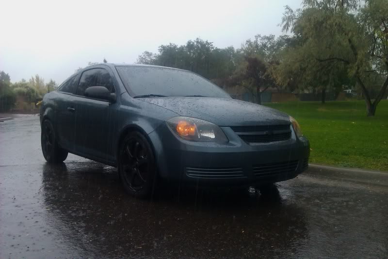

got my l61 boost PICS and VIDEOS
specs 2.5" piping 3" catless open downpipe, garret 50mm t3/t4 turbo, 38mm external wastgate connected back into downpipe, manual boost controller, spec stage 3 plus clutch exedy fltwheel, 39# injectors, trifecta tune 10-12 psi

how its running? video?

holy sleeper!!, vey nice job

it runs great thanks its such a sleeper here are some videos

i think you're going to run out of fuel pretty quickly with 39# injectors...nice work though
are you running an LSJ fuel rail?

So your on stock internals?

I was good on mine till 14 PSI never hit the point where they ran out of fuel though, just went over 100% IDC

this is sick. stock internals scares me though haha

Awesome! This makes me miss my boosted 2.2L i had. I ran 11psi and made 249whp 254wtq on stock internals with no signs of anything bad. Still running to this day by some chick. Very fun car!

Awesome setup man. What kind of power you making on that ?

Hp ??
i don know i run 10 psi now it pulls hard lol i have not dynoed it yet but i din the calculations on the specs on my kit and the cfm of air i flow it should be around 300 whp but i don drive it all the time im just waiting on money to build it

Ehh Probably more like 260whp... race a tuned lnf that will tell you where your at.

is that the stock intake manifold?
