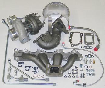

well im lookin to go turbo on my 2.2. what kit would everyone suggest? i was lookin at the garrett kit for the 2.4 but wasnt sure if the return style fuel system part would even work on the 2.2. did zzp ever make the 2.4 kit? i want a kit with a BOV, yes that makes me sound like a ricer but i love the sound of a BOV and would prefer to have a kit that includes one. i have an automatic so my only choice is terifica(spell??) so im just lookin for a bolt in kit without the extra of a tune or tuner that comes with it. any thoughts?
another thing is i'd rather have an upgraded intake mani as well with the kit.

I would suggest you get the Garrett Turbo Essentials Plus Kit (P/N 766621-3)
Then go buy the atmospheric BOV of your choice. I recommend the HKS SSQV BOV if you like to hear the pssssttttttt
Your going to need injectors, intercooler, piping, air filter, trifecta tuning and a boost gauge if you want one.
And yes get the 2.4 intake manifold but that you should get from crate engine depot or GM parts direct. I already had the 2.4 mani swap done when my turbo was instaled.

If you cut the piping, that means you will have at least 2 ends that don't have rolled edges. You run the risk of your couplers slipping off during boost. I would suggest the above kit, and then going with some 42's, your choice of bov, 2.4 mani, intercooler optional, with an autometer boost gauge. That way you won't be in the situation I am and have to make your own dp.

as for the second guy the rolled edges help, but arent 100% necessary. your not going to run the entire piping route and not have a place that doesnt have a rolled edge.
