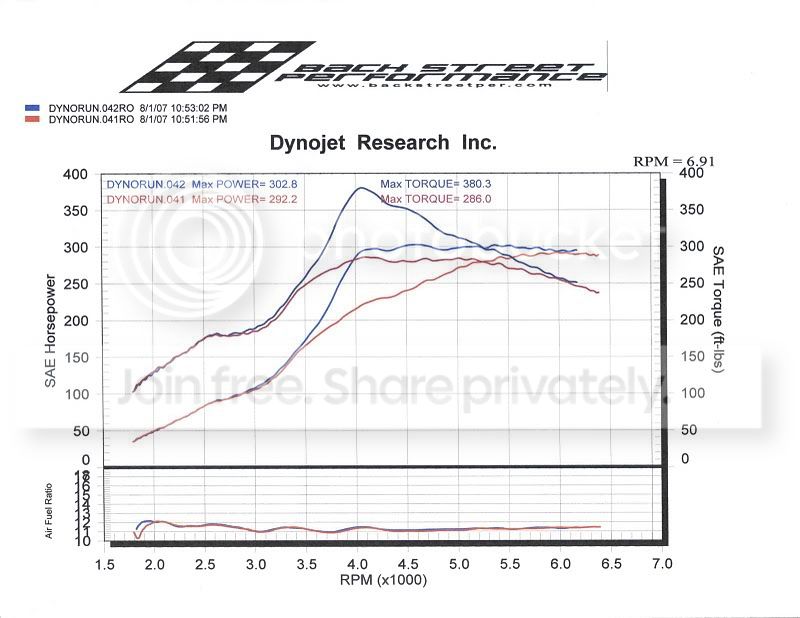

A friend of mine is running in the NASA events and he has to stay in his power to weight ratio so his boost controller is set up to run 12.5 psi at low rpm and 6 psi at red line. Here is his Dyno of his KA24DET 240sx
