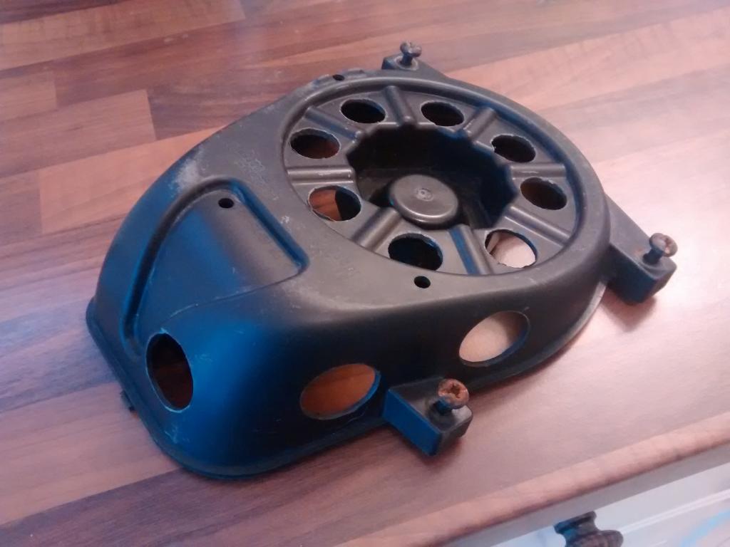

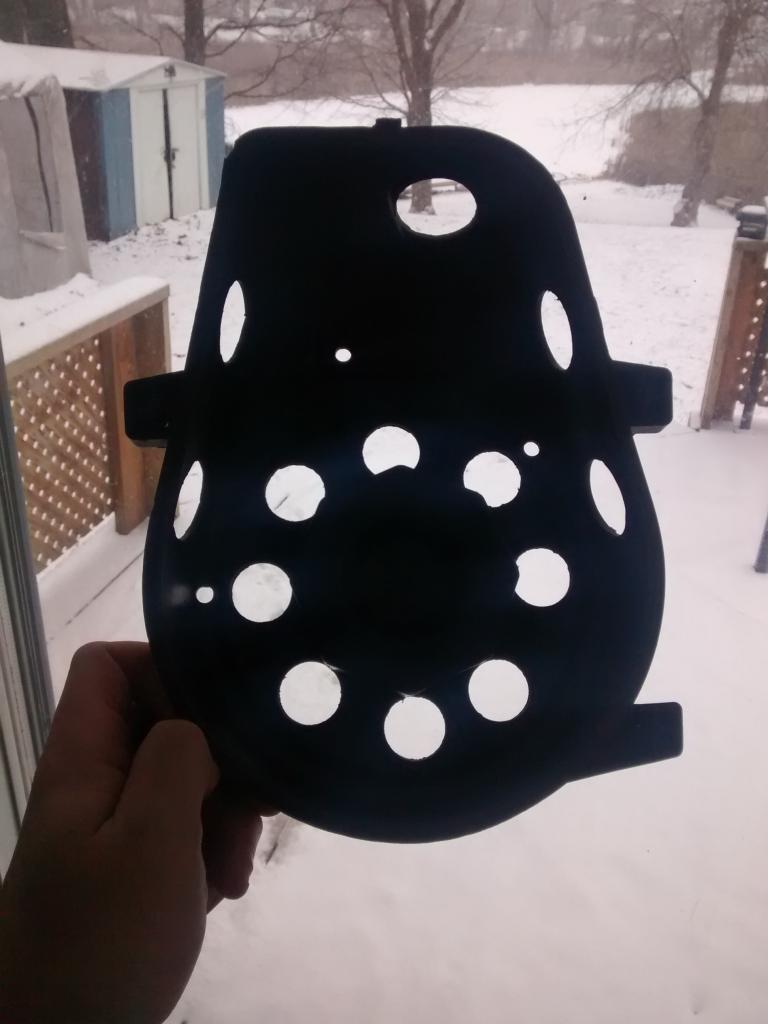

Just do what Staged says and end up with a great mod!

If you wanna be lazy just take the cover off and leave it off, it's not drilling big holes make a difference
Old Mar 25, 2015 | 08:01 PM
UnkleRaRa's Avatar
Joined: 10-20-14
Posts: 736
From: Canada
If you want the stock air filter to fall off, sure, go for it! Lol.
The bottom plate is what keeps the stock filter in place. Without it, the filter would fall off, and your intake would suck in all kinds of unwanted ****.
If you remove the bottom cover, you have to use an after market filter with a rubber neck so you can use a hose clamp.
But the "hole" point of this mod is to be able to utilize the stock filter, since staged and others have proved it superior in longevity and filtration, while allowing the stock box to breathe better.
Otherwise just get an aftermarket kit.

Originally Posted by double clutch
It wont fall off
The stock filter or K&N drop in will fall out if you do not have the bottom lid on.
Ask me how many times I've heard of this happening to kiddies thinking it was ok to just remove the bottom lid while running the factory filter, lol.
Do not run the factory box w/o the bottom lid if u plan on running the stock air filter or K&N drop in.
I have one for sale in the classifieds! :
At least someone understands the point of my modification.
