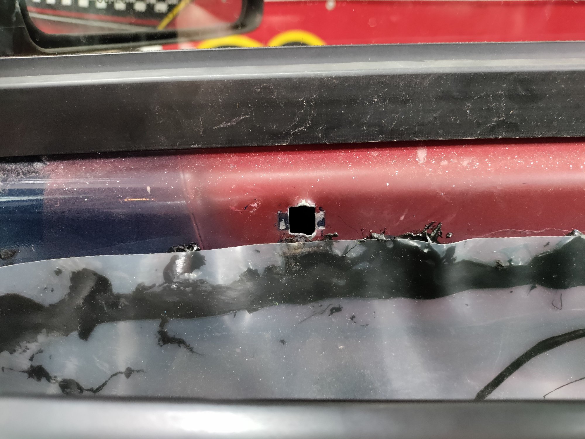

This little threaded plug thing for the bolt for the interior door handle got lost, whats that piece actually called so i can replace it? Or is there an off the shelf solution for it

Its called a push in nut, the size is M4.2X1.41X6.9. You can check your dealer for them, they are not cheap though. Your better off pulling some from the junkyard. Also check inside the door in the bottom, they can fall in there when taking the door panel off sometimes. Its the highlighted number in the pic if you want to reference it at your dealer so they can find it easier.

Depending on how expensive i may get a couple. i cant imagine it being more then a few bucks. I Have a couple pick-n-pulls in the next city over i may hit one of them up. Perfect place for those odd ball bits. I Didn't want to risk ripping the plastic vapor barrier to dig inside the door. Maybe i get get a new barrier too lol

Junkyard balt came in handy. But for future reference the GM PN for that push nut is 11570654
