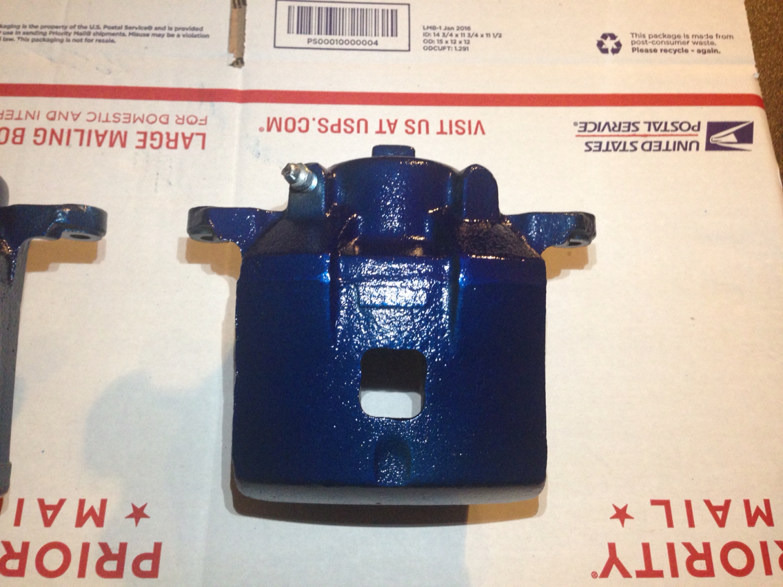

GreenStang's Avatar
Joined: 10-01-15
Posts: 263
From: Tennessee
Calipers painted
