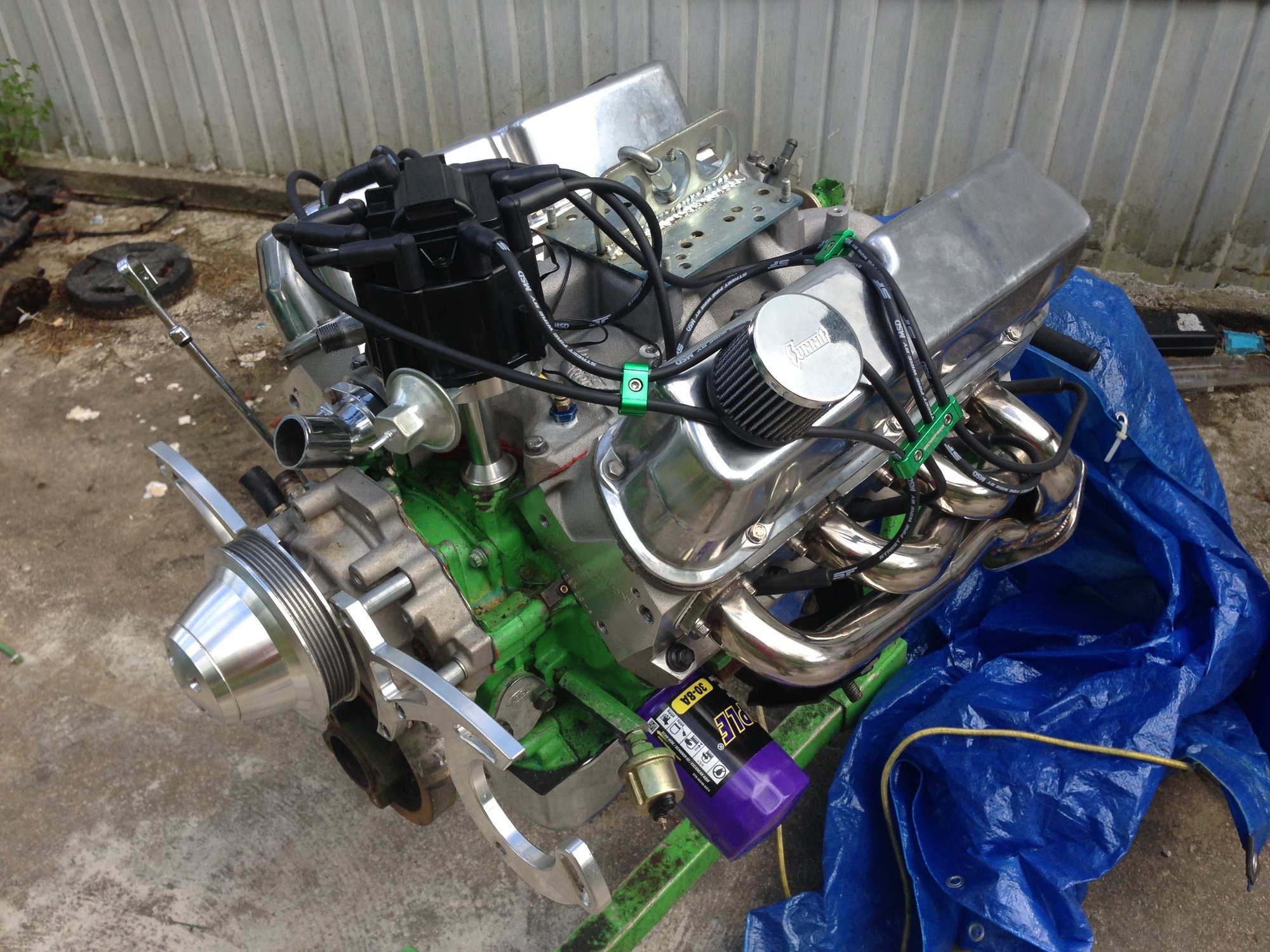

308 Motor that I built for the Stang I used to have

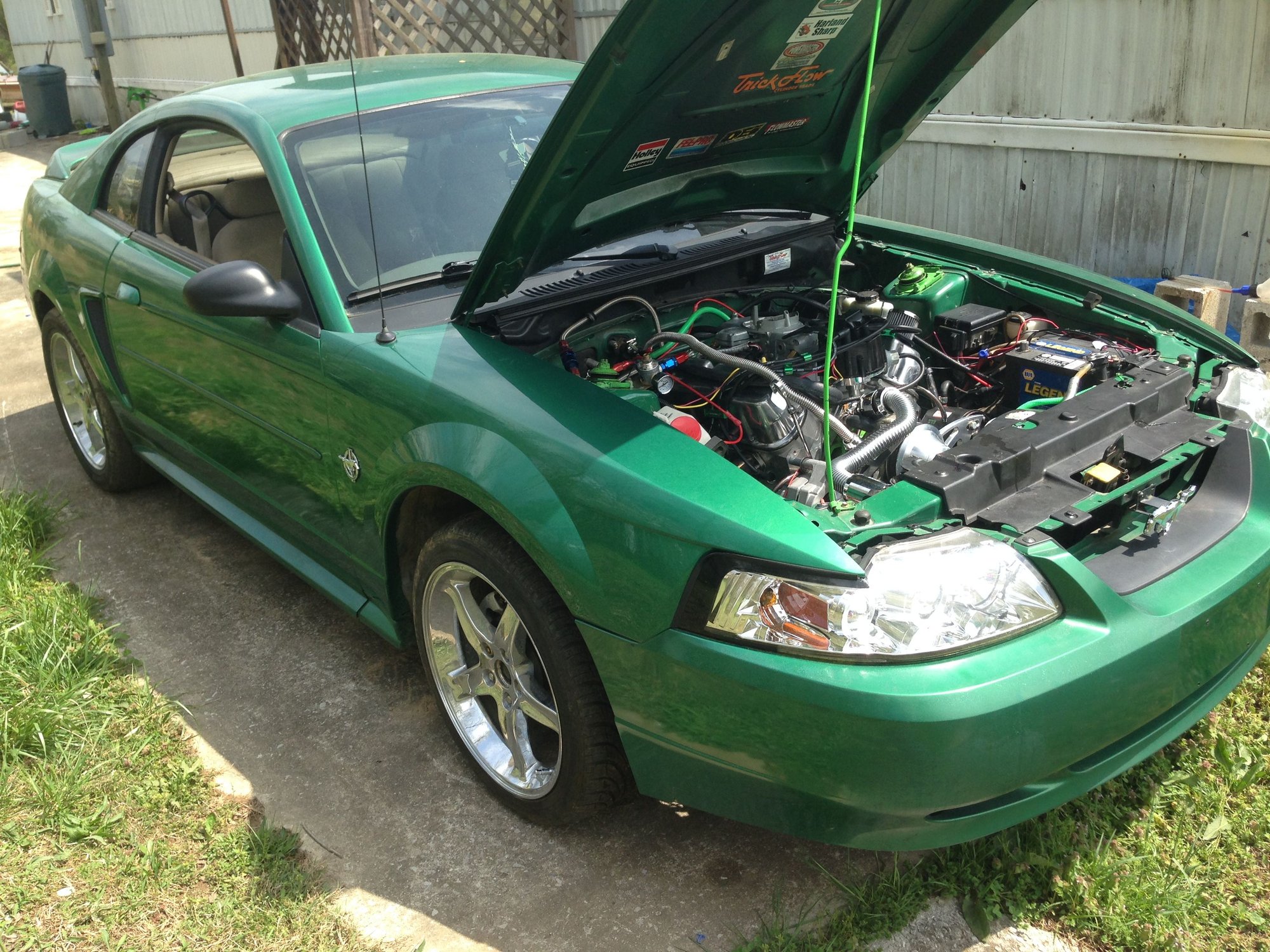

The SN95 stang that I modded and put the 308 into.

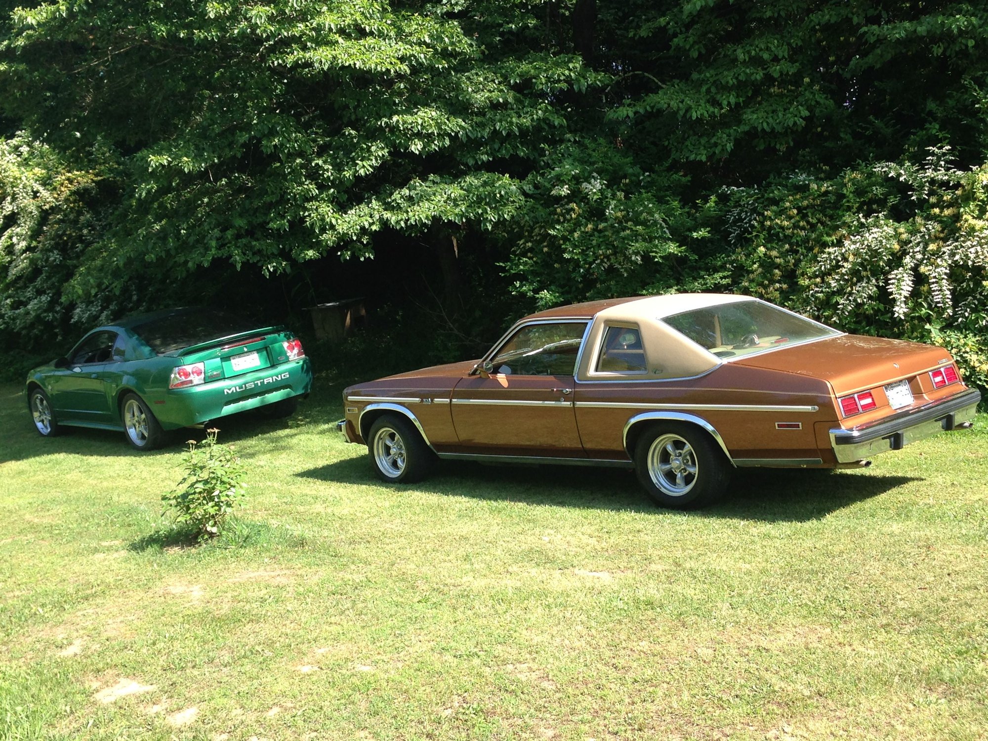

Here's the 1979 Chevy Nova Custom Cabriolet I used to have. 98% all original with only 48k miles. All numbers matching with original build sheet. I'd say not many people have owned cars like these before they were even 21 years old haha! Just thought y'all would like to see!
