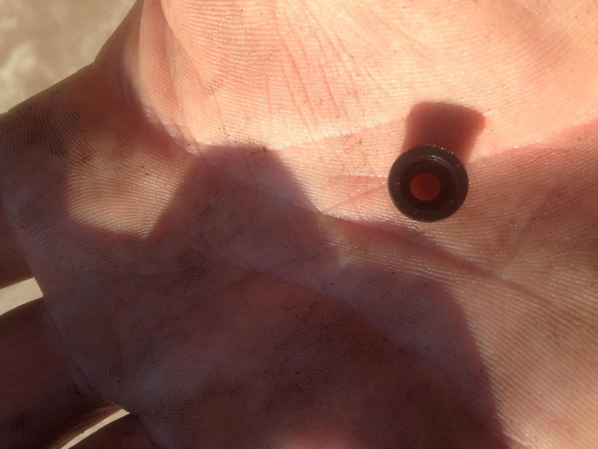

Pictures of what it all looks like after removed
Last edited by ttrawicki1; Feb 16, 2015 at 04:42 PM. Reason: Not all pics showed up

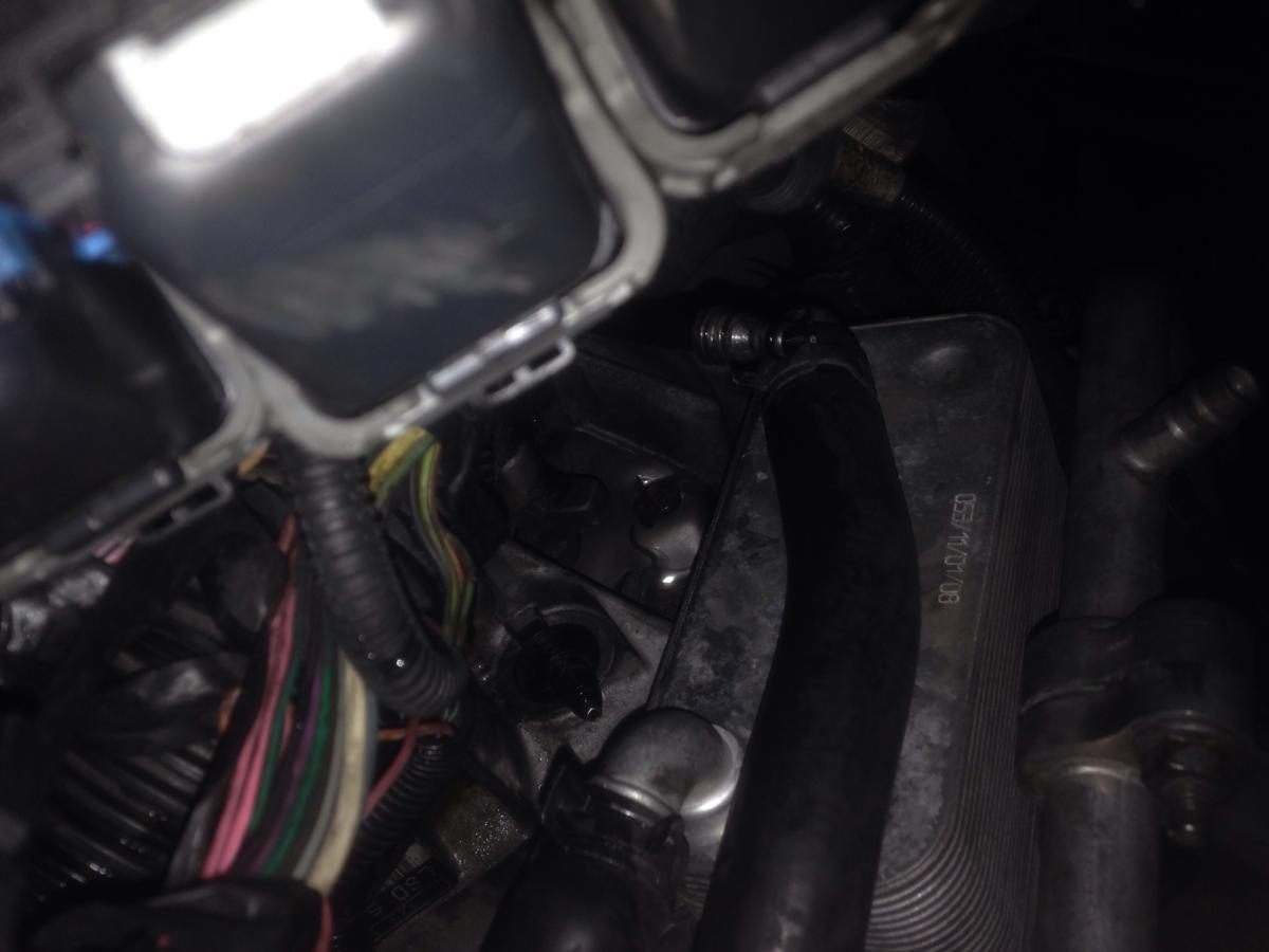

02

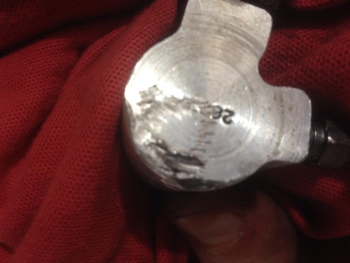

03

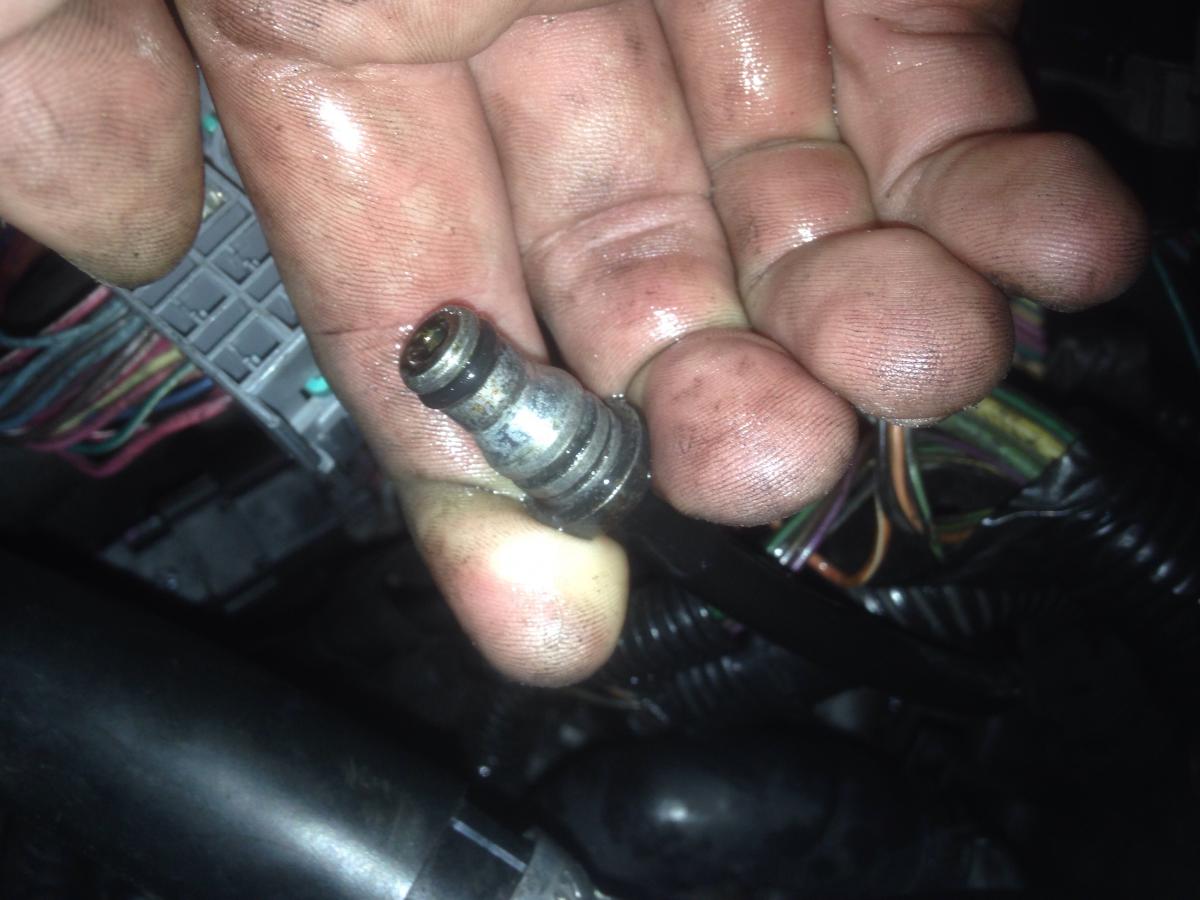

04

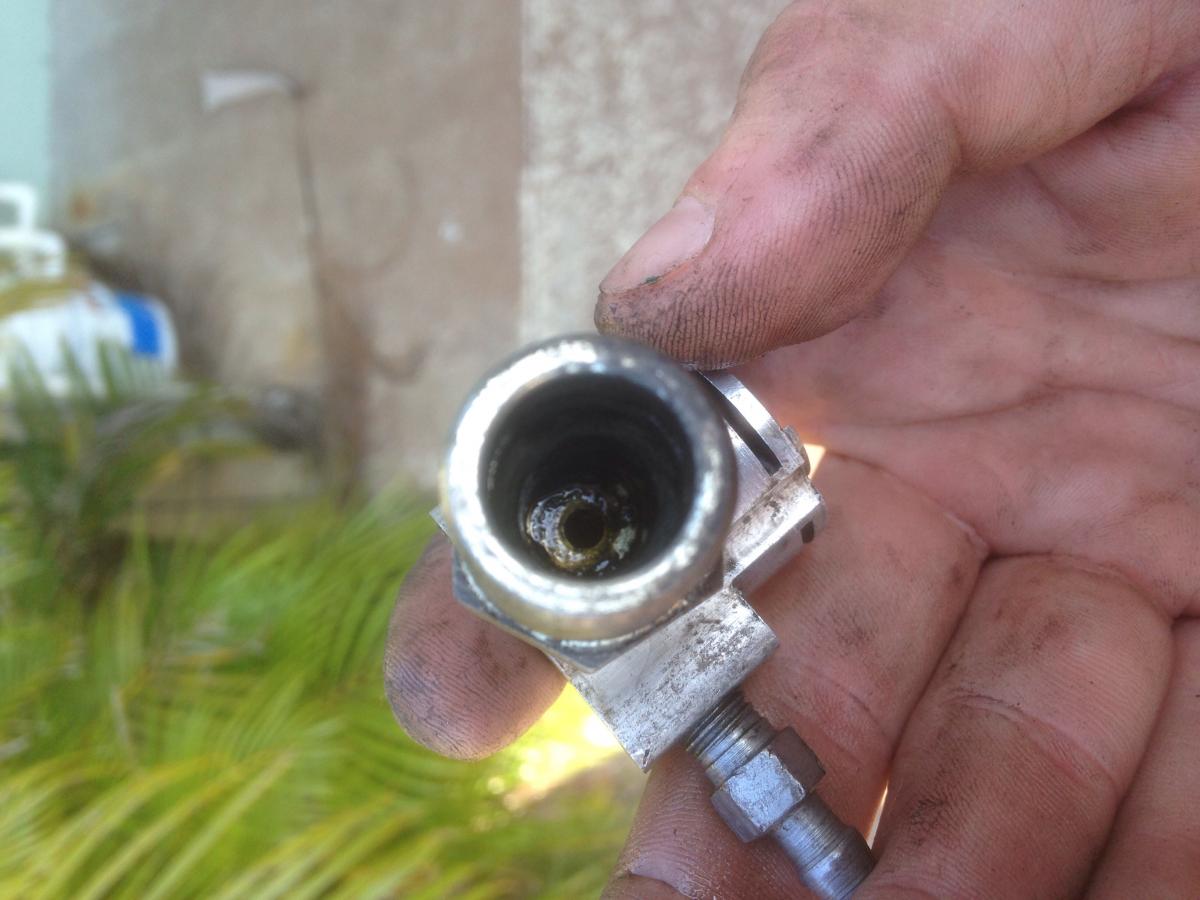

05

Last pic won't upload. This is what all I found when tore it apart though. The boot was stuck in slave actuator elbow. No damage to boot though. If you look in the actuator elbow itself where the line from the clutch master went it's very dirty almost as if it was leaking or something. Does anyone have any suggestions on what I should do or parts I should order?

Is what you're calling the "actuator elbow" the part that's in picture 04? I'm going to call that the distribution block, fyi. The inside of the distribution block definitely looks really dirty. Pretty gross. The seal that you're holding in picture 05 comes with the clutch pipe, whose end is sticking out of the bellhousing. I'd think that would be the seal that would prevent the inside of there from getting dirty. I'm not sure that you can get that seal by itself. The clutch pipe is like $13. I'm not going to tell you that the seal is your problem, but here's my experience with it:

Yes that is what I'm talking about. The only problem is that the dirty nasty part is the part where the line from the clutch master hooks into. Do you think the o ring is bad? I'm not having problems with fluid leaking my problem is air keeps getting in the system. As stated above everything is new in the tranny clutch slave I've even put two oem master cylinders thinking the internal seals are bad but somehow air keeps getting in. I'm stumped. Keep in mind I'm not losing any brake fluid at all. Any ideas? People have stated air can leak through these seals without leaking fluid.

your distribution block is gross......
honestly for what it costs to replace it along with the clutch pipe i do not understand why people dont pay for it. clearly it looks like someone was beating on your block too from the massive gouges in it. remember its only aluminum.
