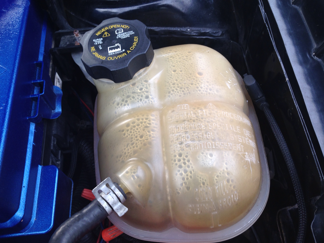

Are these bubbles normal??

Yes. That is condensation.

How can you be certain? Not trying to disagree with you just want to know how to come to that conclusion to be able to tell the difference I guess. Thank you for your reply!

That's all it could be. It's perfectly normal. They're not bubbles, they're water droplets.
This.

When temperature falls below the dew point, condensation occurs.
Cold and rainy out. The lid gets cold and gets condensation.

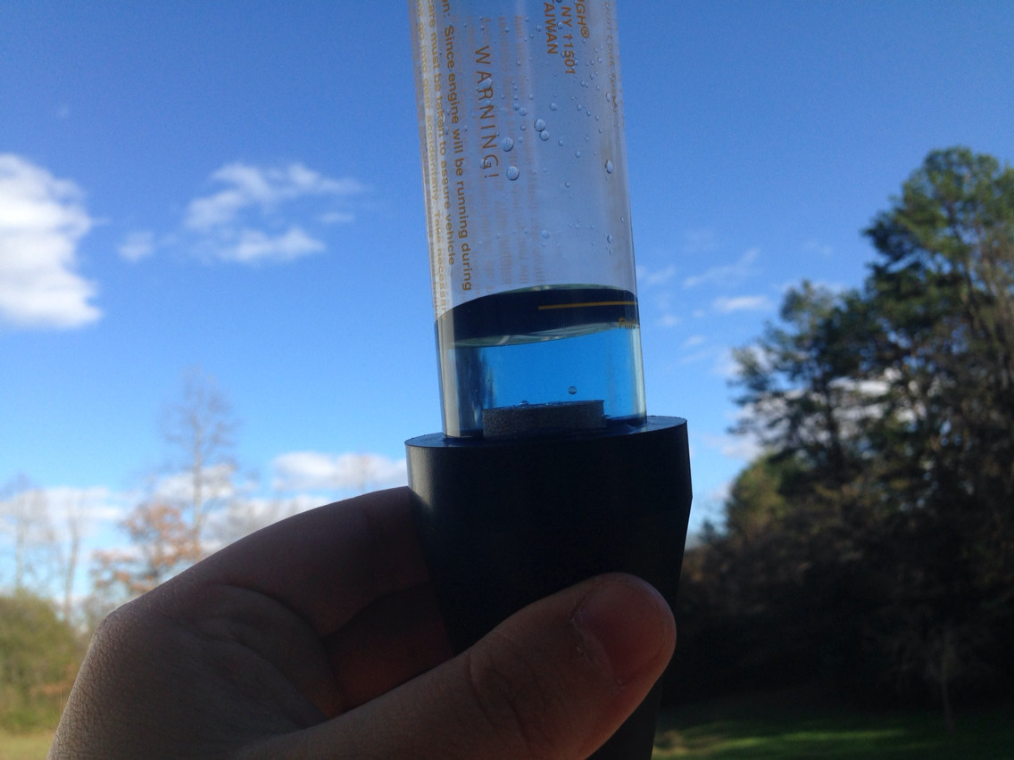

Okay I got the block tester kit (the blue fluid, test tube, and squeeze ball that allows you to test for combustion gases in the coolant system) I performed the test with the overflow tank and did it from cold to 190 degrees and the fluid did not turn yellow. So I guess all is good with the head gasket? While I was performing this test I did hear something that sounded like something "puking" something out but could not locate it (sounded like the overflow?) but I did not/have not seen any leaks. What would be the next step to take to try and figure this out? Help is greatly appreciated!

Test fluid after I performed test.

Okay thanks for providing info on how to post a video. Seeing how it's all of that trouble to post a video I'm not going to bother. Can anyone tell me what I should test or look for now?? It only leaked a pound of pressure out over an hour period of time on a pressure test and the shop said that could've been their gauge not making a good connection, the shop looked for leaks externally and internally by removing spark plugs and seeing if coolant was dripping onto pistons, and it's passed the block tester test. Some help on what I should do next would be greatly appreciated.
