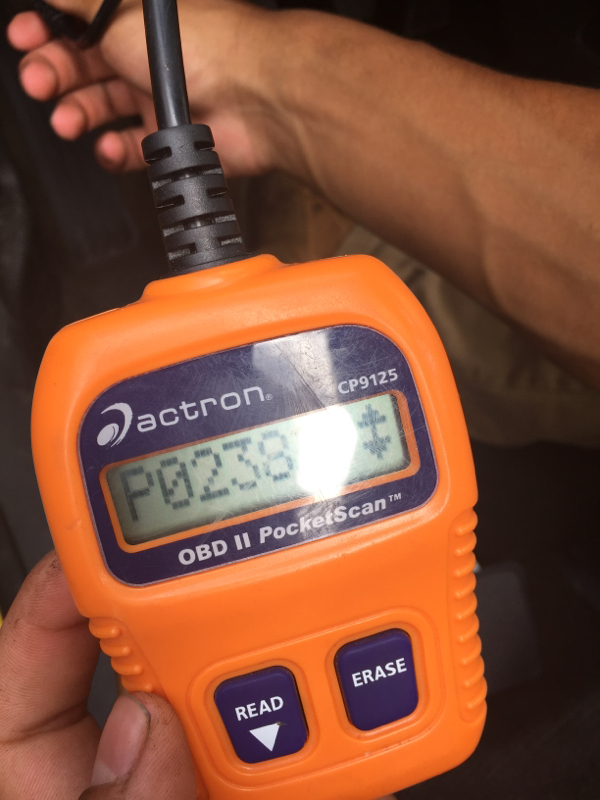

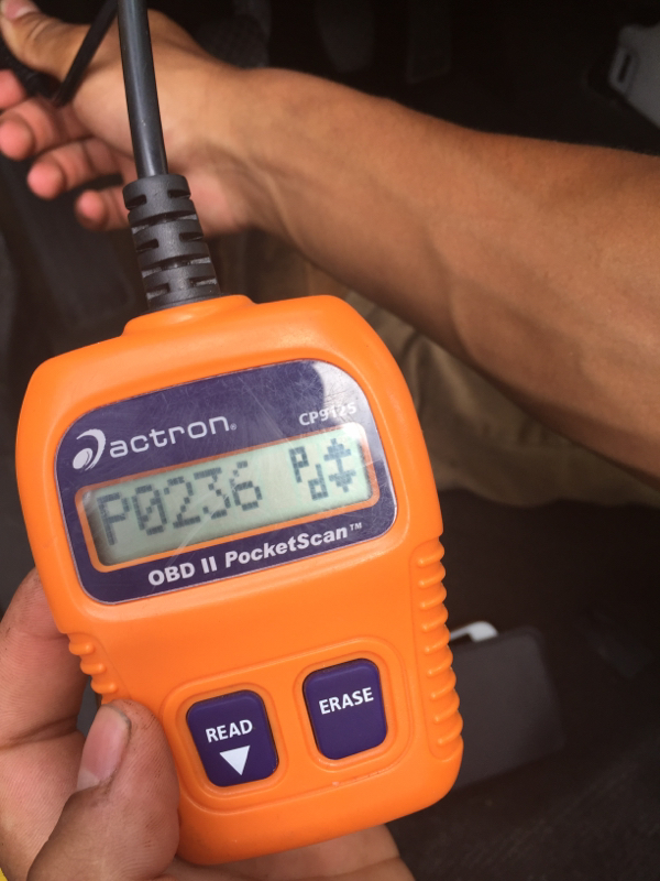

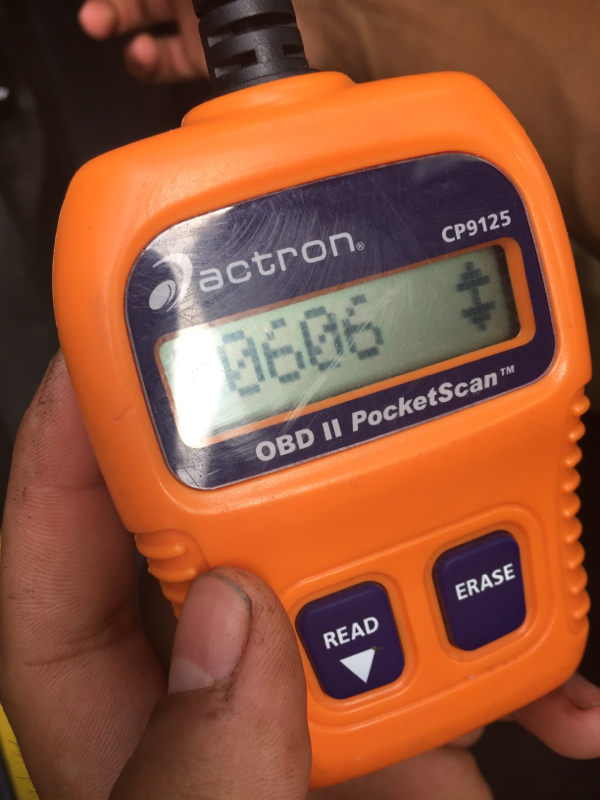

Here are the code guys help
Attached Thumbnails image-871385152.jpg   image-3987715847.jpg   image-2380680687.jpg
Attachment 9288
First make sure your battery is good. ECU needs good voltage.
P0236 and P0238 are for MAP sensors usually. Clean them maybe.
P2261 is something in the Turbo bypass valve system. Check all of the hoses for the BPV system. All you could try to vacuum tank delete to see if that's the issue.
P0606 is computer related.
You have two options. Reflash the computer with the correct tune or replace the entire ECM (computer)
I'm in the process of doing the same. With that said you can order a new ECM from ZZP for cheaper than the dealer will charge you obviously. Install shouldn't be too hard. ECM from ZZP is about $400
Could these all be related. Maybe if there is a wiring or bad ECM problem.
