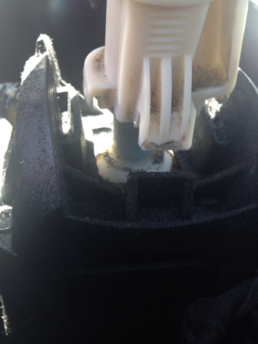

Is this the correct way for the plastic reverse lock out thing to be installed? It can go on two different directions, not sure if it matters? Also is that as far down as it goes?
Thanks

Here's the pictures.

Been a while since ive seen an oem shifter but i think the off white piece needs to be turned 90 degrees counterclockwise
Old May 30, 2016 | 11:10 PM
Yeah I think your right ^ best way to find out if you did it correctly will be if your reverse lockout still works

The reverse lockout part should be installed facing the passenger side of the car... not the rear of the car like you have it in the photo. You need to rotate it or your reverse lock out will not work.

The white piece only installs with the tab facing the front (opposite of the picture) or facing the rear (just like in the picture) which is right???

The way I have the white plastic piece in the picture is correct. You put the white plastic piece as I have it, and lock it onto the black plastic piece on the shifter boot and then install it onto the shifter rod, in case anyone needs to know in the future.

The reverse lock out is C shaped and fits in the black tab thats on the black base.
The C fits over the tab when you go into 5th.
The easiest way to figure it out is to go through shifting and see where 5th gear lands with and without the reverse lockout engaged.
Hold on let me photoshop the tab for you. As said above it appears the white part of the lockout needs to be rotated 90 degrees for the C portion to go over the black portion in my pic.

It's impossible for it to rotate 90 degrees. The white piece only goes on the shifter rod two ways, not all 4. In other words, It can rotate 180 degrees, but not 90. There's a tab behind the white piece the way I have it installed now. The reverse lock out and all the gears are working the way I have it now so I guess it's right? Someone take their shift boot off and post a picture of how their lockout is installed please to confirm that I have it installed correctly, which I believe that I do.

This is what I had originally said. But wasn't in the mood to argue... plus now I have the OTTP short throw installed.... so cant really take a pic of my stock one installed anymore.

There's no way that I have the lockout on wrong. It only goes on two ways. It will not go onto the shaft any direction. If I change the way I have the reverse lockout now, then it won't engage into all of the gears due to the plastic piece being positioned wrong and not allowing it. For instance if I rotate where the plastic tab faces forwards it will not engage into first gear at all or not easily.
Not sure what's being said in this thread about arguing etc. but the truth is that this piece only installs two ways, both of which I have mentioned. The way I have it now, as shown in my picture, works fine. I appreciate all of the help from everyone.
