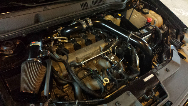

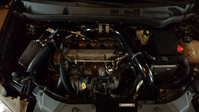

It was my buddies car he hit a animal so the front lip fell off and he couldn't find it. I got it for a good price $9600. because the boost cuts in and out. it is tuned with the cruise control, to push the cruise control in its 22lbs and 15lbs when you push the cruise out I'm not sure whether to take it to ZZP to get the boost figured out or to take it to the Chevrolet dealership ABS LIGHT ON FROM FIXING WHEEL BEARING also.
Help....

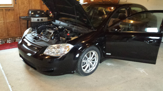

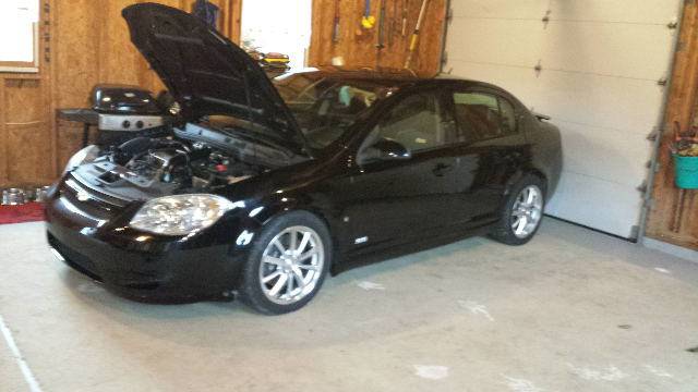

It is a black sedan and it's never been in a wreck. Just cleaned the whole car engine bay and interior/exterior. Currently sitting in garage waiting to fix it

It's throwing like 7 different codes. Most are Evap... I pulled the 02 sensor off from the intake to see if it was gummed up or anything that looked fine.. Idk what it would be. It has Hahn upper and lower charge pipes

Could be the evap purge solenoid or went valve too
Post up the codes

I'm taking the purge selanoid off my buddy's car to see if that's it. I hope it's a Easy fix. Anyone change a wheel bearing and have the abs light stay on afterwards?..

Took off the purge selanoid blew in it and it doesn't seem to be bad. So that's not the problem Idk what to look at next someone help?... Some said the valve?.. How do I check that
