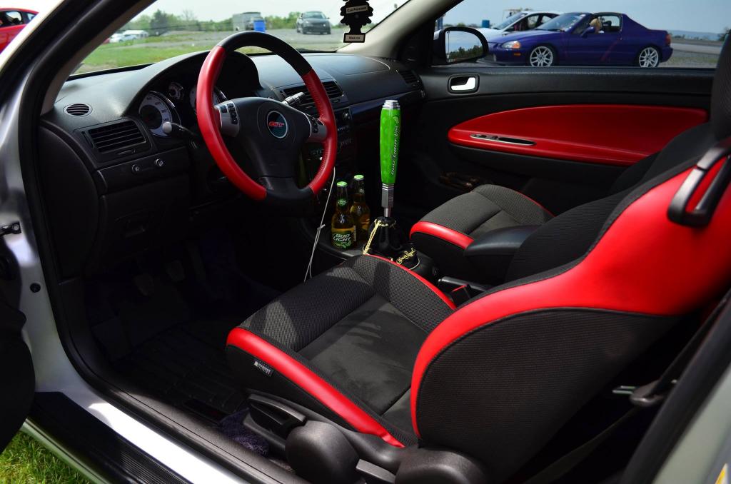

Old Aug 3, 2014 | 12:37 PM
royce777's Avatar
iTrader: (29)
Joined: 06-28-08
Posts: 9,418
Likes: 222
From: Pittsburgh, PA
Originally Posted by rains_crusader
You put in a Sky wheel right? your airbag fit as it should?
yes i have a sky wheel in my car. yupp my air bag fits perfect

Old Aug 3, 2014 | 01:22 PM
rains_crusader's Avatar
Joined: 05-19-13
Posts: 459
Looks Sweet! Are you going to paint match your steering wheel bezels with your dash trim? Your shift knob is pretty awesome too!
Old Aug 3, 2014 | 01:40 PM
royce777's Avatar
iTrader: (29)
Joined: 06-28-08
Posts: 9,418
Likes: 222
my dash trim is CF id like to do my steering wheel controls and door bezels in CF one day
