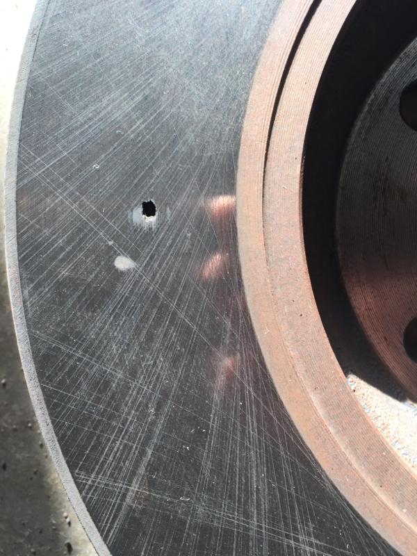

Well, after swapping hubs and driving for the last week, I was still having an issue with brakes pulsating and feeling a wobble in the steering wheel. It felt like a warped rotor but the rotors I installed were brand new. I thought maybe it was still air in the line but after thinking about it, air in the line would make for a soft, spongy pedal. I decided it had to be a rotor or caliper issue. I tore everything down and found the problem. image-1926909404.jpg Looks like a casting defect in the steel. That wasn't there when I cleaned the rotors prior to installing them. It's a hole in the damn brake surface!! It appears there's another void just below the surface near where the hole is. I can feel a dimple in that other spot. I contacted the company I purchased these from to see what could be done. In the meantime, I went out and bought a different rotor and reassembled everything. Finally, no more brake pulsation! They feel nice and firm and all is well!!

thats crazy must of been a bad batch

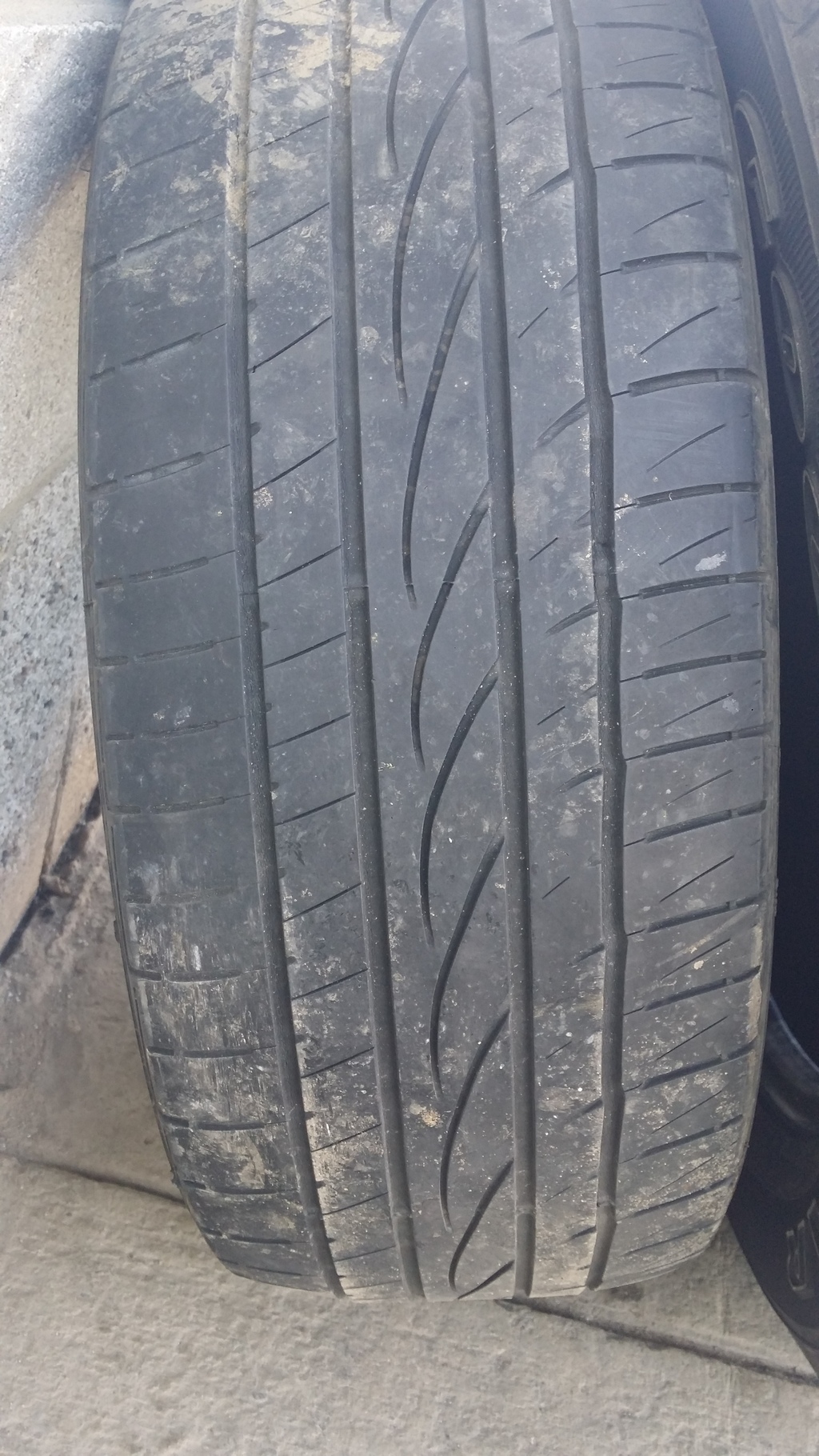

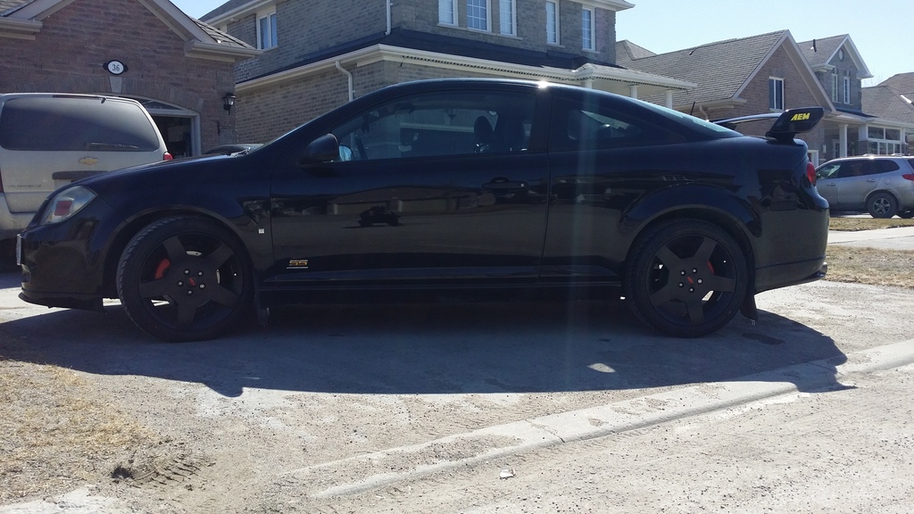

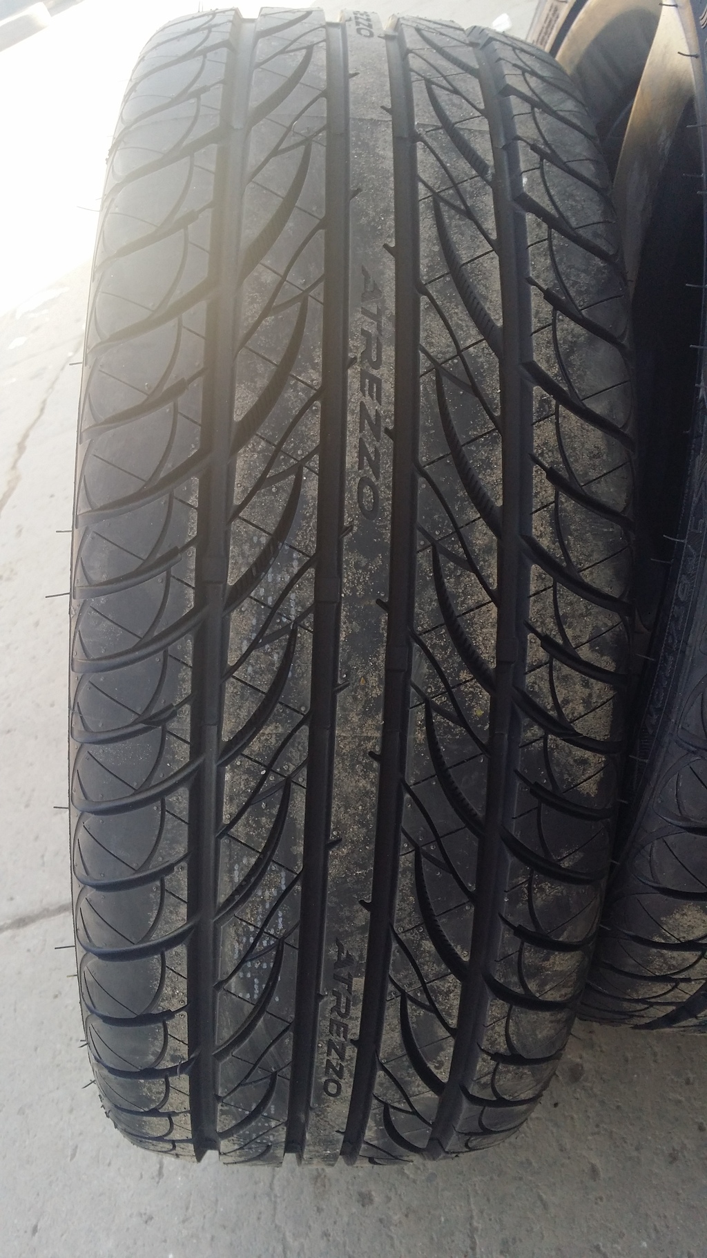

Got new tires mounted, and put summers on.
Went a little wider and fatter. Went 225/45 from 215/40 for a little more comfort, and to fill in the wheel wells a little more since I won't be going lower any time soon.
I don't think I could handle my 100km daily commute if this thing was any less comfortable, and coilovers are out of the budget right now.
Rubs a little if I hit a bump while turning at full lock, but otherwise good so far. Its just the mud flaps. They're coming off soon anyway.
The tires are just cheap Chinese branded tires, but they know it, and are out to be the best of the budget market.
http://www.auto123.com/en/auto-parts/sailun-tire-comparison?artid=149217
So far I like them more than the falken ziex 912's they replaced, but they only have 15 km's on them so we'll see.
Old Tires:
New Tires:

Car looks good. I love black on black
