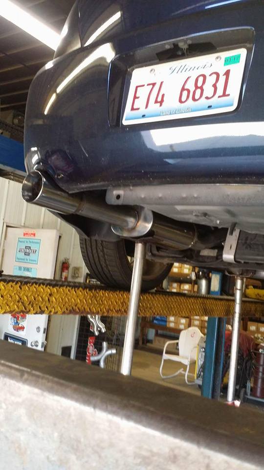

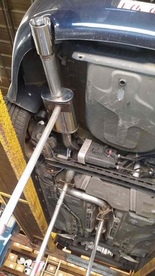

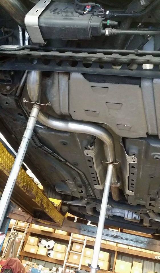

Well its 3" dp with a muffler delete now. If its to raspy or loud it will go back in and get a glasspack resonator. Wont know until tomorrow when I pick it up.
EDIT: its really quiet about as loud as it was with the stock dp and muffler delete but it has a real nice deep tone to it. Really not sure if I like it or not.

Its done think I need to change the tip to angled tip but other than that I like it.

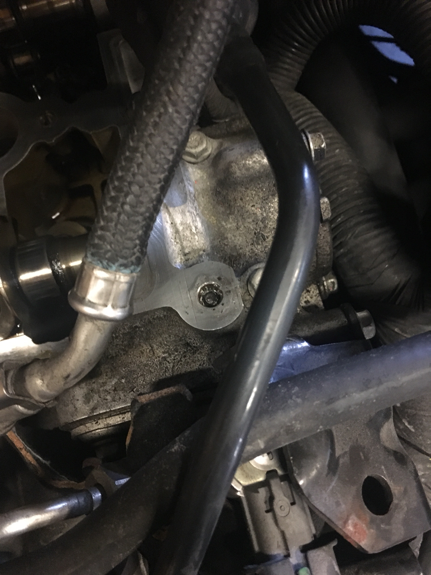

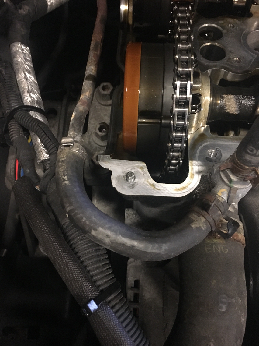

Removed these 2 bolts I tried to torque to 71 FOOT LBS photo935.jpgphoto287.jpg
Heads up for anyone reading this...your vc bolts should either just be slightly tight with a wrench or tightened to 71 INCH LBS or 8 FOOT LBS

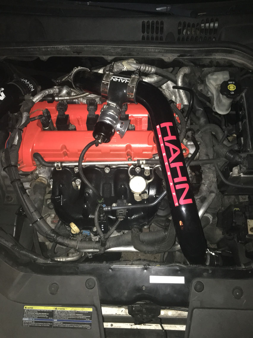

Painted the intake manifold

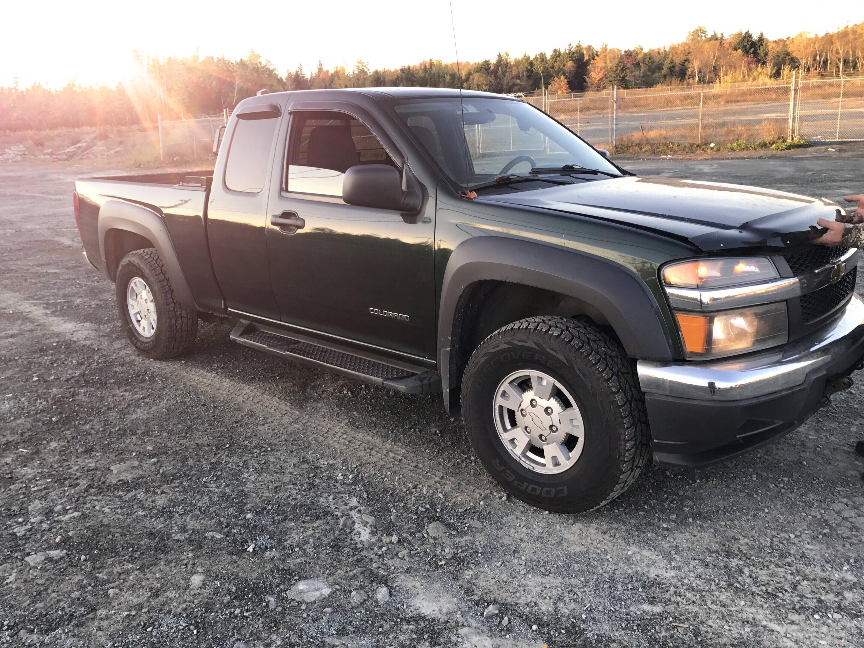

Parked it and picked up a new winter beater, 05 Colorado 4x4.

what motor?

Yeah I've been reading a bit on there already, it has the 3.5 5cyl. I've already read about the head issue stuff, seems about as common as porous block on the lnf.
Truck was cheap enough to not worry too much about it.
I think next spring I'm going to try to sell the SS and this and try to get a 16/17 Golf R.

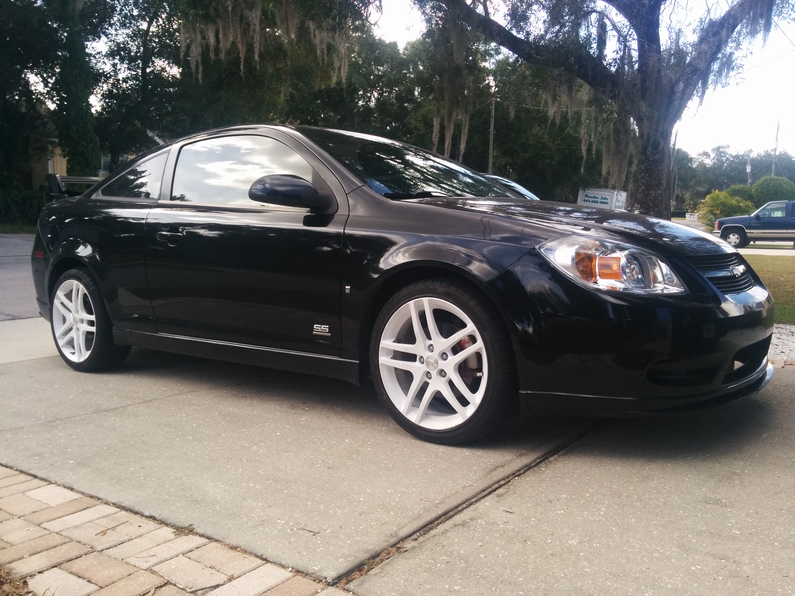

Found some lnf wheels on the cheap that were banged up. Spray painted them white and slapped them on. It'll do until I either powdercoat these or get something better.
