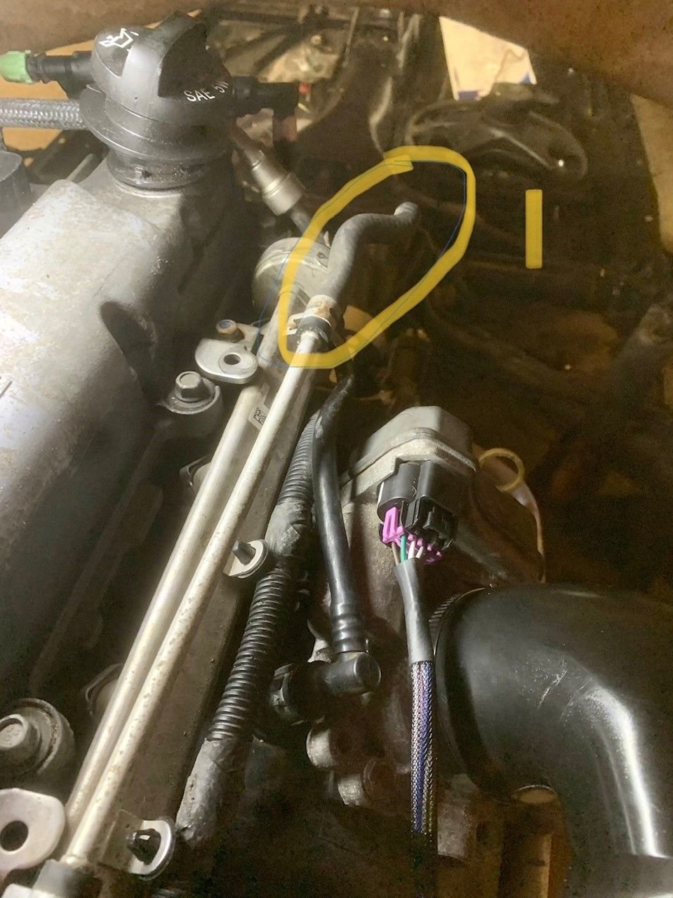

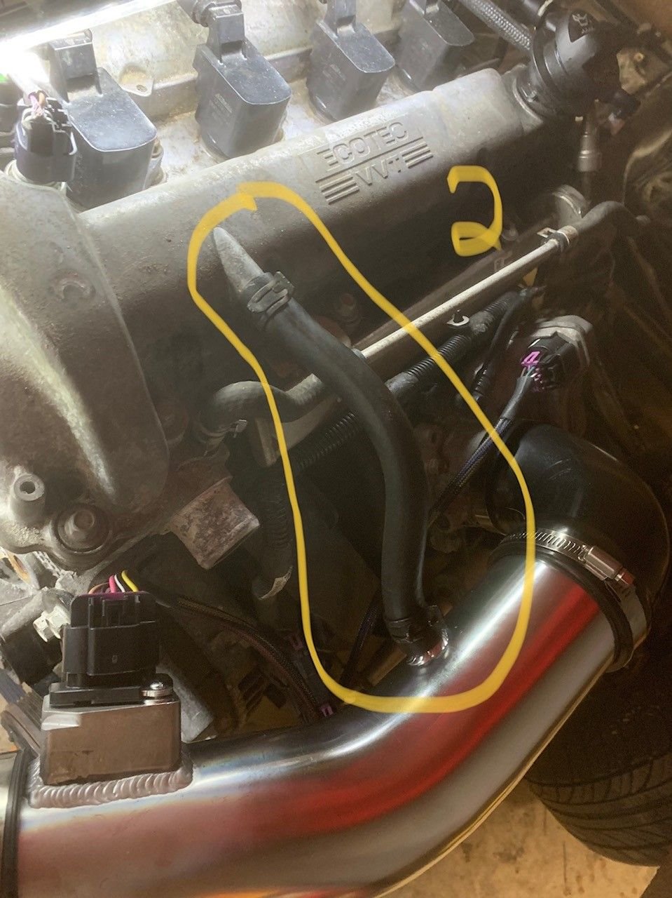

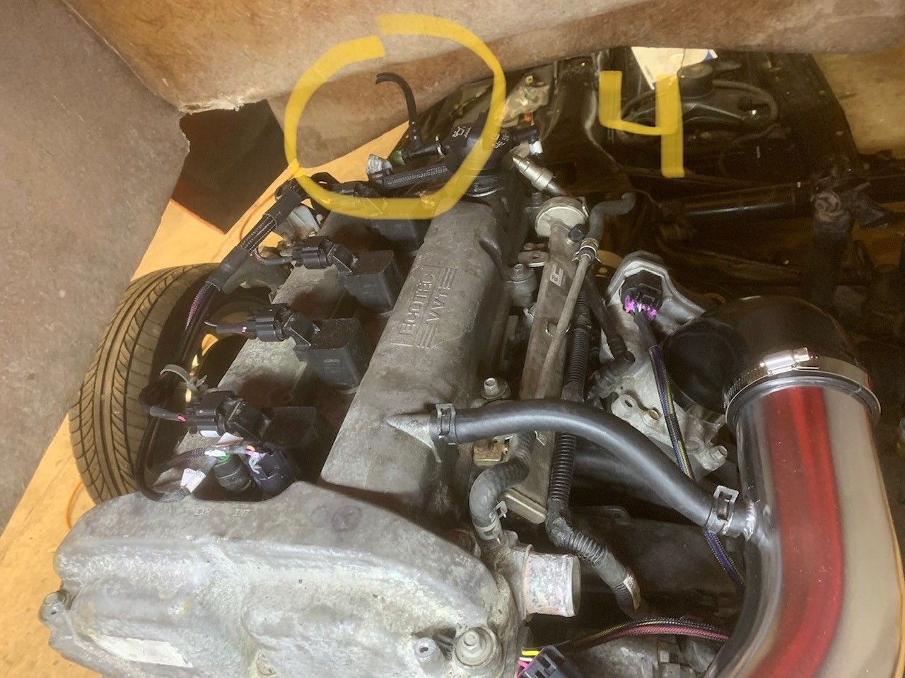

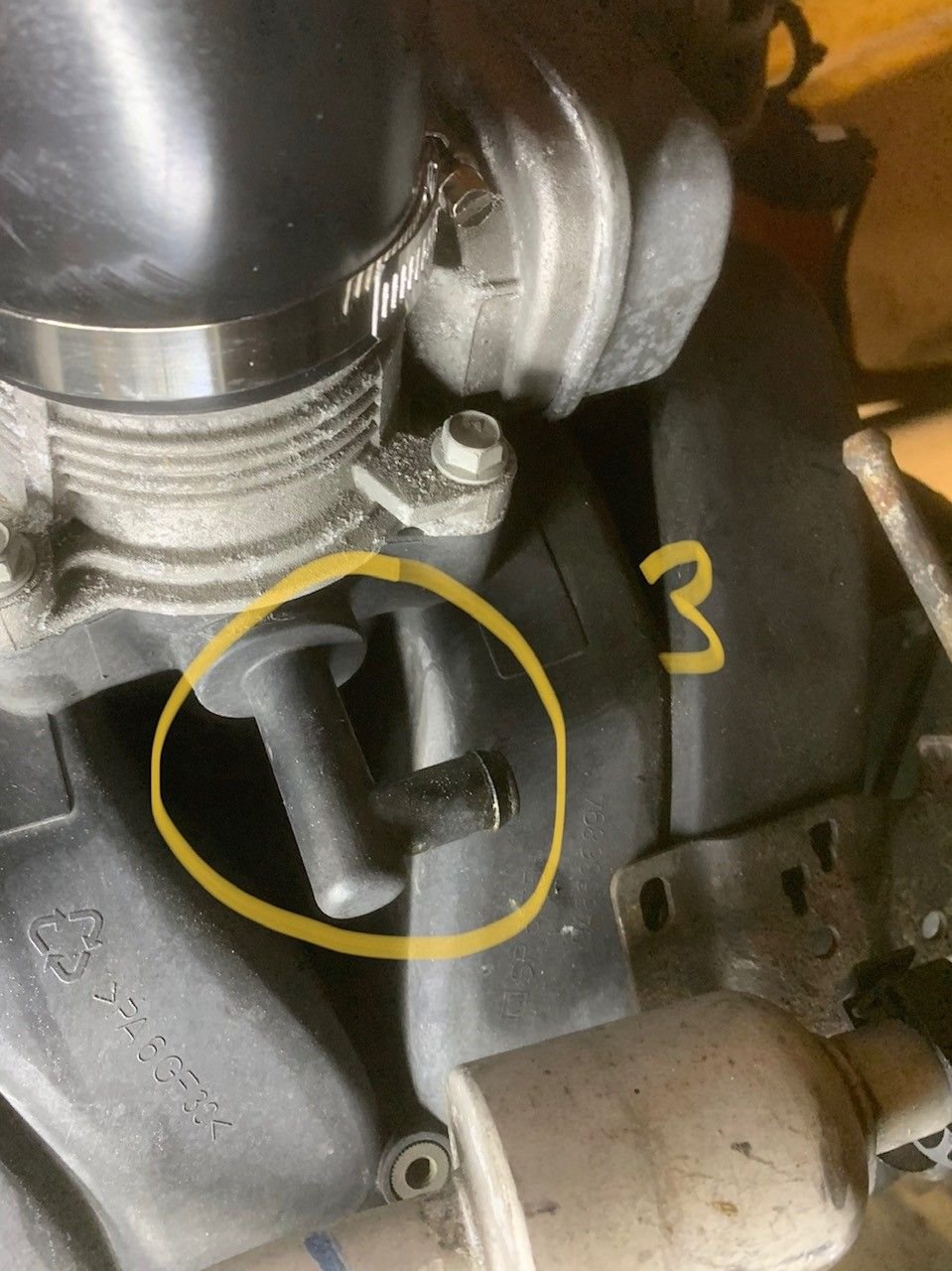

Hello All,
I'm a recently picked up a cobalt SS engine to put into my GT-40 kit car. I'm trying to figure out if i have these lines correct and where they may go, Thanks so much in advance. JP
#1 - I would assume goes to the overflow tank
#2 - I'm not sure if that goes there but it fit
#3 - I'm not sure where that would go unless I have number 2 wrong
$4 - EVAP but can i just eliminate the whole think and cap it off at the throttle body?

1 - Correct. Coolant overflow. Can be blocked off (m8 x 1.25 x 16mm bolt) but will make it hard to bleed the system
2 - Perfect unless you added a turbo
3 - Goes to the brake booster if running power brakes which I doubt you are
4 - Correct. Get rid of it. Cap at intake manifold.
