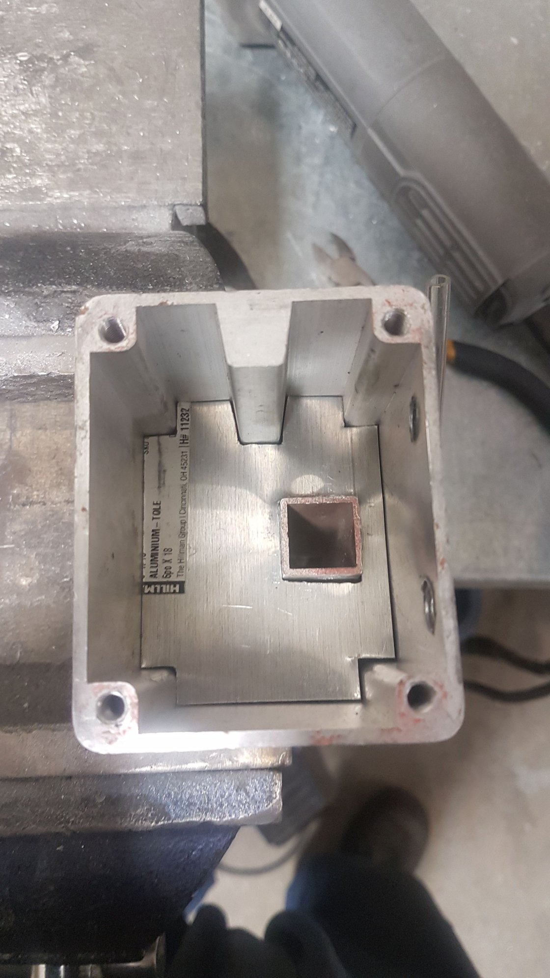

First The Can: From the inside you can see that it is not perfectly square.

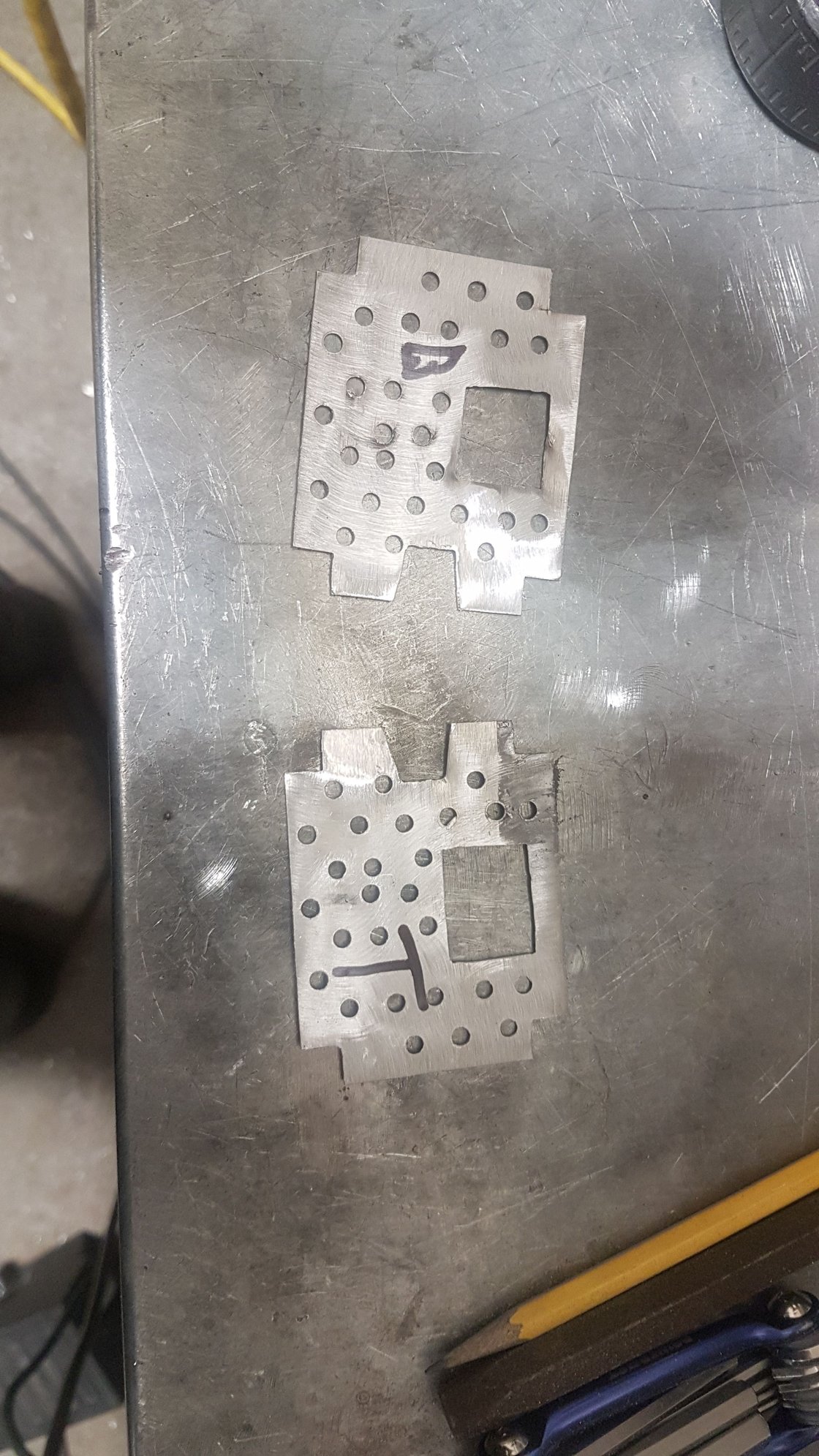

2nd The baffles: I started off making the baffles square then I cut the corners and middle section to fit.

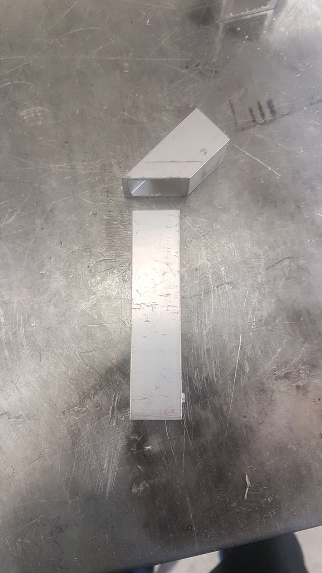

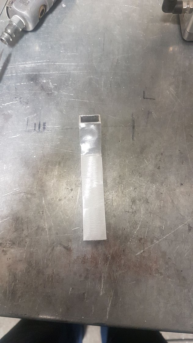

3rd The separating tube: Next step is to get a tube to bring the suction point to the bottom of the can but more importantly underneath the baffles.

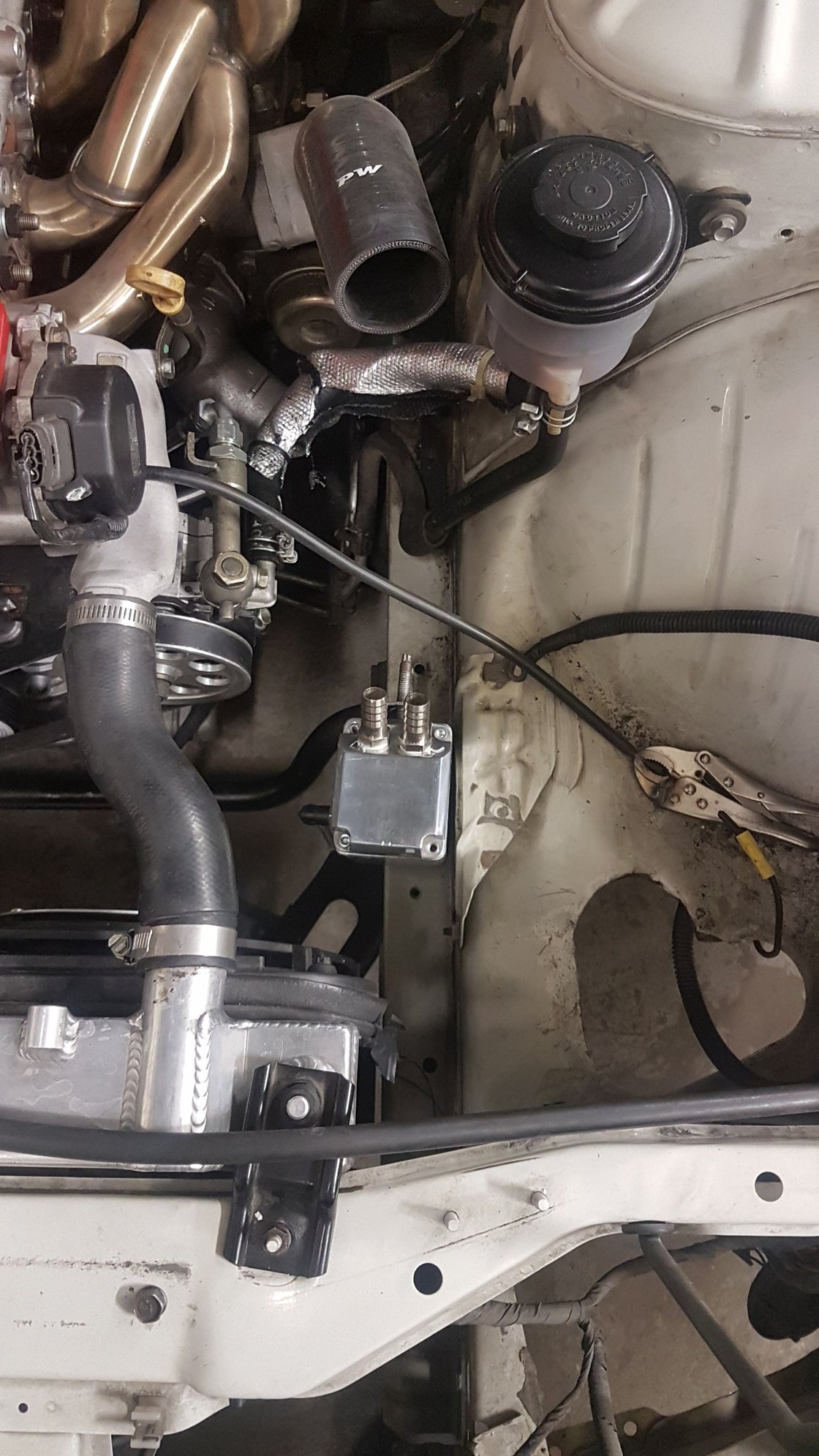

Final step mounting: For the mounting I just bent up some 12 gauge sheet to make an easy stand off bracket.
Final thoughts: If you have the ability and tools to do this project it is possible to save some money. With that being said it took me around 7 hours for me to mod this can, It was not for me so he did save some cash but in my opinion I would just buy a proper one and save the time.
