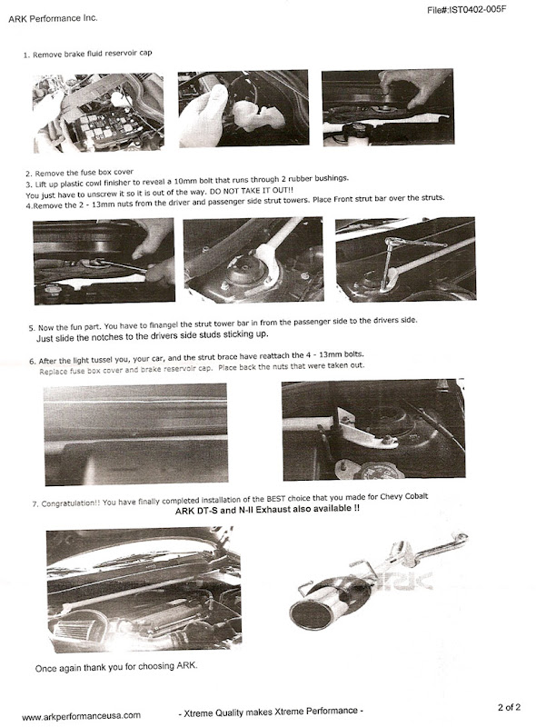

so I got my Ark strut bar today and the instructions they included look a bit familiar...
Old Jan 2, 2009 | 10:53 PM
  #53
Dead Zen's Avatar
Joined: 05-19-06
Posts: 6,982
From: Beaver, PA (outside Pittsburgh)
oh snap. 1 and 2 are my pics. bastards!

I got my ZZP strut bar today, at work Get some and install in 20degrees bitter cold 15mph wind.
Old Nov 30, 2011 | 04:54 PM
  #58
bratboy90's Avatar
Joined: 06-12-11
Posts: 1,118
Likes: 12
From: Elk River, MN
Just noticed if you look at the order they put their pics in, the cap is already gone. LULZ
