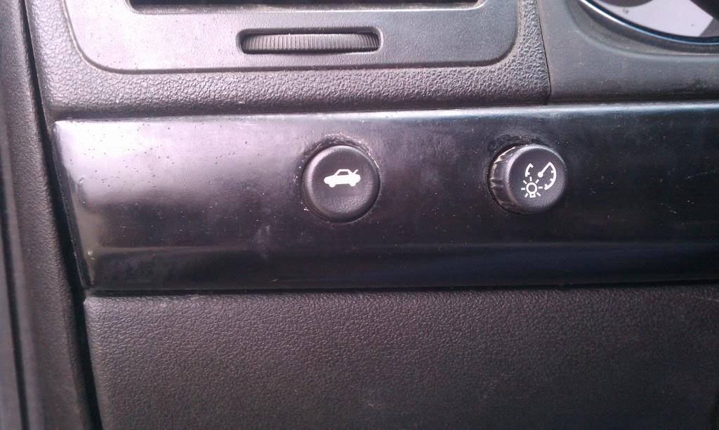

I went through this how to guide because my trunk button wasnt working.. I checked the wiring it wasn't working. I went under the hood and replaced the 20amp fuse. the wires touching together worked. At this point I realized I could mess around.. I notice the fog lights button is the same size, and I don't use my fog lights; I removed them. I simply popped out the fog light button, and plugged the entire trunk button fitment into it's new home:
