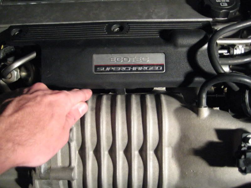

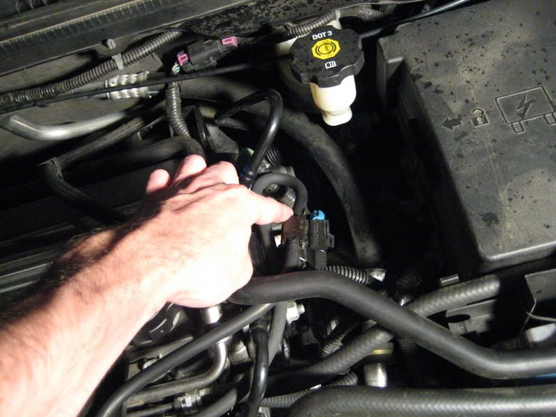

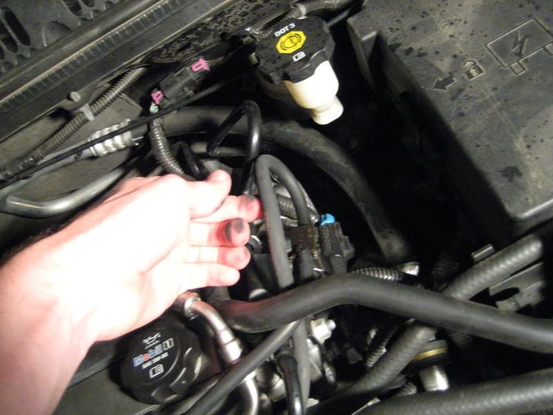

Finally, you are going to remove a vacuum hose under the hood, here are some pics of it-
This is where you will remove it-
here is how it runs-
Now start up the car, and it will sound off and might sputter a bit. This is OK. Next hold the hose up and you should feel some suction, begin to SLOWLY pour the remaining 1/3 into it. I mean, drizzle it in there, take your time. If the car is not cooperating you may need someone to hold the revs up a bit, mine kept running though.

what vacuum hose is that
Old Jun 22, 2008 | 01:47 AM
hatrickstu's Avatar
Joined: 05-03-05
Posts: 15,395
From: Ar-kan-sas
what do you mean?

Went ahead and tried it today. Your guide was most helpful.
The hose was hard to pull out but i figured it would be. I loosened the bolt that holds the bracket for it, giving me another angle. Then pulled it out with help of a flathead.
I think the car sounds a little bit quieter now. Either way I saw lots of smoke for a long time.
