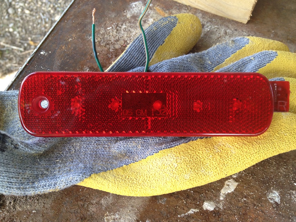

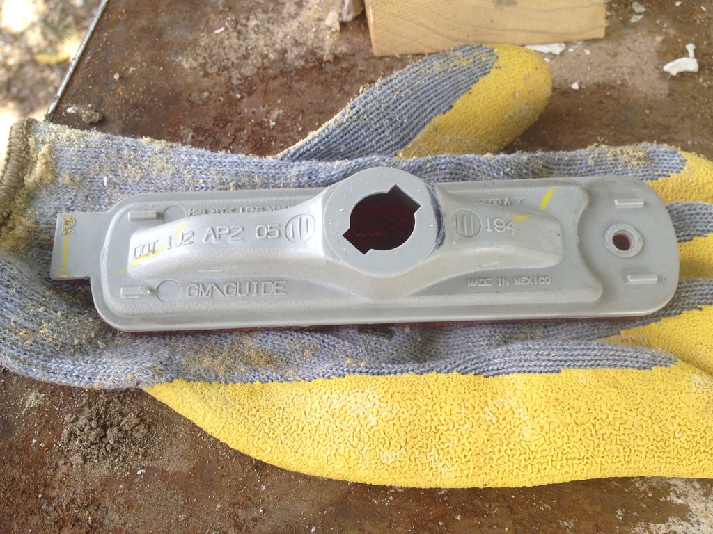

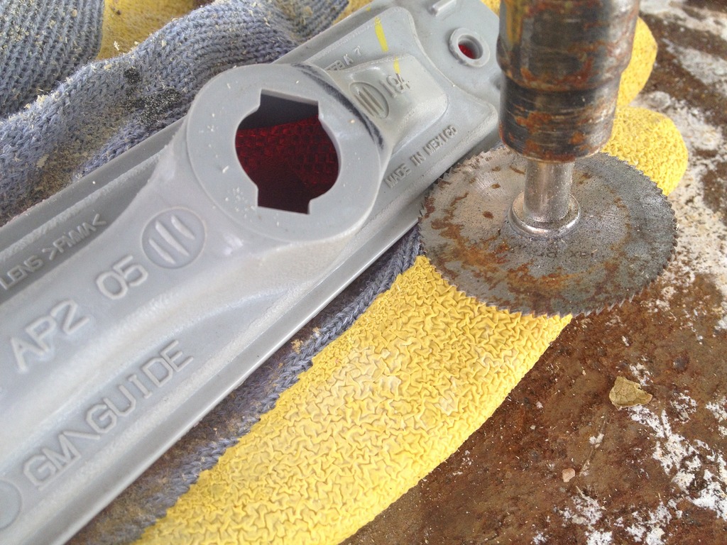

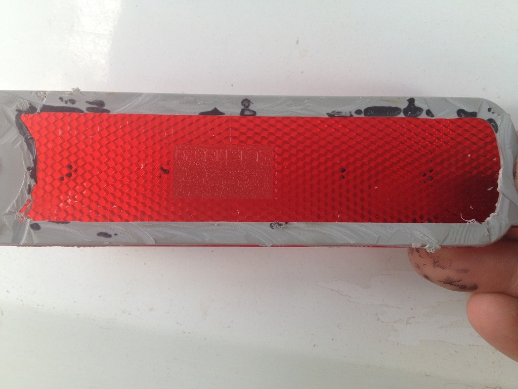

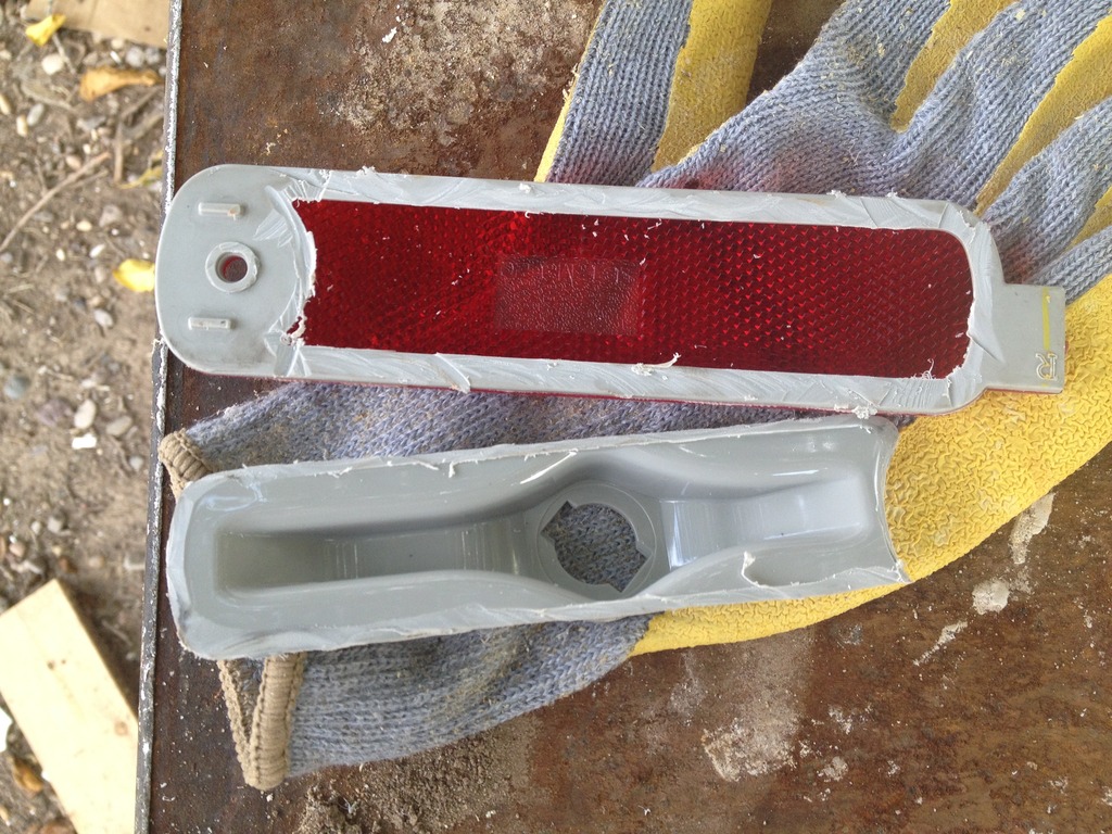

STEP 2: Cut open your side marker. Don't be a pansy. I've found that cutting it horizontally this way makes it way easier later. So cut it horizontally.

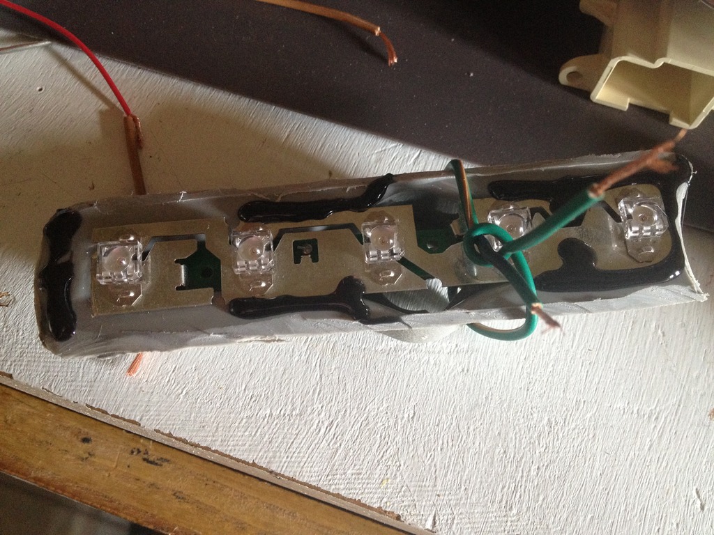

STEP 4: I'm assuming you saved the pigtail from your Impala brake light right? If not, you can solder wires to the prongs on the LED board. That's what I had to do with this one. The prongs are marker + and -, so make sure you know which is which. SO! Stick the wires through the light socket and glue the LED board down. If you're using E-6000 like I told you, this thing is NOT moving. Don't F*** this up. Get it on straight now or you're stuck with it crooked for eternity. The LED board should sit perfectly flush on the housing. See?

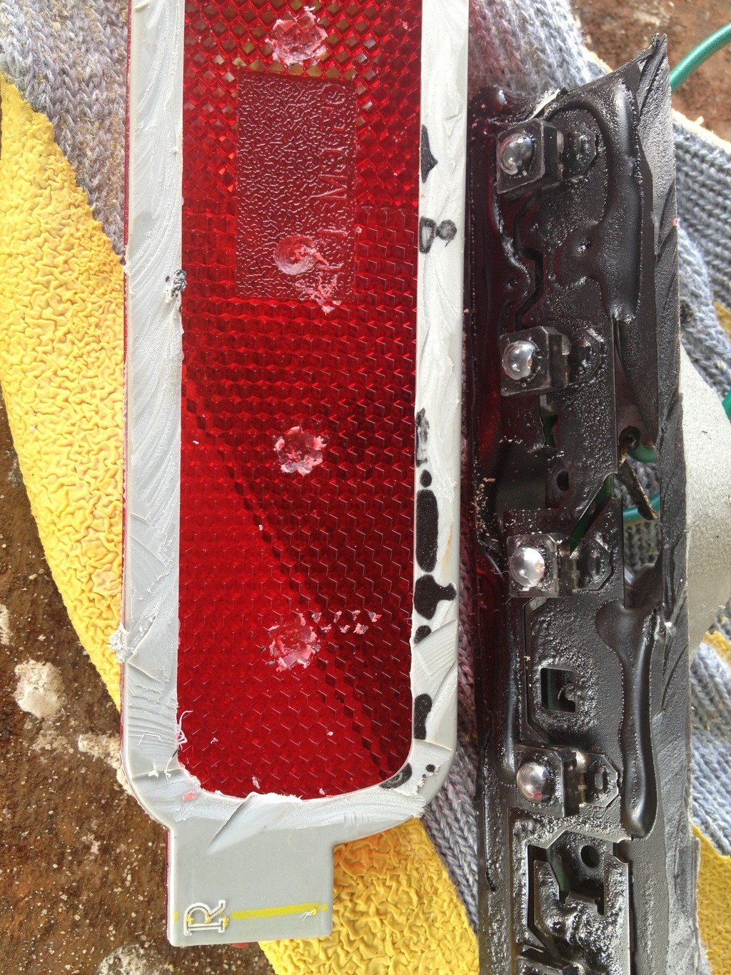

STEP 5: Now you need to make indentations in the lens. THIS STEP IS REQUIRED. YOU CANNOT SKIP IT. The factory lens is purposely built to fill the entire housing with the light from a single bulb by reflecting every which way. If you put the LED board in without making distinct indents for light to collect in, it will look terrible because you won't be able to make out each individual LED, except for the center one. That looks retarded.
To mark the spots I needed to grind, I sprayed a HEAVY coat of Plastidip on my completed LED housing/board. While the paint was still wet, I pushed the marker light assembly back together. The face of the LEDs touched the lens just enough to leave a small mark where I would then need to grind. Then later I could peel away the Plastidip from the LEDs.

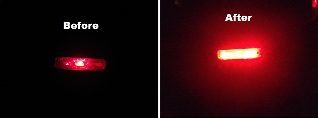

See how pathetic the stock marker looks compared to the LED one?
