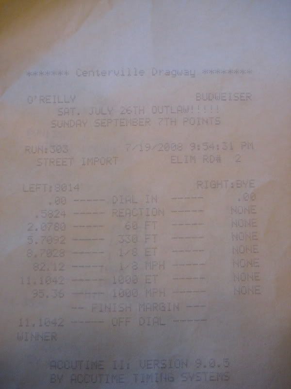

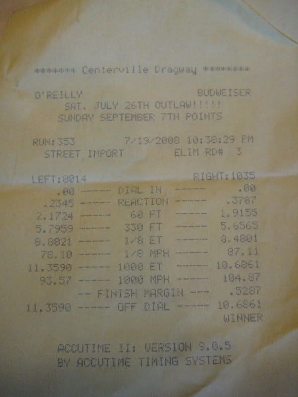

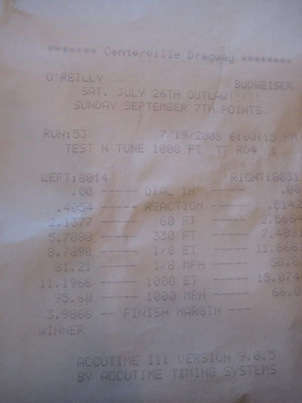

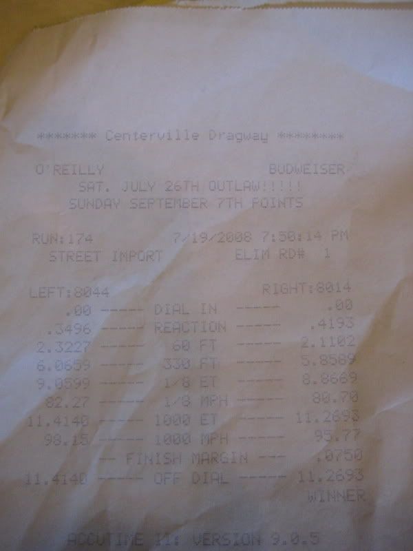

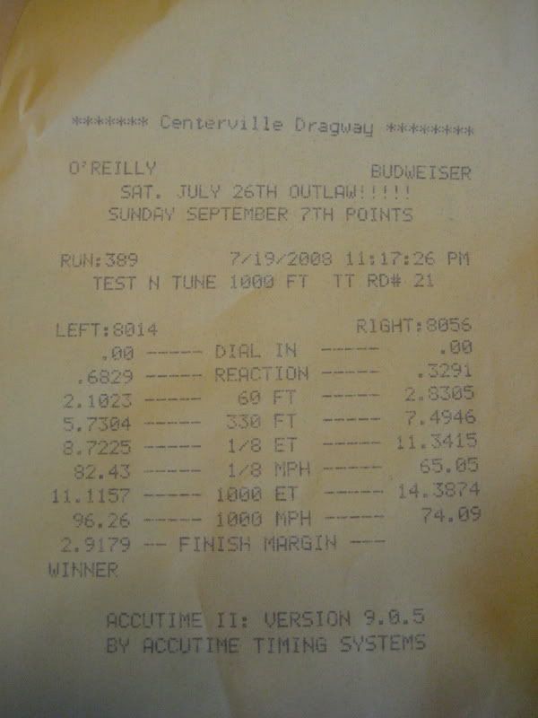

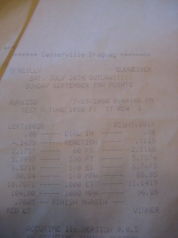

Ok so I had the box in with V2.3 firmware on it yesterday and got a pretty good impression of the box. First off, at 2,400 i can get it too hook pretty well on street tires. Now the track part.
1000 FOOT TRACK
This was on 18 inch BFG dr's. Started with the 2step at 2,600, hit hard then bogged. 2,800, hit hard then bogged. 3,000 hit hard, then started a light spin, stuck with this. Oddly enough, all of these runs were 2.1 60's. Not great, but it def. showed potential. Best I managed was a 2.07, with the box at 3,000 and a very quick clutch release. I could have easliy reached 2.0 or below, but after the initial hit the car would start a light hop/ wheel spin. Could have been track conditions, or the spring spacers i wasnt used to (after watching vids, they need to be extended more, still squating), so I will just keep woking on that.
However, something was really off with my traps in the front half of the track. All night they were 3-4 mph slower than usual. I went back and looked at nearly identical 60 foots, and all my times from last night are 3-4mph off and 1-3 tenths off. Almost like the car was pulling timing on the front half because of the boost so low or something. Really weird stuff. At first I figured the timers may have been off, but then everyone else's were dead on what they usually are. Any reason the computer would be pulling timing or reducing power for some reason?
Nearly all my times in the 2.11 and lower area are 11.0-10.9 passes, and i couldnt get below an 11.1 all night. It wasnt just the air though because my times in the back half were what they should have been.
Also, I had the WOT shift set on Auto and the shifts seemed really slow on video, so on the way home i turned it onto the fastest setting and it SEEMED to be faster.
Overall im very happy with the box, and it is insanely easy to program at the touch of a button. However, I really need to find out why my times were suffering so much on the front half.
Here are all the slips, im car 8014, missed 2-3 on 5th pass-

i have only gone 99 once, but now that you say it, on some of the "faster" runs, my trap was only off about 2 mph in both the 1/8 and 1000, more testing seems to be needed. oh darn, more track time

oh i did, and my times were pretty much dead on
i def. like the product alot though. i see my times becoming MUCH more consistent and my R/T's being pretty low.
after looking back on it, this is the worst air ive run in this year. so it may be a premature thing to assume that its killing me downlow.
