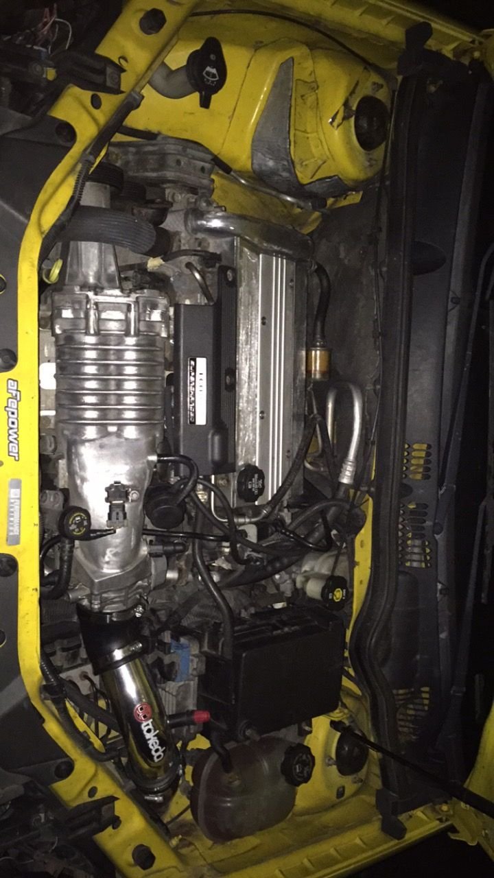

his tune of his stage 4 lsj was on a flash drive. plugged it into his laptop I did rolls from various speeds an cruised around out of boost Idk how or what he did to it but my car is seeing 16-18psi at wot, 15psi as low as 2500rpm. But 3.0 pulley an some dude that has built LSJs for quite a few people said my boost actuator solenoid is aftermarket an that I’m running Lucas 42# injectors which I didn’t even know about haha Idk everything about these engines but I use what I’m told by these guys
This my build that’s getting the last of the bolt ones this winter, until I go rouge an upgrade the internals

Pretty sure that’s a stock pulley. But either way something isn’t right. A tune doesn’t just increase boost

And that boost actuator is stock...

Measure your pulley. It looks stock like other people are saying. As others have also said you can't just turn up the boost on a supercharged car with a tune. The boost pressure is determined by how fast your supercharger is spinning which is dependent on your pulley ratios. The bypass mechanism on a supercharger is different than a turbo and is only activated with reduced throttle and when the ECU decides something is wrong. Otherwise, if you are at WOT, you are getting all the supercharger can put out.
If you are making anything close to 18psi with what looks like a stock pulley then you are either getting false readings or your exhaust is severely restricted.
