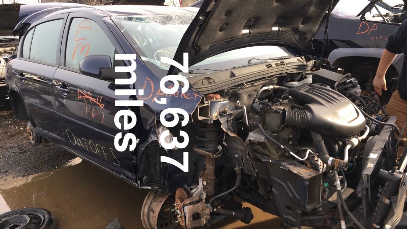

Now, before I even traded my truck for the jeep, I bought my Cobalt off of my best friend who got it as a part of a trade for one of his old jeeps. It was my don't give a **** about this car, gas saver (30 mpg avg compared to the trucks 10mpg downhill with a tail wind avg). I drove this car while I was finishing up college (just graduated Dec 2016) and drove it to work. It was my daily until the engine took a **** on me. I had to scramble to finish up a few things on the jeep, throw out bearing, rear shock mounts (yes, I was driving my jeep daily for about 3 weeks without any rear shocks... It sucked!) etc... and it became my daily.. butttt just the other week, I noticed my jeep was leaking oil like a siv..... ~5 qts ever 4 days, found that out the hard way and then out of the blue, the starter stopped working even though I had just replaced it (prob. bad reman part) so now I'm back to fixing the cobalt. I went salvage yard hunting for a new engine and didn't know anything about them except that it was a 2.2L. I figured, hell, as long as I get a 2.2, I'll be golden. Found a 2010 2.2L with only 79k miles on it that was in a roll over. Cylinders were locked up full of oil but after pulling the plugs and turning the engine over by hand dozens of times.. I'm pretty sure I got it all out.
While I was removing my engine, my brother pointed out to me that there were 2 sensors that were immediately noticeably different. That's when I found out that they changed models of engines from the L61 to the LAP with VVT. The sensors were for the intake and exhaust solenoid sensors. I did some research and found that to make this work, I would need to change the ECM and wire harness and that should be all. Doesn't sound too bad. I found out that the ECM from my 2007 is supposedly the same P/N that's in the 2010's so all I really have to do is find a VIN for a '10 2.2L LAP MANUAL and reflash the ECM. I also found out that the wire harness that I need is also the exact same one from basically any 2.4L '07-'10 or any '09-'10 2.2L. Then I found this gem which is the whole reason I felt the need to join this forum.

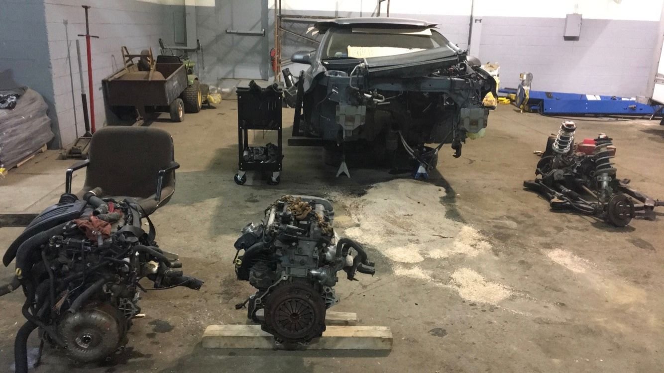

The point I'm at now is I have the old engine out.
I decided to take the route of removing it from the bottom so everything is out right now. I'm still doing a little more research as far as what accessories are compatible and what all needs to be done to make this happen. Here is a list of what I THINK I need to do to finish this little project off and get my daily back:
1: Either rewire the harness to incorporate the 3 additional sensors or purchase a harness from a salvage yard.
2. convert the back of the '10 LAP to be compatible with my 5 speed trans as the '10 was an automatic.
3. find a vin for a '10 2.2 5 speed to be able to flash the ECM
4. put it back together and go
I know it's now going to be this easy and I think I'm leaving some things out.
