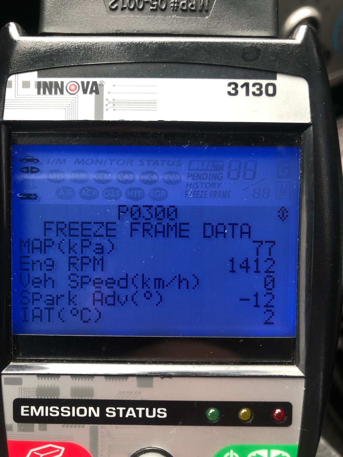

I do have an issue with my cobalt though, I got random misfire between cylinders 2 3 4, but only happens on cold starts, otherwise it drives perfect no issues,
these are the freeze frame data
I have the k and n intake and Injen charge pipe and only have 49,000km I’ve done the CRC valve intake cleaner through the brake booster vac line, changing the spark plugs today hoping it’s going to fix my issue but when I took them out and swapped them around they looked normal I also switched around the coils, P0300 P0302 P0303, and pending P0300 P0302 P0303 P0304, this is the first time I’m using my cobalt in the cold
