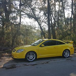

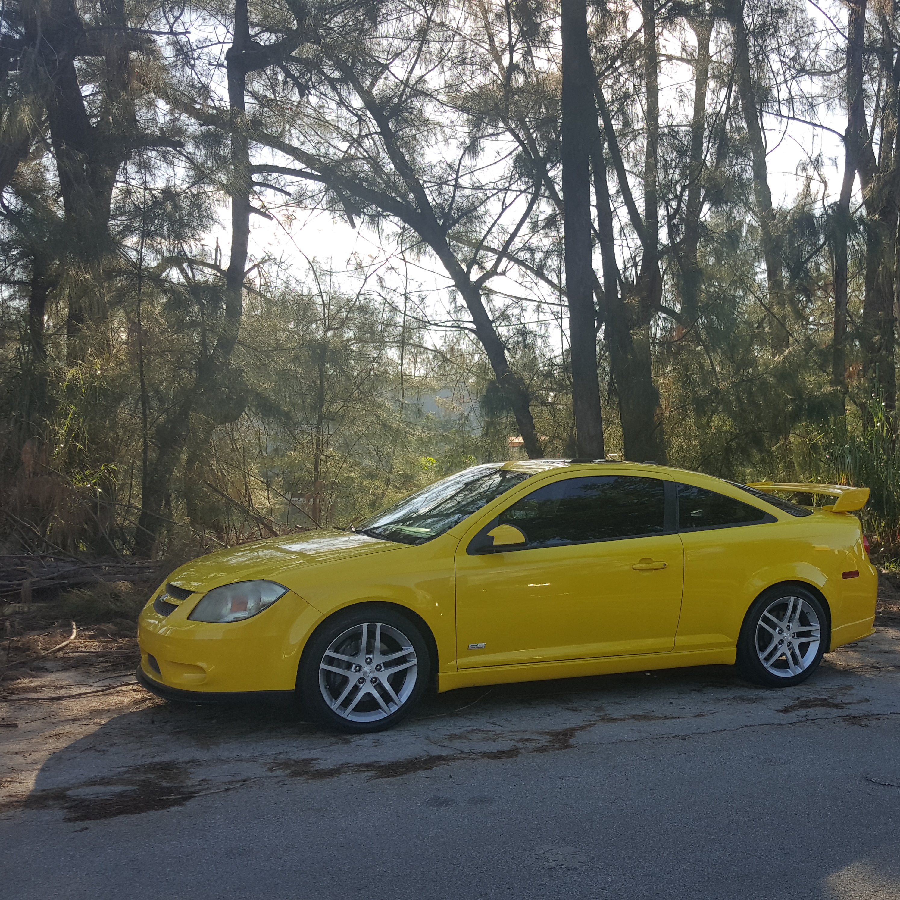

My name is Erick and I recently had the pleasure of owning my first TC SS. It is my second Cobalt, I bought the car at 58k miles, but it has a few issues here and there. I was hoping maybe someone had any advice for me since all I know up to now are NA cars. The speedometer doesnt track the speed, cruise control doesnt work, the plastic pcv in the line into the intake is broken due to an aftermarket intake pipe, the coolant temperature sensor doesn't work, and it seems the guy also replaced the cam sprockets on the vehicle. As of now car peaks at 25 lbs. I appreciate any help you lnf wizards have to offer
