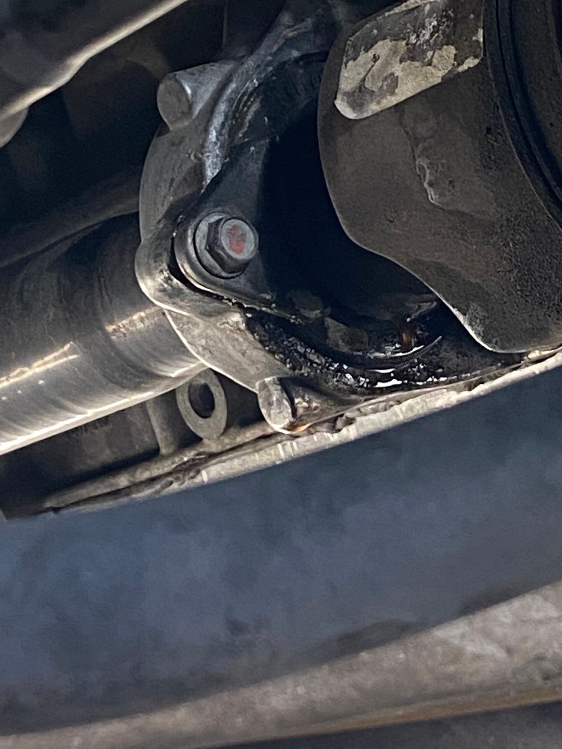

I need some help with my 06 ss that won’t start
I recently had the radiator installed after my old one cracked but soon after that my car wouldn’t start. Idk if it’s because of the battery, starter, alternator, or fuel pump. When I go to start the car there’s no crank however all the lights do turn on. Coolant is leaking from right here idk what part is that and/or if it’s the reason it won’t start.

Coolant isn't leaking from there, as that part does not have coolant flowing through it. You leak is most likely higher up on the water pump.
Sounds like a dead battery, dead starter, or someone removed some parts during the install and forgot to reconnect them, or reconnected them to the incorrect points.
100% right. Check those things, it helps to use a good flashlight!
